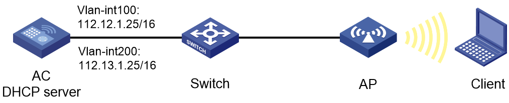

Example: Configuring local MAC authentication for wireless clients
As shown in Figure 1:
· The AC centrally forwards the client traffic.
· The AC acts as a DHCP server to provide IP addresses for the AP and the client.
Configure the AC to perform local MAC authentication to control the network access of the client. The MAC address of the client is used as the username and password for authentication. The MAC address is in hexadecimal notation without hyphens, and letters are in lower case.

service-template 1
wlan ap officeap model WA6320
serial-id 219801A28N819CE0002T
· Switch:
vlan 1
vlan 100
vlan 200
port link-type trunk
undo port trunk permit vlan 1
port trunk permit vlan 100
port access vlan 100
poe enable
