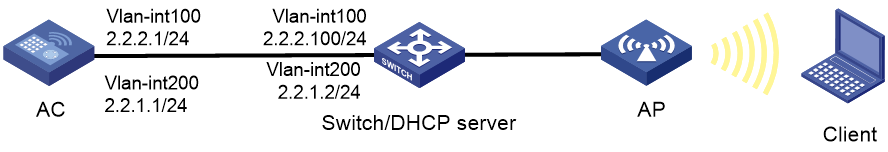

Example: Configuring local MAC-and-802.1X authentication for wireless clients
As shown in Figure 1, an AP is attached to a PoE port on a switch, which acts as a DHCP server to assign IP addresses to the AP and the client.
Configure the AC to meet the following requirements:

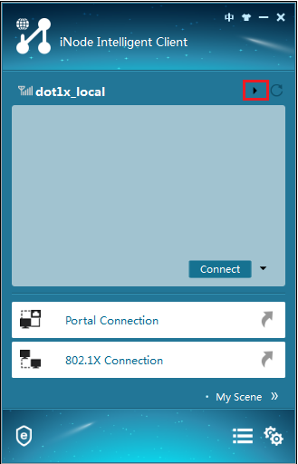

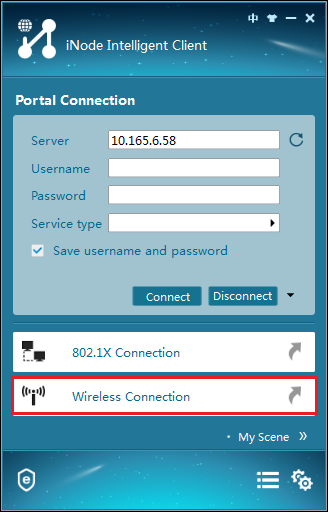

Configuring the iNode client
1. Run the iNode client and click Wireless Connection, as shown in Figure 2. In this example, the client version is iNode PC 7.1.
2. Click the inverted triangle icon at the upper right corner of the page, as shown in Figure 3.

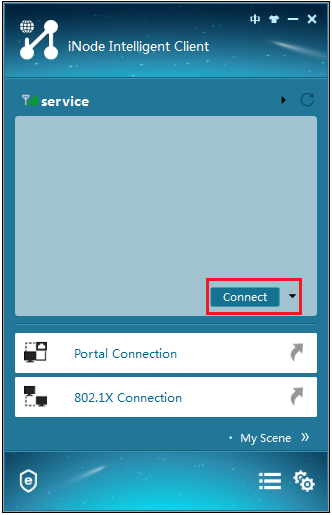

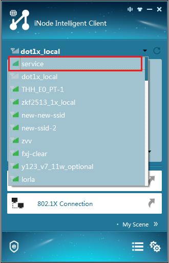

3. Double-click the wireless service with the SSID of service, as shown in Figure 4.
Figure 4 Selecting an wireless service

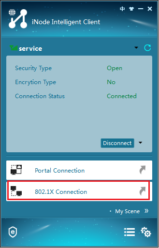

4. Click Connect as shown in Figure 5.
Figure 5 Connecting to the wireless network

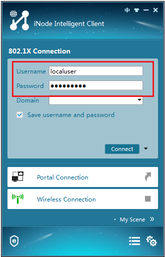

5. Click 802.1X Connection as shown in Figure 6.

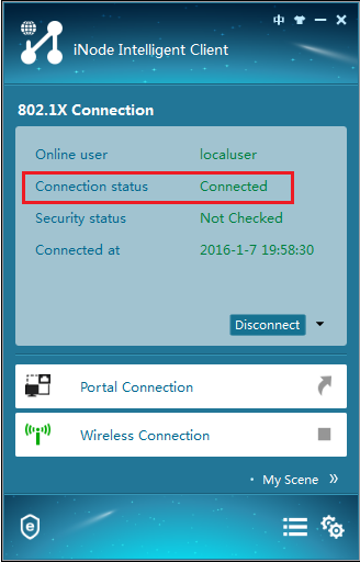

6. Enter a username and password as shown in Figure 7. In this example, the username is localuser and the password is localpass.
Figure 7 Entering the username and password
7. Click the inverted triangle icon next to Connect and select Properties.
8. In the dialog box that opens, select a wireless NIC to use and clear the option for uploading the client version information.
9. Return to the iNode 802.1X connection page.
10. Click Connect.
The iNode client displays the connection state as shown in Figure 8.
Figure 8 Successful 802.1X authentication
# Use a client with a MAC address other than 3ca9f4144c20 to visit the Internet. Verify the following items:
· The client cannot pass MAC authentication.
· The AC does not perform 802.1X authentication for the client after the client fails MAC authentication.
· The client cannot visit the Internet.
# Use the client with MAC address 3ca9f4144c20 to visit the Internet. Verify that the client can access the Internet after it passes both MAC authentication and 802.1X authentication. (Details not shown.)
# On the AC, display online 802.1X user information to verify that the 802.1X user has come online.
