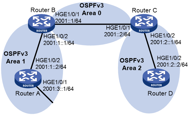

Example: Configuring OSPFv3 stub area
As shown in Figure 5:
·     Enable OSPFv3 on all routers.
·     Split the AS into three areas.
·     Configure Router B and Router C as ABRs to forward routing information between areas.
·     Configure Area 2 as a stub area to reduce LSAs in the area without affecting route reachability.
Figure 5 Network diagram

3.     Configure Area 2 as a stub area:
# Configure Router D.
[RouterD] ospfv3
[RouterD-ospfv3-1] area 2
[RouterD-ospfv3-1-area-0.0.0.2] stub
[RouterD-ospfv3-1-area-0.0.0.2] quit
[RouterD-ospfv3-1] quit
# Configure Router C, and specify the cost of the default route sent to the stub area as 10.
[RouterC] ospfv3
[RouterC-ospfv3-1] area 2
[RouterC-ospfv3-1-area-0.0.0.2] stub
[RouterC-ospfv3-1-area-0.0.0.2] default-cost 10
# Display OSPFv3 routing table on Router D.
[RouterD] display ospfv3 routing
               OSPFv3 Process 1 with Router ID 4.4.4.4
 I  - Intra area route,  E1 - Type 1 external route,  N1 - Type 1 NSSA route
 IA - Inter area route,  E2 - Type 2 external route,  N2 - Type 2 NSSA route
 *  - Selected route
*Destination: ::/0
  Type       : IA                        Area       : 0.0.0.2
  AdvRouter  : 3.3.3.3                   Preference : 10
  NibID      : 0x23000003                Cost       : 11
  Interface  : HGE1/0/2                  BkInterface: N/A
  Nexthop    : FE80::48C0:26FF:FEDA:305
  BkNexthop  : N/A
  Status     : Rely
 *Destination: 2001::/64
  NibID      : 0x23000003                Cost       : 2
  BkNexthop  : N/A
  Status     : Rely
 *Destination: 2001:1::/64
  NibID      : 0x23000003                Cost       : 3
  BkNexthop  : N/A
  Status     : Rely
 *Destination: 2001:2::/64
  Type       : I                         Area       : 0.0.0.2
  AdvRouter  : 4.4.4.4                   Preference : 10
  NibID      : 0x23000001                Cost       : 1
  Nexthop    : ::
  BkNexthop  : N/A
  Status     : Direct
 *Destination: 2001:3::1/128
  BkNexthop  : N/A
  Status     : Rely
 Total: 5
 Intra area: 1         Inter area: 4         ASE: 0         NSSA: 0
The output shows that a default route is added and its cost is the cost of a direct route plus the configured cost.
4.     Configure Area 2 as a totally stub area to further reduce the stub area routing table size:
# Configure Area 2 as a totally stub area on Router C.
[RouterC-ospfv3-1-area-0.0.0.2] stub no-summary
 *  - Selected route
*Destination: ::/0
  BkNexthop  : N/A
  Status     : Rely
  Nexthop    : ::
  BkNexthop  : N/A
  Status     : Direct
 Total: 2
 Intra area: 1         Inter area: 1         ASE: 0         NSSA: 0
The output shows that route entries are reduced. All indirect routes are removed, except the default route.

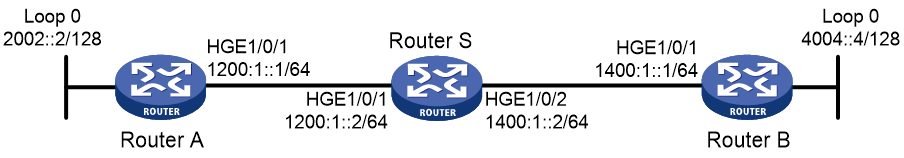

Example: Configuring OSPFv3 NSSA area
As shown in Figure 6:
·     Configure OSPFv3 on all routers and split the AS into three areas.
·     Configure Area 1 as an NSSA area and configure Router A as an ASBR to redistribute static routes into the AS.
Figure 6 Network diagram
1.     Configure IPv6 addresses for interfaces. (Details not shown.)
2.     Configure basic OSPFv3 (see "Example: Configuring OSPFv3 stub area").
3.     Configure Area 1 as an NSSA area:
# Configure Router A.
<RouterA> system-view
[RouterA] ospfv3
[RouterA-ospfv3-1] area 1
[RouterA-ospfv3-1-area-0.0.0.1] nssa
[RouterA-ospfv3-1-area-0.0.0.1] quit
[RouterA-ospfv3-1] quit
# Configure Router B.
<RouterB> system-view
[RouterB] ospfv3
[RouterB-ospfv3-1] area 1
[RouterB-ospfv3-1-area-0.0.0.1] nssa
[RouterB-ospfv3-1-area-0.0.0.1] quit
[RouterB-ospfv3-1] quit
# Display OSPFv3 routing information on Router D.
[RouterD] display ospfv3 1 routing
 *  - Selected route
  BkNexthop  : N/A
  Status     : Rely
  BkNexthop  : N/A
  Status     : Rely
  Nexthop    : ::
  BkNexthop  : N/A
  Status     : Direct
 *Destination: 2001:3::/64
  NibID      : 0x23000003                Cost       : 4
  BkNexthop  : N/A
  Status     : Rely
 Total: 4
 Intra area: 1         Inter area: 3         ASE: 0         NSSA: 0
4.     Configure route redistribution:
# Configure an IPv6 static route, and configure OSPFv3 to redistribute the static route on Router A.
[RouterA] ipv6 route-static 1234:: 64 null 0
[RouterA] ospfv3 1
[RouterA-ospfv3-1] import-route static
 *  - Selected route
  NibID      : 0x23000002                Cost       : 2
  BkNexthop  : N/A
  Status     : Rely
  NibID      : 0x23000002                Cost       : 3
  BkNexthop  : N/A
  Status     : Rely
  NibID      : 0x23000004                Cost       : 1
  Nexthop    : ::
  BkNexthop  : N/A
  Status     : Direct
  NibID      : 0x23000002                Cost       : 4
  BkNexthop  : N/A
  Status     : Rely
 *Destination: 1234::/64
  Type       : E2                        Tag        : 1
  AdvRouter  : 2.2.2.2                   Preference : 150
  BkNexthop  : N/A
  Status     : Normal
 Total: 5
 Intra area: 1         Inter area: 3         ASE: 1         NSSA: 0
The output shows an AS external route imported from the NSSA area exists on Router D.

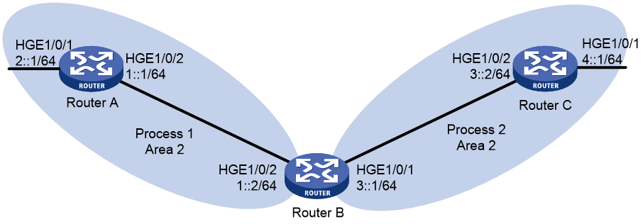

Example: Configuring OSPFv3 route redistribution
As shown in Figure 8:
·     Router A, Router B, and Router C are in Area 2.
·     OSPFv3 process 1 and OSPFv3 process 2 run on Router B. Router B communicates with Router A and Router C through OSPFv3 process 1 and OSPFv3 process 2.
·     Configure OSPFv3 process 2 to redistribute direct routes and the routes from OSPFv3 process 1 on Router B, and set the metric for redistributed routes to 3. Router C can then learn the routes destined for 1::0/64 and 2::0/64, and Router A cannot learn the routes destined for 3::0/64 or 4::0/64.
Figure 8 Network diagram
2.     Configure basic OSPFv3:
# Enable OSPFv3 process 1 on Router A.
[RouterA] ospfv3 1
[RouterA-ospfv3-1] router-id 1.1.1.1

# Enable OSPFv3 process 1 and OSPFv3 process 2 on Router B.
[RouterB] ospfv3 1
[RouterB-ospfv3-1] router-id 2.2.2.2
[RouterB] interface hundredgige 1/0/2
[RouterB-HundredGigE1/0/2] ospfv3 1 area 2
[RouterB-HundredGigE1/0/2] quit
[RouterB] ospfv3 2
[RouterB-ospfv3-2] router-id 3.3.3.3
[RouterB-ospfv3-2] quit
[RouterB] interface hundredgige 1/0/1
[RouterB-HundredGigE1/0/1] ospfv3 2 area 2
[RouterB-HundredGigE1/0/1] quit
# Enable OSPFv3 process 2 on Router C.
<RouterC> system-view
[RouterC] ospfv3 2
[RouterC-ospfv3-2] router-id 4.4.4.4
[RouterC-ospfv3-2] quit
[RouterC] interface hundredgige 1/0/2
[RouterC-HundredGigE1/0/2] ospfv3 2 area 2
[RouterC-HundredGigE1/0/2] quit
[RouterC] interface hundredgige 1/0/1
[RouterC-HundredGigE1/0/1] ospfv3 2 area 2
[RouterC-HundredGigE1/0/1] quit

3.     Configure OSPFv3 route redistribution:
# Configure OSPFv3 process 2 to redistribute direct routes and the routes from OSPFv3 process 1 on Router B, and set the metric for redistributed routes to 3.
[RouterB] ospfv3 2
[RouterB-ospfv3-2] import-route ospfv3 1 cost 3
[RouterB-ospfv3-2] import-route direct cost 3

Example: Configuring OSPFv3 route summarization
As shown in Figure 9:
·     OSPFv3 process 1 and OSPFv3 process 2 run on Router B. Router B communicates with Router A and Router C through OSPFv3 process 1 and OSPFv3 process 2, respectively.
·     On Router A, configure IPv6 addresses 2:1:1::1/64, 2:1:2::1/64, and 2:1:3::1/64 for HundredGigE 1/0/1.
·     On Router B, configure OSPFv3 process 2 to redistribute direct routes and the routes from OSPFv3 process 1. Router C can then learn the routes destined for 2::/64, 2:1:1::/64, 2:1:2::/64, and 2:1:3::/64.
·     On Router B, configure route summarization to advertise only summary route 2::/16 to Router C.

4.     Configure ASBR route summarization:
# On Router B, configure OSPFv3 process 2 to advertise a summary route 2::/16.
[RouterB] ospfv3 2
[RouterB-ospfv3-2] asbr-summary 2:: 16
# Display the routing table on Router C.
[RouterC] display ipv6 routing-table
Destinations : 9 Routes : 9
Destination: ::1/128                                     Protocol  : Direct
NextHop    : ::1                                         Preference: 0
Interface  : InLoop0                                     Cost      : 0
Destination: 1::/64                                      Protocol  : O_ASE2
NextHop    : FE80::200:CFF:FE01:1C03                     Preference: 150
Interface  : HGE1/0/2                                    Cost      : 1
Destination: 2::/16                                      Protocol  : O_ASE2
Destination: 3::/64                                      Protocol  : Direct
NextHop    : 3::2                                        Preference: 0
Interface  : HGE1/0/2                                    Cost      : 0
Destination: 3::2/128                                    Protocol  : Direct
Destination: 4::/64                                      Protocol  : Direct
NextHop    : 4::1                                        Preference: 0
Interface  : HGE1/0/1                                    Cost      : 0
Destination: 4::1/128                                    Protocol  : Direct
Destination: FE80::/10                                   Protocol  : Direct
NextHop    : ::                                          Preference: 0
Interface  : NULL0                                       Cost      : 0
Destination: FF00::/8                                    Protocol  : Direct
Example: Configuring OSPFv3 GR
As shown in Figure 10:
·     Router A, Router B, and Router C that reside in the same AS and the same OSPFv3 routing domain are GR capable.
·     Router A acts as the GR restarter. Router B and Router C act as GR helpers, and synchronize their LSDBs with Router A through GR.
Figure 10 Network diagram
# On Router A, enable OSPFv3 process 1, enable GR, and set the router ID to 1.1.1.1.
[RouterA] ospfv3 1
[RouterA-ospfv3-1] graceful-restart enable
[RouterA] interface hundredgige 1/0/1
[RouterA-HundredGigE1/0/1] ospfv3 1 area 1
[RouterA-HundredGigE1/0/1] quit
# On Router B, enable OSPFv3 and set the router ID to 2.2.2.2. (By default, GR helper is enabled on a router.)
[RouterB] ospfv3 1
[RouterB-HundredGigE1/0/1] ospfv3 1 area 1
# On Router C, enable OSPFv3 and set the router ID to 3.3.3.3. (By default, GR helper is enabled on a router.)
[RouterC] ospfv3 1
[RouterC-ospfv3-1] router-id 3.3.3.3
[RouterC-ospfv3-1] quit
[RouterC-HundredGigE1/0/1] ospfv3 1 area 1
# Perform an active/standby switchover on Router A to trigger an OSPFv3 GR operation. (Details not shown.)

# Display the route 10::1/128 on Router B to view the backup next hop information.
[RouterB] display ipv6 routing-table 10::1 128 verbose
Summary count : 1
Destination: 10::1/128
   Protocol: O_INTRA
 Process ID: 1
  SubProtID: 0x1                    Age: 00h03m10s
       Cost: 1               Preference: 10
      IpPre: N/A             QosLocalID: N/A
        Tag: 0                    State: Active Adv
  OrigTblID: 0x0                OrigVrf: default-vrf
    TableID: 0xa                 OrigAs: 0
      NibID: 0x23000006          LastAs: 0
     AttrID: 0xffffffff        Neighbor: ::
      Flags: 0x10041        OrigNextHop: FE80::34CC:E8FF:FE5B:C02
      Label: NULL           RealNextHop: FE80::34CC:E8FF:FE5B:C02
    BkLabel: NULL             BkNextHop: FE80::7685:45FF:FEAD:102
    SRLabel: NULL                Interface: HundredGigE1/0/2
   BkSRLabel: NULL              BkInterface: HundredGigE1/0/1
   Tunnel ID: Invalid           IPInterface: HundredGigE1/0/2
 BkTunnel ID: Invalid         BkIPInterface: HundredGigE1/0/1
     InLabel: NULL           ColorInterface: N/A
    SIDIndex: NULL         BkColorInterface: N/A
    FtnIndex: 0x0           TunnelInterface: N/A
TrafficIndex: N/A         BkTunnelInterface: N/A
   Connector: N/A                    PathID: 0x0
  SRTunnelID: Invalid
    SID Type: N/A                       NID: Invalid
    FlushNID: Invalid                 BkNID: Invalid
  BkFlushNID: Invalid             StatFlags: 0x0
         Exp: N/A
   VpnPeerId: N/A                      Dscp: N/A
         SID: N/A                OrigLinkID: 0x0
       BkSID: N/A                RealLinkID: 0x0
CommBlockLen: 0
