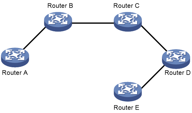

Figure 2 shows one IS-IS network topology. Area 1 is the backbone that comprises a set of Level-2 routers. The other four areas are non-backbone areas connected to the backbone through Level-1-2 routers.
Figure 2 IS-IS topology 1

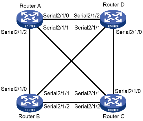

Figure 3 shows another IS-IS topology. No area is defined as the backbone in this topology. The backbone comprises all contiguous Level-2 and Level-1-2 routers in different areas. The IS-IS backbone does not need to be a specific area.
Figure 3 IS-IS topology 2
Both the Level-1 and Level-2 routers use the SPF algorithm to generate the shortest path tree.

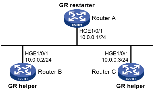

IS-IS routers on a broadcast network must elect a DIS.
The Level-1 and Level-2 DISs are elected separately. You can assign different priorities to a router for different level DIS elections. The higher the router priority, the more likely the router becomes the DIS. If multiple routers with the same highest DIS priority exist, the one with the highest Subnetwork Point of Attachment (SNPA) address will be elected. On a broadcast network, the SNPA address is the MAC address. A router can be the DIS for different levels.
IS-IS DIS election differs from OSPF DIS election in the following ways:
·     A router with priority 0 can also participate in the DIS election.
·     When a router with a higher priority is added to the network, an LSP flooding process is performed to elect the router as the new DIS.

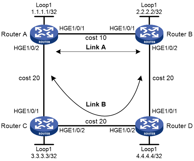

As shown in Figure 4, the same level routers on a network, including non-DIS routers, establish adjacency with each other.
Figure 4 DIS in the IS-IS broadcast network

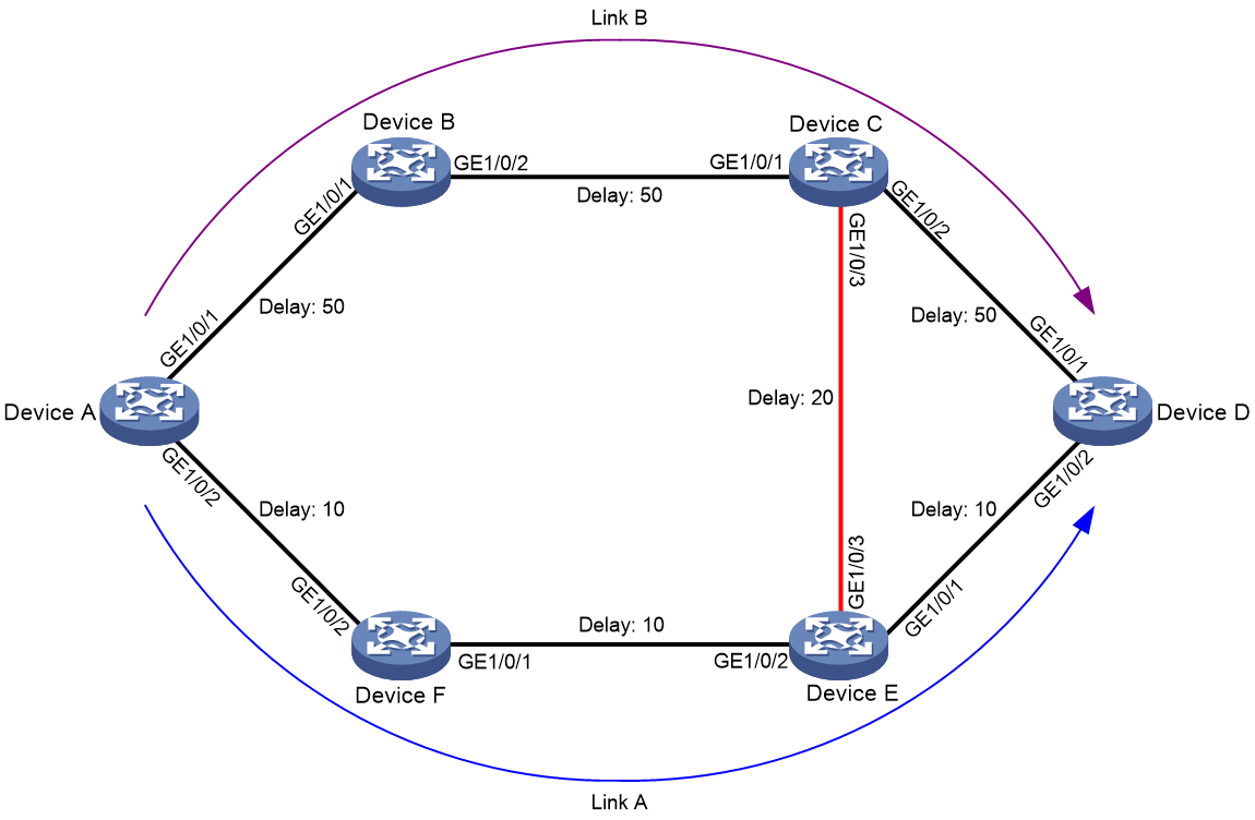

Flexible algorithm topology
The flexible algorithm topology is the scope of path calculation. It consists of links selected by the flexible algorithm based on the link constraints. The flexible algorithm excludes a node or a link from the topology in one of the following scenarios:
·     The node is not configured with the flexible algorithm.
·     The link meets one of the following requirements:
¡     An exclude-any constraint exists in the FAD and the link has an affinity that is included in the constraint.
¡     An include-any constraint exists in the FAD and the link does not have any affinity that is included in the constraint.
¡     An include-all constraint exists in the FAD and the link does not have all the affinities that are included in the constraint.
¡     The metric type in the FAD is not IS-IS link cost and the link does not advertise the cost of the metric type.

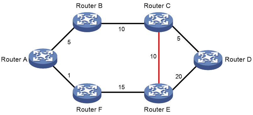

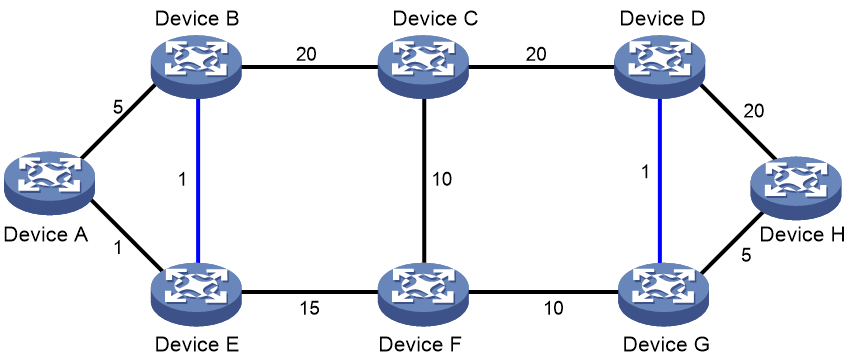

As shown in Figure 8, when no flexible algorithm is configured, all nodes calculate optimal paths based on the cost assigned to the links.
Figure 8 Topology without flexible algorithm 130

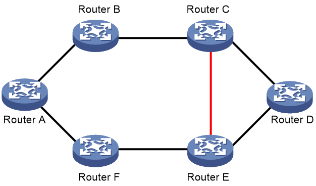

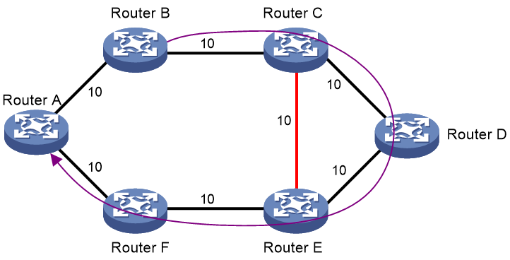

For comparison, you can configure flexible algorithm 130 for all nodes except Router F. The FAD of flexible algorithm 130 is as follows:
·     Calculation type—SPF algorithm.
·     Metric type—IS-IS link cost.
·     Constraint—Exclude affinity attribute red.
In the new topology shown in Figure 9, all nodes calculate optimal paths based on the calculation type and metric type in the FAD.
Figure 9 Topology with flexible algorithm 130

Mapping an affinity attribute name to an affinity bit
IS-IS supports a maximum of 256 affinity bits. They are numbered from 0 to 255. You can perform this task to map different affinity attribute names to these bits. As shown in Figure 10, affinity attribute name blue is mapped to bit 1, and red to bit 5.
This feature enables you to configure affinity attributes for links or define the flexible algorithm topology by specifying only the affinity attribute names.
Figure 10 Mapping an affinity attribute name to an affinity bit

Configuring flexible algorithm FRR
The flexible algorithm FRR is similar to IS-IS LFA FRR, because it uses LFA to calculate a loop-free backup path with the lowest cost based on the topology.
For illustration, flexible algorithm 130 is configured for all nodes in Figure 11. The FAD of flexible algorithm 130 is as follows:
Figure 11 Topology without flexible algorithm 130
In Figure 12, after you enable FRR, flexible algorithm 130 uses LFA to calculate a primary path and a backup path from Router A to Router D.
Figure 12 Topology with flexible algorithm 130
2.     Enter IS-IS view.
isis [ process-id ] [ vpn-instance vpn-instance-name ]
3.     Enter flexible algorithm view.
flex-algo flex-algo-id
4.     Enable flexible algorithm FRR.
fast-reroute enable
By default, flexible algorithm FRR is enabled.
If no backup paths exist in the topology, execute the undo fast-reroute enable command to disable flexible algorithm FRR to save device resources.

TI-LFA FRR path calculation
TI-LFA FRR uses the common algorithm to calculate backup paths for a flexible algorithm. The only difference is that TI-LFA FRR calculates backup paths for a flexible algorithm according to the FAD and topology of that flexible algorithm.
As shown in Figure 13, Router B is the source node and Router A is the destination node.
The number on each link represents the link cost. A data flow traverses from Router B to Router A. To avoid traffic loss against Router B failure, TI-LFA FRR calculates the backup path: Router B > Router C > Router E > Router F > Router A.
Figure 13 TI-LFA FRR backup path calculation without a flexible algorithm

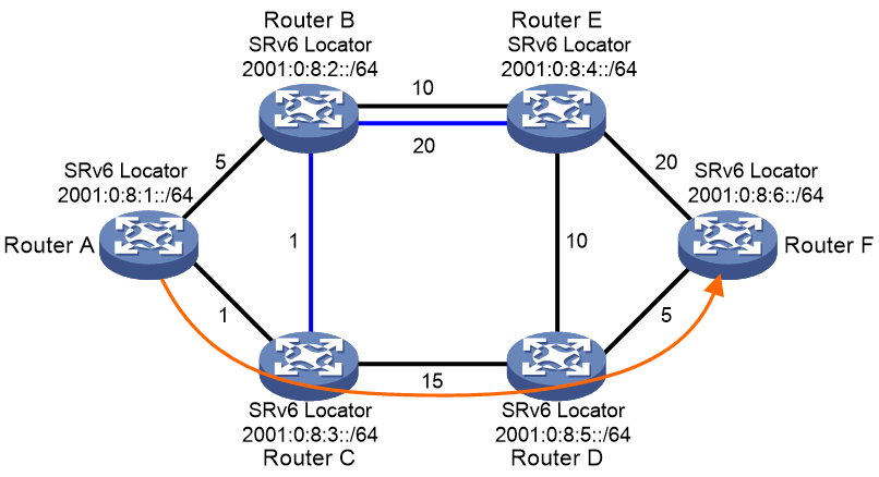

As shown in Figure 14, flexible algorithm 130 is configured for each node. The FAD of flexible algorithm 130 is as follows:
In this case, the backup path calculated by TI-LFA FRR is Router B > Router C > Router D > Router E > Router F > Router A.
Figure 14 TI-LFA FRR backup path calculation with a flexible algorithm

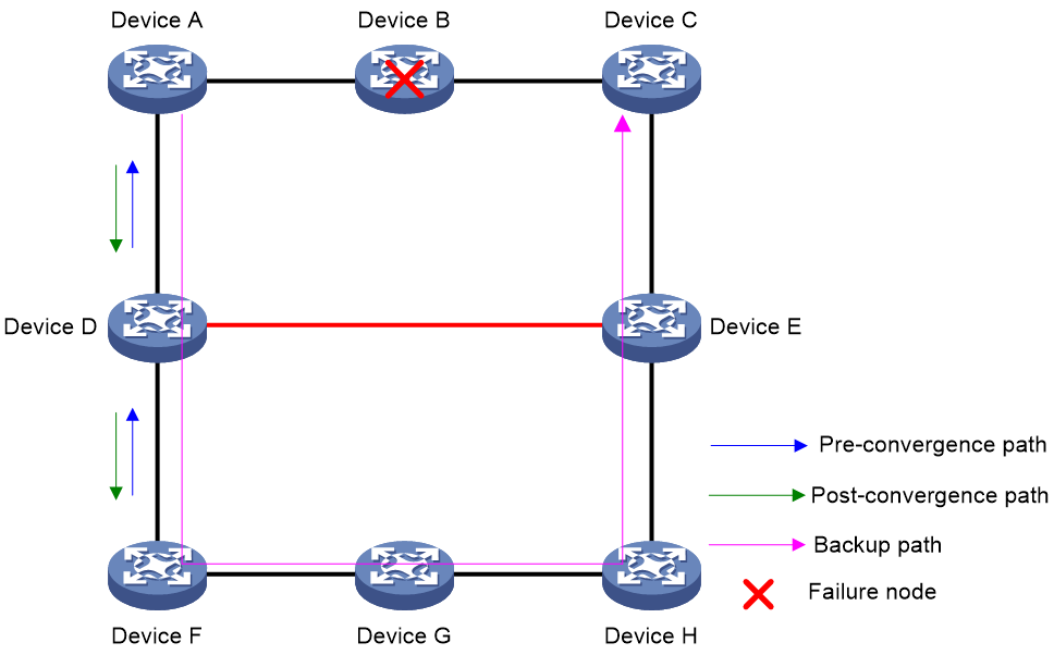

FRR microloop avoidance for a flexible algorithm
When a link or node fails, TI-LFA FRR switches the traffic to the backup path to ensure continuous data forwarding. During the route convergence process, microloops might occur and cause packet loss and disorder if the route convergence on each device is not simultaneous.
As shown in Figure 15, flexible algorithm 128 is configured for all nodes on the network and TI-LFA is enabled for that flexible algorithm. The FAD of flexible algorithm 128 is as follows:
·     Metric type—IS-IS link cost. The link cost of each link in Figure 15 is 10.
If no node failures occur, Device A forwards traffic to Device C along the path: Device A > Device B > Device C. If Device B fails, traffic to Device C will be switched to the backup path calculated by TI-LFA. After Device A finishes route convergence, traffic to Device C will be forwarded along the post-convergence path. If Device D has not finished route convergence and still forward traffic along the pre-convergence path, a loop is formed between Device A and Device D. The loop exists until Device D finishes route convergence.
Figure 15 TI-LFA FRR microloop avoidance after a node failed
FRR microloop avoidance can resolve this issue. After you enable this feature for Device A, Device A first switches traffic to the backup path calculated by TI-LFA when Device B fails. Device A does not start route convergence unless Device D and Device F finish route convergence. After Device A also finishes route convergence, Device A switches the traffic to the post-convergence route.

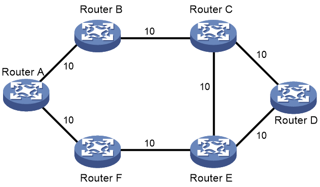

Set the priority of an FRR backup path selection policy
IS-IS flexible algorithm FRR selects a backup path based on the following policies:
·     Node-protection policy—Selects the path that involves a specific node.
·     Lowest-cost policy—Selects the path that has the lowest cost.
As shown in Figure 16, flexible algorithm 128 is configured for all nodes on the network. The FAD of flexible algorithm 128 is as follows:
·     Constraint—Exclude affinity attribute blue.
Traffic forwarding path Device A->Device E->Device F->Device G->Device H has three backup paths. You can set the priority of each backup path selection policy as follows to control backup path selection:
·     To select path Device A->Device E->Device F->Device C->Device D ->Device H that involves Device E, set a higher priority for the node-protection policy than the lowest-cost policy.
·     To select path Device A->Device B->Device C->Device F->Device G ->Device H that has the lowest cost, set a higher priority for the lowest-cost policy than the node-protection policy.
Figure 16 IS-IS FRR backup path selection
If the node-protection policy has a higher priority but the backup path calculation fails, IS-IS uses the lowest-cost policy for further calculation. If the backup path calculation still fails, IS-IS does not perform further backup path calculation.
If the lowest-cost policy has a higher priority but the backup path calculation fails, IS-IS does not perform further backup path calculation.

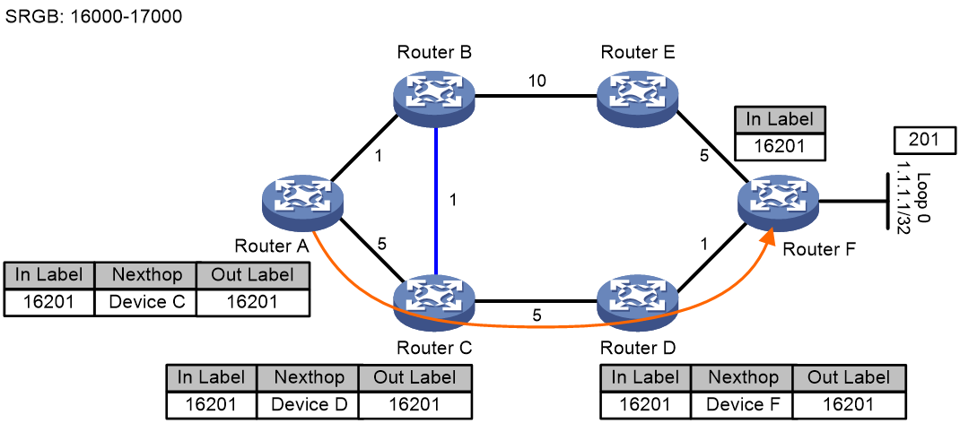

Applying a flexible algorithm to SR-MPLS
IS-IS advertises a prefix SID together with the algorithm ID associated to that prefix SID. By default, the algorithm ID associated to a prefix SID is 0. In this case, IS-IS uses the SPF algorithm and IS-IS link cost to calculate the optimal path to the prefix of that prefix SID.
After you associate a prefix SID to a flexible algorithm, IS-IS uses the flexible algorithm to calculate the optimal path to the prefix of that prefix SID. For example, you can associate the prefix SID configure on the loopback interface of Router F to flexible algorithm 130. The FAD of flexible algorithm 130 is as follows:
SID index value 201 is assigned to loopback address 1.1.1.1/32 on Router F. The incoming label calculated by Router F is 16201. After using flexible algorithm 130 to calculate the optimal path to 1.1.1.1/32, Router A creates a label forwarding entry. The incoming label is 16201, the outgoing label is 16201, and the next hop is Router C. Figure 17 shows the established SRLSP from Router A to Router F.
Figure 17 SRLSP from Router A to Router F with flexible algorithm 130

Applying a flexible algorithm to SRv6
With SRv6 enabled, IS-IS advertises SRv6 locator TLVs in LSPs. You can identify the algorithm associated to the locator by checking the algorithm field in an SRv6 locator TLV. By default, IS-IS uses the SPF algorithm to calculate the shortest path to an SRv6 locator, and the value for the algorithm field is 0.
If you associate an SRv6 locator to a flexible algorithm, IS-IS uses the flexible algorithm to calculate the shortest path to the locator. For example, you can associate the SRv6 locators in Figure 18 to flexible algorithm 130. The FAD of flexible algorithm 130 is as follows:
As shown in Figure 18, Router A uses the SPF algorithm to calculate the optimal path to locator 2001:0:8:6::/64 based on the topology of flexible algorithm 130.
Figure 18 Optimal path calculated by flexible algorithm 130

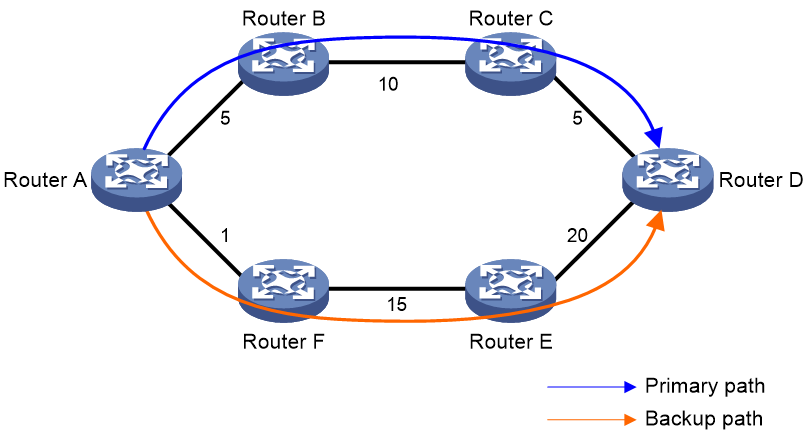

As shown in Figure 19, Device A needs to communicate with Device B, Device C, and Device D. For security purposes, other devices in areas 2, 3, and 5 should not receive the packets sent by Device A. To resolve this issue, perform the following task:
1.     Configure the same administrative tag value for the IS-IS interfaces on Device B, Device C, and Device D.
2.     Configure route leaking from Level-2 to Level-1 on the Level-1-2 device in Area 4 and specify the same tag value as the route filter.
As shown in Figure 20, the IS-IS network topology on Device A is updated after you perform the above task.
Figure 19 IS-IS network diagram without the administrative tag
Figure 20 IS-IS network diagram with the administrative tag

As shown in Figure 21, both Device A and Device B support LSP fragment extension. With LSP fragment extension enabled, Device A advertises some route information in the LSPs generated by Device A1 and Device A2. On receipt of these LSPs, Device B reads the IS Alias ID TLVs and determines that Device A is the originating system. The route information received from Device A1 and Device A2 is actually generated by Device A. In this situation, virtual systems do not participate in route calculation.
Figure 21 IS-IS LSP fragment extension

In NBMA networks such as ATM and FR, many P2P links exist. As shown in Figure 22, Routers A, B, C and D run IS-IS. When Router A generates an LSP, it floods the LSP out of Serial2/1/0, Serial2/1/1, and Serial2/1/2. After Router D receives the LSP from Serial2/1/2, it floods it out of Serial2/1/0 and Serial2/1/1 to Router B and Router C. However, Router B and Router C have already received the LSP from Router A. Repeated LSP flooding consumes extra bandwidth.
Figure 22 Network diagram of a fully meshed network

As shown in Figure 23, the path from Device A to the IP network should be Device A > Device D > Device E > IP network. After you set the overload bit in the LSPs sent by Device D, the path from Device A to the IP network becomes Device A > Device B > Device C > Device E > IP network. If the packets from Device A are destined for Device D's directly-connected networks, the forwarding path does not change.
Figure 23 Overload bit

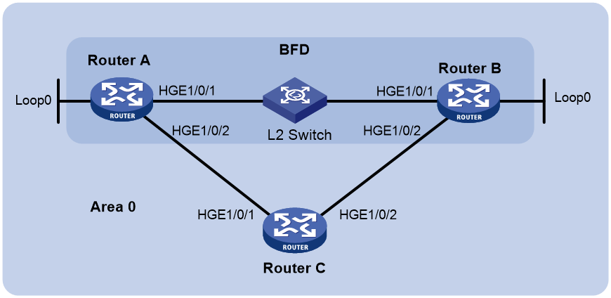

Enabling BFD control packet mode for IS-IS PIC
2.     Enter interface view.
3.     Enable BFD control packet mode for IS-IS PIC.
isis primary-path-detect bfd ctrl
By default, BFD control packet mode is disabled for IS-IS PIC.
To use BFD (control packet mode) to detect primary link failures, you must enable BFD control packet mode on both ends of the link.
Enabling BFD echo packet mode for IS-IS PIC
2.     (Optional.) Configure the source IP address of BFD echo packets.
bfd echo-source-ip ip-address
By default, the source IP address of BFD echo packets is not configured.
To avoid network congestion caused by a large number of ICMP redirect packets from neighbors, use this command. The source IP address cannot be on the same network segment as any local interface's IP address.
For more information, see High Availability Command Reference.
3.     Enter interface view.
4.     Enable BFD echo packet mode for IS-IS PIC.
isis primary-path-detect bfd echo
By default, BFD echo packet mode is disabled for IS-IS PIC.
To use BFD (echo packet mode) to detect primary link failures, you only need to enable BFD echo packet mode on one end of the link.

A link or router failure on a path can cause packet loss. IS-IS LFA FRR enables fast rerouting to minimize the failover time.
Figure 24 Network diagram for IS-IS LFA FRR
In Figure 24, after you enable LFA FRR on Router B, IS-IS automatically calculates or designates a backup next hop when a link failure is detected. In this way, packets are directed to the backup next hop to reduce traffic recovery time. Meanwhile, IS-IS calculates the shortest path based on the new network topology, and forwards packets over the path after network convergence.
When a primary link failure occurs, BFD can detect and report the link failure to IS-IS for a primary-backup path switchover. This can shorten the duration of service interruption.

In a ring topology where IS-IS LFA FRR cannot calculate the backup path, configure remote LFA FRR to ensure network reliability.
Remote LFA uses the following concepts:
·     P space—Use the source node of the protected link as the root to establish a shortest path tree. All nodes that are reachable from the source node without passing the protected link form the P space. Nodes in the P space are called P nodes.
·     Extended P space—Use the source node of the protected link and its neighbors as the roots to establish shortest path trees. All nodes that are reachable from the source node or one of its neighbors without passing the protected link form the extended P space. The P space is a subset of the extended P space.
·     Q space—Use the destination node of the protected link as the root to establish a reverse shortest path tree. All nodes that are reachable from the root node without passing the protected link form the Q space. Nodes in the Q space are called Q nodes.
·     PQ node—A PQ node refers to a node that resides in both the extended P space and the Q space. Remote LFA uses a PQ node as the destination node of a protected link.
As shown in Figure 25, the traffic forwarding path is PE 1—P 1—P 2—PE 2. To avoid traffic loss caused by link failures between P 1 and P 2, the system establishes an LDP tunnel between P 1 and P 4, which is the PQ node. When the link between P 1 and P 2 fails, P 1 encapsulates IP packets in MPLS packets and sends the MPLS packets to P 4 through the LDP tunnel. After receiving the MPLS packets, P 4 removes the MPLS labels of the packets and then forwards the packets to the next hop based on the IP routing table.
The system determines P 4 as the PQ node as follows:
1.     Uses P 1 (source node of the protected link) and its neighbors except P 2 (which passes the protected link) as the roots to establish shortest path trees.
2.     Finds out all nodes that are reachable from P 1 or one of its neighbors without passing the protected link, which are PE 1, P 1, P 3, and P 4.
These nodes form the extended P space.
3.     Uses P 2 (destination node of the protected link) as the root to establish a reverse shortest path tree.
4.     Finds out all nodes that are reachable from P 2 without passing the protected link, which are PE 2 and P 4.
These nodes form the Q space.
5.     Finds out all nodes that reside in both the extended P space and the Q space.
Only P 4 resides in both the extended P space and the Q space, so P 4 is the PQ node of the protected link.
Figure 25 Network diagram for IS-IS remote LFA FRR

Setting the priority for FRR backup path selection policies
IS-IS FRR uses specific policies for backup path calculation. The fast-reroute tiebreaker command defines the priority for the backup path selection policy. The higher the value, the higher the priority of the associated backup path selection policy. Changing the backup path selection policy priority can affect the backup path calculation result for IS-IS FRR. The backup paths can provide node protection or link protection for traffic, or provide both node protection and link protection.
IS-IS FRR supports the following backup path selection policies that are used to generate different topologies for backup path calculation:
·     Node protection—IS-IS FRR performs backup path calculation after excluding the primary next hop node.
·     Lowest cost—IS-IS FRR performs backup path calculation after excluding the direct primary link.
·     SRLG disjoint—When one link in the SRLG fails, the other links in the SRLG might also fail. If you use a link in this SRLG as the backup link for the faulty link, protection does not take effect. To avoid this issue, IS-IS FRR excludes the local links in the same SRLG as the direct primary link and then performs backup path calculation.
For IS-IS FRR, the SRLG disjoint policy depends on the node protection and lowest cost policies.
If multiple backup path selection policies exist in an IS-IS process, the policy with the highest priority is used to calculate the backup path. If the policy fails to calculate the backup path, another policy with higher priority is used. IS-IS performs backup path calculation by using the node protection and lowest cost policies as follows:
·     If the node protection policy has higher priority and fails to calculate the backup path, IS-IS uses the lowest cost policy to calculate the backup path. If the lowest cost policy still fails to calculate the backup path, reliability cannot be ensured upon primary link failure.
·     If the lowest cost policy has higher priority and fails to calculate the backup path, IS-IS does not perform further backup path calculation with the node protection policy. Reliability cannot be ensured upon primary link failure.
Table 4 shows the backup path selection mechanism for IS-IS FRR based on priorities of backup path selection policies.

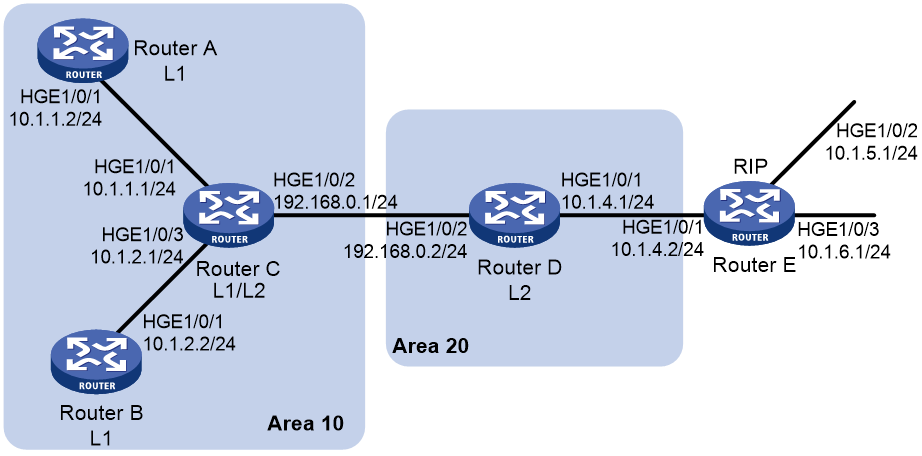

Example: Configuring basic IS-IS
As shown in Figure 26, Router A, Router B, Router C, and Router D reside in an AS.
Router A and Router B are Level-1 routers, Router D is a Level-2 router, and Router C is a Level-1-2 router connecting two areas. Router A, Router B, and Router C are in area 10, and Router D is in area 20.
Figure 26 Network diagram
1.     Configure IP addresses for interfaces. (Details not shown.)
2.     Configure IS-IS:
# Configure Router A
<RouterA> system-view
[RouterA] isis 1
[RouterA-isis-1] is-level level-1
[RouterA-isis-1] network-entity 10.0000.0000.0001.00
[RouterA-isis-1] quit
[RouterA] interface hundredgige 1/0/1
[RouterA-HundredGigE1/0/1] isis enable 1
[RouterA-HundredGigE1/0/1] quit
# Configure Router B.
<RouterB> system-view
[RouterB] isis 1
[RouterB-isis-1] is-level level-1
[RouterB-isis-1] network-entity 10.0000.0000.0002.00
[RouterB-isis-1] quit
[RouterB] interface hundredgige 1/0/1
[RouterB-HundredGigE1/0/1] isis enable 1
[RouterB-HundredGigE1/0/1] quit
# Configure Router C.
<RouterC> system-view
[RouterC] isis 1
[RouterC-isis-1] network-entity 10.0000.0000.0003.00

# Configure Router D
<RouterD> system-view
[RouterD] isis 1
[RouterD-isis-1] is-level level-2
[RouterD-isis-1] network-entity 20.0000.0000.0004.00
[RouterD-isis-1] quit
[RouterD] interface hundredgige 1/0/1
[RouterD-HundredGigE1/0/1] isis enable 1
[RouterD-HundredGigE1/0/1] quit
[RouterD] interface hundredgige 1/0/2
[RouterD-HundredGigE1/0/2] isis enable 1
[RouterD-HundredGigE1/0/2] quit
# Display the IS-IS LSDB information.
[RouterA] display isis lsdb
                        Database information for ISIS(1)
                          Level-1 Link State Database
LSPID                 Seq Num      Checksum      Holdtime      Length  ATT/P/OL
0000.0000.0001.00-00* 0x00000004   0xdf5e        1096          68      0/0/0
0000.0000.0002.00-00  0x00000004   0xee4d        1102          68      0/0/0
0000.0000.0002.01-00  0x00000001   0xdaaf        1102          55      0/0/0
0000.0000.0003.00-00  0x00000009   0xcaa3        1161          111     1/0/0
0000.0000.0003.01-00  0x00000001   0xadda        1112          55      0/0/0
    *-Self LSP, +-Self LSP(Extended), ATT-Attached, P-Partition, OL-Overload
[RouterB] display isis lsdb
0000.0000.0001.00-00  0x00000006   0xdb60        988           68      0/0/0
0000.0000.0002.00-00* 0x00000008   0xe651        1189          68      0/0/0
0000.0000.0002.01-00* 0x00000005   0xd2b3        1188          55      0/0/0
0000.0000.0003.00-00  0x00000014   0x194a        1190          111     1/0/0
0000.0000.0003.01-00  0x00000002   0xabdb        995           55      0/0/0
[RouterC] display isis lsdb
0000.0000.0001.00-00  0x00000006   0xdb60        847           68      0/0/0
0000.0000.0002.00-00  0x00000008   0xe651        1053          68      0/0/0
0000.0000.0002.01-00  0x00000005   0xd2b3        1052          55      0/0/0
0000.0000.0003.00-00* 0x00000014   0x194a        1051          111     1/0/0
0000.0000.0003.01-00* 0x00000002   0xabdb        854           55      0/0/0
                          Level-2 Link State Database
0000.0000.0003.00-00* 0x00000012   0xc93c        842           100     0/0/0
0000.0000.0004.00-00  0x00000026   0x331         1173          84      0/0/0
0000.0000.0004.01-00  0x00000001   0xee95        668           55      0/0/0
[RouterD] display isis lsdb
0000.0000.0003.00-00  0x00000013   0xc73d        1003          100     0/0/0
0000.0000.0004.00-00* 0x0000003c   0xd647        1194          84      0/0/0
0000.0000.0004.01-00* 0x00000002   0xec96        1007          55      0/0/0
# Display the IS-IS routing information on each router.
[RouterA] display isis route
                         Route information for IS-IS(1)
                         Level-1 IPv4 Forwarding Table
 IPv4 Destination     IntCost    ExtCost ExitInterface   NextHop         Flags
 10.1.1.0/24          10         NULL    HGE1/0/1        Direct          D/L/-
 10.1.2.0/24          20         NULL    HGE1/0/1        10.1.1.1        R/-/-
 192.168.0.0/24       20         NULL    HGE1/0/1        10.1.1.1        R/-/-
 0.0.0.0/0            10         NULL    HGE1/0/1        10.1.1.1        R/-/-
      Flags: D-Direct, R-Added to Rib, L-Advertised in LSPs, U-Up/Down Bit Set
[RouterC] display isis route
 10.1.2.0/24          10         NULL    HGE1/0/3        Direct          D/L/-
 192.168.0.0/24       10         NULL    HGE1/0/2        Direct          D/L/-
                         Level-2 IPv4 Forwarding Table
 10.1.1.0/24          10         NULL                                    D/L/-
 10.1.2.0/24          10         NULL                                    D/L/-
 192.168.0.0/24       10         NULL                                    D/L/-
 172.16.0.0/16        20         NULL    HGE1/0/2        192.168.0.2     R/-/-
[RouterD] display isis route
 10.1.1.0/24          20         NULL    HGE1/0/2        192.168.0.1     R/-/-
 10.1.2.0/24          20         NULL    HGE1/0/2        192.168.0.1     R/-/-
 172.16.0.0/16        10         NULL    HGE1/0/1        Direct          D/L/-
The output shows that the routing table of Level-1 routers contains a default route with the next hop as the Level-1-2 router. The routing table of Level-2 router contains all Level-1 and Level-2 routes.
Example: Configuring DIS election
As shown in Figure 27, on a broadcast network (Ethernet), Router A, Router B, Router C, and Router D reside in IS-IS Area 10. Router A and Router B are Level-1-2 routers, Router C is a Level-1 router, and Router D is a Level-2 router.
Change the DIS priority of Router A to make it elected as the Level-1-2 DIS router.
Figure 27 Network diagram
2.     Enable IS-IS:
# Configure Router A.
[RouterA] isis 1
[RouterB] isis 1
[RouterC] isis 1
[RouterC-isis-1] is-level level-1
[RouterC-isis-1] quit
[RouterC] interface hundredgige 1/0/1
[RouterC-HundredGigE1/0/1] isis enable 1
[RouterC-HundredGigE1/0/1] quit
# Configure Router D.
[RouterD] isis 1
[RouterD-isis-1] network-entity 10.0000.0000.0004.00
# Display information about IS-IS neighbors of Router A.
[RouterA] display isis peer
                          Peer information for IS-IS(1)
 System ID: 0000.0000.0002
 Interface: HGE1/0/1                Circuit Id:  0000.0000.0003.01
 State: Up     HoldTime: 21s        Type: L1(L1L2)     PRI: 64
 System ID: 0000.0000.0003
 State: Up     HoldTime: 6s         Type: L1           PRI: 64
 Interface: HGE1/0/1                Circuit Id:  0000.0000.0004.01
 State: Up     HoldTime: 23s        Type: L2(L1L2)     PRI: 64
 System ID: 0000.0000.0004
 State: Up     HoldTime: 23s        Type: L2           PRI: 64
# Display information about IS-IS interfaces of Router A.
[RouterA] display isis interface
                       Interface information for IS-IS(1)
  Interface:  HundredGigE1/0/1
  Index     IPv4 state      IPv6 state     Circuit ID   MTU   Type   DIS
  00001     Up              Down           1            1497  L1/L2  No/No
# Display IS-IS interfaces of Router C.
[RouterC] display isis interface
  00001     Up              Down           1            1497  L1/L2  Yes/No
# Display information about IS-IS interfaces of Router D.
[RouterD] display isis interface
  00001     Up              Down           1            1497  L1/L2  No/Yes

Example: Configuring IS-IS route redistribution
As shown in Figure 28, Router A, Router B, Router C, and Router D reside in the same AS. They use IS-IS to interconnect. Router A and Router B are Level-1 routers, Router D is a Level-2 router, and Router C is a Level-1-2 router.
Redistribute RIP routes into IS-IS on Router D.
Figure 28 Network diagram

[RouterC] interface hundredgige 1/0/3
[RouterC-HundredGigE1/0/3] isis enable 1
[RouterC-HundredGigE1/0/3] quit
[RouterD] isis 1
# Display IS-IS routing information on each router.
 10.1.4.0/24          10         NULL                                    D/L/-
 10.1.4.0/24          10         NULL    HGE1/0/1        Direct          D/L/-
3.     Configure RIPv2 on Router D and Router E, and configure IS-IS to redistribute RIP routes on Router D:
# Configure RIPv2 on Router D.
[RouterD] rip 1
[RouterD-rip-1] network 10.0.0.0
[RouterD-rip-1] version 2
[RouterD-rip-1] undo summary
# Configure RIPv2 on Router E.
[RouterE] rip 1
[RouterE-rip-1] network 10.0.0.0
[RouterE-rip-1] version 2
[RouterE-rip-1] undo summary
# On Router D, configure IS-IS to redistribute routes from RIP.
[RouterD-rip-1] quit
[RouterD] isis 1
[RouterD–isis-1] address-family ipv4
[RouterD–isis-1-ipv4] import-route rip level-2
# Display IS-IS routing information on Router C.
 10.1.4.0/24          20         NULL    HGE1/0/2        192.168.0.2     R/L/-
 10.1.5.0/24          10         0       HGE1/0/2        192.168.0.2     R/L/-
 10.1.6.0/24          10         0       HGE1/0/2        192.168.0.2     R/L/-

Example: Configuring BFD for IS-IS
·     As shown in Figure 32, run IS-IS on Router A, Router B and Router C so that they can reach each other at the network layer.
·     After the link over which Router A and Router B communicate through the Layer 2 switch fails, BFD can quickly detect the failure and notify IS-IS of the failure. Router A and Router B then communicate through Router C.
Figure 32 Network diagram
Table 5 Interface and IP address assignment
2.     Configure basic IS-IS:
[RouterA] isis
[RouterA] interface loopback 0
[RouterA-LoopBack0] isis enable
[RouterA-LoopBack0] quit
[RouterA] interface hundredgige 1/0/2
[RouterA-HundredGigE1/0/2] isis enable
[RouterA-HundredGigE1/0/2] quit
[RouterB] isis
[RouterB] interface loopback 0
[RouterB-LoopBack0] isis enable
[RouterB-LoopBack0] quit
[RouterB] interface hundredgige 1/0/2
[RouterB-HundredGigE1/0/2] isis enable
[RouterB-HundredGigE1/0/2] quit
[RouterC] isis
[RouterC] interface hundredgige 1/0/2
[RouterC-HundredGigE1/0/2] isis enable
[RouterC-HundredGigE1/0/2] quit
3.     Configure BFD functions:
# Enable BFD and configure BFD parameters on Router A.
[RouterA] bfd session init-mode active
[RouterA-HundredGigE1/0/1] isis bfd enable
[RouterA-HundredGigE1/0/1] bfd min-receive-interval 500
[RouterA-HundredGigE1/0/1] bfd min-transmit-interval 500
[RouterA-HundredGigE1/0/1] bfd detect-multiplier 7
# Enable BFD and configure BFD parameters on Router B.
[RouterB] bfd session init-mode active
[RouterB-HundredGigE1/0/1] isis bfd enable
[RouterB-HundredGigE1/0/1] bfd min-receive-interval 500
[RouterB-HundredGigE1/0/1] bfd min-transmit-interval 500
[RouterB-HundredGigE1/0/1] bfd detect-multiplier 8
# Display the BFD session information on Router A.
<RouterA> display bfd session
 Total sessions: 1     Up sessions: 1     Init mode: Active
 IPv4 session working in control mode:
LD/RD           SourceAddr      DestAddr        State  Running Up for Holdtime
   Interface
 3/1             192.168.0.102   192.168.0.100   Up     00:00:20       1700ms
   HGE1/0/1
# Display routes destined for 120.1.1.1/32 on Router A.
<RouterA> display ip routing-table 120.1.1.1 verbose
Summary count : 1
Destination: 120.1.1.1/32
    Protocol: IS_L1
  Process ID: 1
   SubProtID: 0x1                        Age: 04h20m37s
        Cost: 10                  Preference: 10
       IpPre: N/A                 QosLocalID: N/A
         Tag: 0                        State: Active Adv
   OrigTblID: 0x0                    OrigVrf: default-vrf
     TableID: 0x2                     OrigAs: 0
       NibID: 0x26000002              LastAs: 0
      AttrID: 0xffffffff            Neighbor: 0.0.0.0
       Flags: 0x1008c            OrigNextHop: 192.168.0.100
       Label: NULL               RealNextHop: 192.168.0.100
     BkLabel: NULL                 BkNextHop: N/A
     SRLabel: NULL                 Interface: HundredGigE1/0/1
   BkSRLabel: NULL              BkInterface: N/A
   Tunnel ID: Invalid           IPInterface: HundredGigE1/0/1
 BkTunnel ID: Invalid         BkIPInterface: N/A
     InLabel: NULL           ColorInterface: N/A
    SIDIndex: NULL         BkColorInterface: N/A
    FtnIndex: 0x0           TunnelInterface: N/A
TrafficIndex: N/A         BkTunnelInterface: N/A
   Connector: N/A                    PathID: 0x0
  SRTunnelID: Invalid
    SID Type: N/A                       NID: Invalid
    FlushNID: Invalid                 BkNID: Invalid
  BkFlushNID: Invalid             StatFlags: 0x0
         Exp: N/A
   VpnPeerId: N/A                      Dscp: N/A
         SID: N/A                OrigLinkID: 0x0
       BkSID: N/A                RealLinkID: 0x0
CommBlockLen: 0
The output shows that Router A and Router B communicate through Ethernet 1/1. Then the link over Ethernet 1/1 fails.
Summary count : 1
    Protocol: IS_L1
  Process ID: 1
        Cost: 20                  Preference: 10
       Flags: 0x1008c            OrigNextHop: 10.1.1.100
       Label: NULL               RealNextHop: 10.1.1.100
     SRLabel: NULL                 Interface: HundredGigE1/0/2
    Tunnel ID: Invalid           IPInterface: HundredGigE1/0/2
   SRTunnelID: Invalid
          Exp: N/A
The output shows that Router A and Router B communicate through Ethernet 1/2.

·     Run IS-IS on all the routers to interconnect them with each other.
·     Configure MPLS LDP on all the routers.
·     Configure IS-IS remote LFA FRR so that when Link A fails, traffic can be switched to Link B immediately.
Figure 34 Network diagram
Table 7 Interface and IP address assignment
Device
Interface
IP address
Device
Interface
IP address
Router A
HGE1/0/1
12.12.12.1/24
Router B
HGE1/0/1
12.12.12.2/24
HGE1/0/2
13.13.13.1/24
HGE1/0/2
15.15.15.1/24
Loop1
1.1.1.1/32
Loop1
2.2.2.2/32
Router C
HGE1/0/1
13.13.13.2/24
Router D
HGE1/0/1
15.15.15.2/24
HGE1/0/2
14.14.14.1/24
HGE1/0/2
14.14.14.2/24
Loop1
3.3.3.3/32
Loop1
4.4.4.4/32
1.     Configure IP addresses and subnet masks for interfaces on the routers. (Details not shown.)
2.     Configure IS-IS and MPLS LDP on all the routers:
[RouterA] mpls lsr-id 1.1.1.1
[RouterA] mpls ldp
[RouterA-ldp] accept target-hello all
[RouterA-ldp] quit
[RouterA] isis 1
[RouterA-isis-1] network-entity 00.0000.0000.0001.00
[RouterA] interface gigabitethernet 1/0/1
[RouterA-GigabitEthernet1/0/1] isis enable 1
[RouterA-GigabitEthernet1/0/1] isis cost 10
[RouterA-GigabitEthernet1/0/1] mpls enable
[RouterA-GigabitEthernet1/0/1] mpls ldp enable
[RouterA-GigabitEthernet1/0/1] quit
[RouterA] interface gigabitethernet 1/0/2
[RouterA-GigabitEthernet1/0/2] isis enable 1
[RouterA-GigabitEthernet1/0/2] isis cost 20
[RouterA-GigabitEthernet1/0/2] mpls enable
[RouterA-GigabitEthernet1/0/2] mpls ldp enable
[RouterA-GigabitEthernet1/0/2] quit
[RouterA] interface loopback 1
[RouterA-LoopBack1] isis enable 1
[RouterA-LoopBack1] quit
[RouterB] mpls lsr-id 2.2.2.2
[RouterB] mpls ldp
[RouterB-ldp] accept target-hello all
[RouterB-ldp] quit
[RouterB] isis 1
[RouterB-isis-1] network-entity 00.0000.0000.0002.00
[RouterB-GigabitEthernet1/0/1] isis enable 1
[RouterB-GigabitEthernet1/0/1] isis cost 10
[RouterB-GigabitEthernet1/0/1] mpls enable
[RouterB-GigabitEthernet1/0/1] mpls ldp enable
[RouterB-GigabitEthernet1/0/1] quit
[RouterB] interface gigabitethernet 1/0/2
[RouterB-GigabitEthernet1/0/2] isis enable 1
[RouterB-GigabitEthernet1/0/2] isis cost 20
[RouterB-GigabitEthernet1/0/2] mpls enable
[RouterB-GigabitEthernet1/0/2] mpls ldp enable
[RouterB-GigabitEthernet1/0/2] quit
[RouterB] interface loopback 1
[RouterB-LoopBack1] isis enable 1
[RouterB-LoopBack1] quit
[RouterC] mpls lsr-id 3.3.3.3
[RouterC] mpls ldp
[RouterC-ldp] accept target-hello all
[RouterC-ldp] quit
[RouterC] isis 1
[RouterC-isis-1] network-entity 00.0000.0000.0003.00
[RouterC] interface gigabitethernet 1/0/1
[RouterC-GigabitEthernet1/0/1] isis enable 1
[RouterC-GigabitEthernet1/0/1] isis cost 20
[RouterC-GigabitEthernet1/0/1] mpls enable
[RouterC-GigabitEthernet1/0/1] mpls ldp enable
[RouterC-GigabitEthernet1/0/1] quit
[RouterC] interface gigabitethernet 1/0/2
[RouterC-GigabitEthernet1/0/2] isis enable 1
[RouterC-GigabitEthernet1/0/2] isis cost 20
[RouterC-GigabitEthernet1/0/2] mpls enable
[RouterC-GigabitEthernet1/0/2] mpls ldp enable
[RouterC-GigabitEthernet1/0/2] quit
[RouterC] interface loopback 1
[RouterC-LoopBack1] isis enable 1
[RouterC-LoopBack1] quit
[RouterD] mpls lsr-id 4.4.4.4
[RouterD] mpls ldp
[RouterD-ldp] accept target-hello all
[RouterD-ldp] quit
[RouterD] isis 1
[RouterD-isis-1] network-entity 00.0000.0000.0004.00
[RouterD] interface gigabitethernet 1/0/1
[RouterD-GigabitEthernet1/0/1] isis enable 1
[RouterD-GigabitEthernet1/0/1] isis cost 20
[RouterD-GigabitEthernet1/0/1] mpls enable
[RouterD-GigabitEthernet1/0/1] mpls ldp enable
[RouterD-GigabitEthernet1/0/1] quit
[RouterD] interface gigabitethernet 1/0/2
[RouterD-GigabitEthernet1/0/2] isis enable 1
[RouterD-GigabitEthernet1/0/2] isis cost 20
[RouterD-GigabitEthernet1/0/2] mpls enable
[RouterD-GigabitEthernet1/0/2] mpls ldp enable
[RouterD-GigabitEthernet1/0/2] quit
[RouterD] interface loopback 1
[RouterD-LoopBack1] isis enable 1
[RouterD-LoopBack1] quit
3.     Configure IS-IS remote LFA FRR.
[RouterA] isis 1
[RouterA-isis-1] address-family ipv4
[RouterA-isis-1-ipv4] fast-reroute lfa
[RouterA-isis-1-ipv4] fast-reroute remote-lfa tunnel ldp
[RouterA-isis-1-ipv4] quit
# Display route 2.2.2.2/32 on Router A to view the backup next hop information.
[RouterA] display isis route ipv4 2.2.2.2 32 verbose
 IPv4 Dest : 2.2.2.2/32          Int. Cost  : 10               Ext. Cost  : NULL
 Admin Tag : -                   Src Count  : 1                Flag       : R/L/-
 InLabel   : 4294967295          InLabel Flag: -/-/-/-/-/-
 NextHop   :                     Interface  :                  ExitIndex  :
    12.12.12.2                         GE1/0/1                    0x00000002
 Nib ID    : 0x14000008          OutLabel   : 4294967295       OutLabelFlag: -
 LabelSrc  : N/A                 Delay Flag : N/A
 Remote-LFA:
  Interface : GE1/0/2
  BkNextHop : 13.13.13.2         LsIndex    : 0x01000002
  Tunnel destination address: 4.4.4.4
  Backup label: {1149}
      InLabel flags: R-Readvertisement, N-Node SID, P-no PHP
                     E-Explicit null, V-Value, L-Local
      OutLabelFlags: E-Explicit null, I-Implicit null, N-Nomal, P-SR label prefer
 Admin Tag : -                   Src Count  : 3                Flag       : -/-/-
Example: Configuring IS-IS multi-instance processes
As shown in Figure 35, the IPv4 and IPv6 costs are different on an interface. Configure IS-IS multi-instance processes to isolate the IPv4 and IPv6 network and avoid IPv6 route calculation errors.
Figure 35 Network diagram
Table 8 Interface and IP address assignment
Device
Interface
IPv4 address
IPv6 address
Router A
HGE1/0/1
10.1.1.1/24
2001::1/64
Loop0
1.1.1.1/32
10::1/128
Router B
HGE1/0/1
10.1.1.2/24
2001::2/64
Loop0
2.2.2.2/32
20::1/128
Configure IPv4 and IPv6 addresses for the interfaces. (Details not shown.)
1.     Configure traditional IPv4 IS-IS processes:
[RouterA] isis 1
[RouterA-LoopBack0] isis enable 1
[RouterB] isis 1
[RouterB-LoopBack0] isis enable 1
2.     Configure IPv6 IS-IS multi-instance processes:
[RouterA] isis 2
[RouterA-isis-2] network-entity 20.0000.0000.0010.00
[RouterA-isis-2] multi-instance enable iid 1
[RouterA-isis-2] address-family ipv6
[RouterA-isis-2-ipv6] quit
[RouterA-isis-2] quit
[RouterA-LoopBack0] isis ipv6 enable 2
[RouterA-HundredGigE1/0/1] isis ipv6 enable 2
[RouterA-HundredGigE1/0/1] isis process-id 2 cost 63
[RouterB] isis 2
[RouterB-isis-2] network-entity 20.0000.0000.0020.00
[RouterB-isis-2] multi-instance enable iid 1
[RouterB-isis-2] address-family ipv6
[RouterB-isis-2-ipv6] quit
[RouterB-isis-2] quit
[RouterB-LoopBack0] isis ipv6 enable 2
[RouterB-HundredGigE1/0/1] isis ipv6 enable 2
[RouterB-HundredGigE1/0/1] isis process-id 2 cost 63
# View information about the IPv4 IS-IS routing table of Router A.
 1.1.1.1/32           0          NULL    Loop0           Direct          D/L/-
 2.2.2.2/32           10         NULL    HGE1/0/1         10.1.1.2        R/L/-
 10.1.1.0/24          10         NULL    ULL             Direct          D/L/-
 2.2.2.2/32           10         NULL
The output shows that route calculation results are correct.
# View information about the IPv4 IS-IS routing table of Router B.
[RouterB] display isis route ipv4
 1.1.1.1/32           10         NULL    HGE1/0/1         10.1.1.1        R/L/-
 2.2.2.2/32           0          NULL    Loop0           Direct          D/L/-
 1.1.1.1/32           10         NULL
# View information about the IPv6 IS-IS routing table of Router A.
[RouterA] display isis route ipv6
                         Route information for IS-IS(2)
                         Level-1 IPv6 forwarding table
 Destination : 10::1                                   PrefixLen: 128
 Flag        : D/L/-                                   Cost     : 0
 Next hop    : Direct                                  Interface: Loop0
 Destination : 2001::                                  PrefixLen: 64
 Flag        : D/L/-                                   Cost     : 63
 Next hop    : Direct                                  Interface: HGE1/0/1
 Destination : 20::1                                   PrefixLen: 128
 Flag        : R/L/-                                   Cost     : 63
 Next hop    : FE80::861F:31FF:FE6D:201                Interface: HGE1/0/1
                         Level-2 IPv6 forwarding table
 Flag        : -/-/-                                   Cost     : 63
# View information about the IPv6 IS-IS routing table of Router B.
[RouterB] display isis route ipv6
 Next hop    : FE80::861F:29FF:FE93:101                Interface: HGE1/0/1
