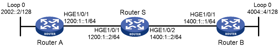

Example: Configuring basic RIPng
As shown in Figure 2, Router A, Router B, and Router C learn IPv6 routing information through RIPng. Configure route filtering on Router B to accept all received routes except the route 2::/64 and to advertise only the route 4::/64.
Figure 2 Network diagram
IMPORTANT
IMPORTANT:
By default, interfaces on the device are disabled (in ADM or Administratively Down state). To have an interface operate, you must use the undo shutdown command to enable that interface.
1.     Configure IPv6 addresses for the interfaces. (Details not shown.)
2.     Configure basic RIPng settings:

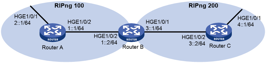

Example: Configuring RIPng route redistribution
As shown in Figure 3, Router B communicates with Router A through RIPng 100 and with Router C through RIPng 200.
Configure route redistribution on Router B, so the two RIPng processes can redistribute routes from each other.
Figure 3 Network diagram
IMPORTANT
IMPORTANT:

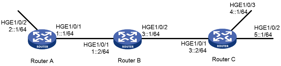

Example: Configuring RIPng GR
As shown in Figure 4, Router A, Router B, and Router C learn IPv6 routing information through RIPng.
Configure Router A as the GR restarter. Configure Router B and Router C as the GR helpers to synchronize their routing tables with Router A by using GR.
Figure 4 Network diagram

Example: Configuring RIPng NSR
As shown in Figure 5, Router S, Router A, and Router B learn IPv6 routing information through RIPng.
Enable RIPng NSR on Router S to ensure correct routing when an active/standby switchover occurs on Router S.
Figure 5 Network diagram
IMPORTANT
IMPORTANT:
2.     Configure RIPng on the routers to ensure the following: (Details not shown.)
¡     Router S, Router A, and Router B can communicate with each other at Layer 3.
¡     Dynamic route update can be implemented among them with RIPng.
3.     Enable RIPng NSR on Router S.
<RouterS> system-view
[RouterS] ripng 1
[RouterS-ripng-1] non-stop-routing
[RouterS-ripng-1] quit

Example: Configuring RIPng FRR
As shown in Figure 6, Router A, Router B, and Router C run RIPng. Configure RIPng FRR so that when Link A becomes unidirectional, traffic can be switched to Link B immediately.
Figure 6 Network diagram
