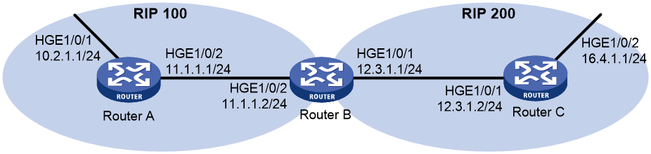

Configuring RIPv2 route summarization
Perform this task to summarize contiguous subnets into a summary network and sends the network to neighbors. The smallest metric among all summarized routes is used as the metric of the summary route.
You can use the following methods to summarize routes in RIPv2:
·     Automatic summarization—Configure RIPv2 to generate a natural network for contiguous subnets. For example, suppose there are three subnet routes 10.1.1.0/24, 10.1.2.0/24, and 10.1.3.0/24. Automatic summarization automatically creates and advertises a summary route 10.0.0.0/8 instead of the more specific routes.
·     Manual summarization—Manually configure a summary route. RIPv2 advertises the summary route rather than more specific routes. For example, suppose contiguous subnets routes 10.1.1.0/24, 10.1.2.0/24, and 10.1.3.0/24 exist in the routing table. You can create a summary route 10.1.0.0/16 on HundredGigE 1/0/1 to advertise the summary route instead of the more specific routes. By default, natural masks are used to advertise summary routes. To manually configure a summary route on an interface, you must first disable RIPv2 automatic route summarization.
In certain cases, route summarization might result in incorrect route calculation because it disables subnet route advertisement. If the routing table contains non-contiguous subnets, disable automatic route summarization so that RIPv2 can advertise subnet routes and host routes for correct route calculation.
As shown in Figure 1, RIPv2 is enabled on all interfaces on Device A, Device B, and Device C. If automatic route summarization is enabled (default setting), both Device A and Device C will send 10.1.0.0/8 to Device B. To ensure correct route calculation on Device B based on subnets 10.1.0.0/16 and 10.2.0.0/16, disable RIPv2 automatic route summarization.
Figure 1 Disabling RIPv2 automatic route summarization
To prevent loops caused by route summarization, create a black hole route by specifying interface NULL 0 as the output interface of the summary route. Packets that match the black hole route are dropped.

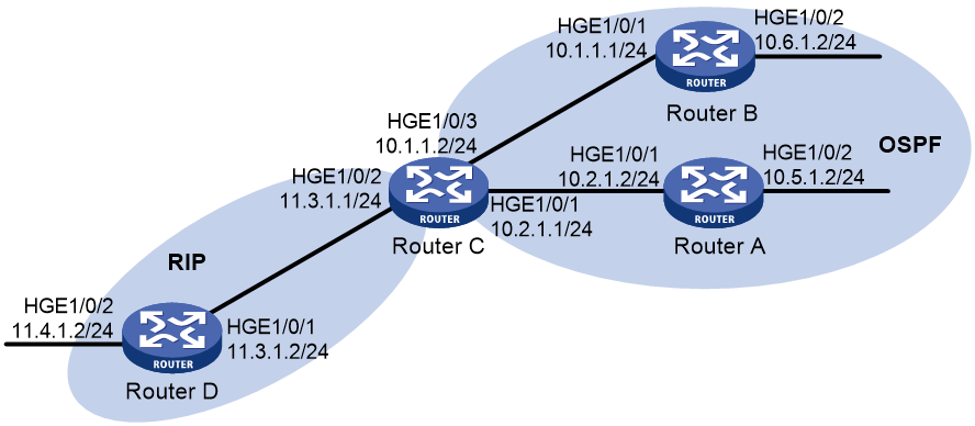

Configuring RIP route redistribution
Perform this task to configure RIP to redistribute routes from other routing protocols, including OSPF, IS-IS, BGP, static, and direct.
2.     Enter RIP view.
rip [ process-id ] [ vpn-instance vpn-instance-name ]
3.     Configure route redistribution.
¡     Redistribute BGP routes.
import-route bgp [ as-number ] [ allow-ibgp ] [ cost cost-value | route-policy route-policy-name | tag tag ] *
¡     Redistribute direct or static routes.
import-route { direct | static } [ cost cost-value | route-policy route-policy-name | tag tag ] *
¡     Redistribute IS-IS routes, OSPF routes, or routes from other RIP processes.
import-route { isis | ospf | rip } [ process-id | all-processes ] [ allow-direct | cost cost-value | route-policy route-policy-name | tag tag ] *
By default, RIP does not redistribute routes.
This command can redistribute only active routes. To view active routes, use the display ip routing-table protocol command.

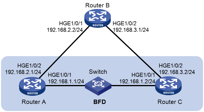

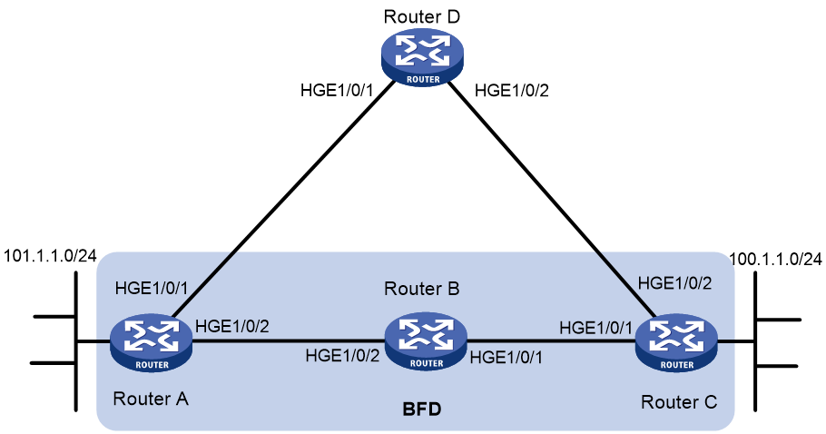

Configuring BFD for RIP
About BFD for RIP
RIP detects route failures by periodically sending requests. If it receives no response for a route within a certain time, RIP considers the route unreachable. To speed up convergence, perform this task to enable BFD for RIP. For more information about BFD, see High Availability Configuration Guide.
RIP supports the following BFD detection modes:
·     Single-hop echo detection—Detection mode for a directly connected neighbor. In this mode, a BFD session is established only when the directly connected neighbor has route information to send.
·     Single-hop echo detection for a specific destination—Detection mode for a directly connected neighbor. In this mode, a BFD session is established to the specified RIP neighbor when RIP is enabled on the local interface. When BFD detects a unidirectional link, the local device will not receive or send any RIP packets through the interface to improve convergence speed. When the link recovers, the interface can send RIP packets again.
·     Bidirectional control detection—Detection mode for both directly and indirectly connected neighbors. In this mode, a BFD session is established only when both ends have routes to send and BFD is enabled on the receiving interface.
The bfd all-interfaces enable command enables BFD for RIP on all interfaces of a RIP process. If the link to one of the interfaces becomes unstable, the BFD session might flap on the interface. This will affect the stability of the network. To resolve this problem, use the rip bfd disable command to disable BFD on that interface.
Configuring single-hop echo detection (for a directly connected RIP neighbor)
You need to perform this task only on the local device.

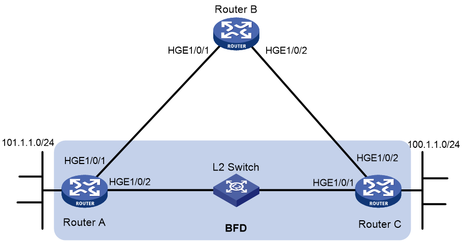

Configuring RIP FRR
About RIP FRR
A link or router failure on a path can cause packet loss and even routing loop until RIP completes routing convergence based on the new network topology. FRR enables fast rerouting to minimize the impact of link or node failures.
Figure 2 Network diagram for RIP FRR
As shown in Figure 2, configure FRR on Router B by using a routing policy to specify a backup next hop. When the primary link fails, RIP directs packets to the backup next hop. At the same time, RIP calculates the shortest path based on the new network topology, and forwards packets over that path after network convergence.
Restrictions and guidelines for RIP FRR
RIP FRR takes effect only for RIP routes learned from directly connected neighbors.
RIP FRR is available only when the state of primary link (with Layer 3 interfaces staying up) changes from bidirectional to unidirectional or down.
Equal-cost routes do not support RIP FRR.
Enabling RIP FRR
2.     Configure a routing policy for FRR.
You must specify a next hop by using the apply fast-reroute backup-interface command in the routing policy.
For more information about routing policy configuration, see "Configuring routing policies."

Example: Configuring RIP route redistribution
As shown in Figure 4, Router B communicates with Router A through RIP 100 and with Router C through RIP 200.
Configure RIP 200 to redistribute direct routes and routes from RIP 100 on Router B so Router C can learn routes destined for 10.2.1.0/24 and 11.1.1.0/24. Router A cannot learn routes destined for 12.3.1.0/24 and 16.4.1.0/24.

1.     Configure IP addresses for the interfaces. (Details not shown.)
2.     Configure basic RIP settings:
# Enable RIP 100, and configure RIPv2 on Router A.
<RouterA> system-view
[RouterA] rip 100
[RouterA-rip-100] network 10.0.0.0
[RouterA-rip-100] network 11.0.0.0
[RouterA-rip-100] version 2
[RouterA-rip-100] undo summary
[RouterA-rip-100] quit
# Enable RIP 100 and RIP 200, and configure RIPv2 on Router B.

3.     Configure RIP route redistribution:
# Configure RIP 200 to redistribute direct routes and routes from RIP 100 on Router B.
[RouterB] rip 200
[RouterB-rip-200] import-route rip 100
[RouterB-rip-200] import-route direct
[RouterB-rip-200] quit

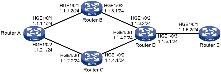

Example: Configuring an additional metric for a RIP interface
As shown in Figure 5, run RIPv2 on all the interfaces of Router A, Router B, Router C, Router D, and Router E.
Router A has two links to Router D. The link from Router B to Router D is more stable than that from Router C to Router D. Configure an additional metric for RIP routes received from HundredGigE 1/0/2 on Router A so Router A prefers route 1.1.5.0/24 learned from Router B.
Figure 5 Network diagram

1.     Configure IP addresses for the the interfaces. (Details not shown.)
# Configure Router A.
[RouterA] rip
[RouterA-rip-1] network 1.0.0.0
[RouterA-rip-1] version 2
[RouterA-rip-1] undo summary
[RouterA-rip-1] quit
# Configure Router B.
<RouterB> system-view
[RouterB] rip
[RouterB-rip-1] network 1.0.0.0
[RouterB-rip-1] version 2
[RouterB-rip-1] undo summary
# Configure Router C.
<RouterC> system-view
[RouterC] rip
[RouterC-rip-1] network 1.0.0.0
[RouterC-rip-1] version 2
[RouterC-rip-1] undo summary
# Configure Router D.
<RouterD> system-view
[RouterD] rip
[RouterD-rip-1] network 1.0.0.0
[RouterD-rip-1] version 2
[RouterD-rip-1] undo summary
# Configure Router E.
<RouterE> system-view
[RouterE] rip
[RouterE-rip-1] network 1.0.0.0
[RouterE-rip-1] version 2
[RouterE-rip-1] undo summary
# Display all active routes in the RIP database on Router A.
[RouterA] display rip 1 database
   1.0.0.0/8, auto-summary
       1.1.1.0/24, cost 0, nexthop 1.1.1.1, RIP-interface
       1.1.2.0/24, cost 0, nexthop 1.1.2.1, RIP-interface
       1.1.3.0/24, cost 1, nexthop 1.1.1.2
       1.1.4.0/24, cost 1, nexthop 1.1.2.2
       1.1.5.0/24, cost 2, nexthop 1.1.1.2
       1.1.5.0/24, cost 2, nexthop 1.1.2.2
The output shows two RIP routes destined for network 1.1.5.0/24. The next hops of the routes are Router B (1.1.1.2) and Router C (1.1.2.2). The cost of the routes is 2.
3.     Configure an additional metric for a RIP interface:
# Configure an inbound additional metric of 3 for RIP-enabled interface HundredGigE 1/0/2.
[RouterA] interface hundredgige 1/0/2
[RouterA-HundredGigE1/0/2] rip metricin 3
[RouterA-HundredGigE1/0/2] display rip 1 database
       1.1.4.0/24, cost 2, nexthop 1.1.1.2
The output shows that only one RIP route reaches network 1.1.5.0/24, with the next hop as Router B (1.1.1.2) and a cost of 2.
Example: Configuring RIP to advertise a summary route
As shown in Figure 6, Router A and Router B run OSPF, Router D runs RIP, and Router C runs OSPF and RIP.
·     Configure RIP to redistribute OSPF routes on Router C so Router D can learn routes destined for networks 10.1.1.0/24, 10.2.1.0/24, 10.5.1.0/24, and 10.6.1.0/24.
·     To reduce the routing table size of Router D, configure route summarization on Router C to advertise only the summary route 10.0.0.0/8 to Router D.
Figure 6 Network diagram
2.     Configure basic OSPF settings:
[RouterA] ospf
[RouterA-ospf-1] area 0
[RouterA-ospf-1-area-0.0.0.0] network 10.5.1.0 0.0.0.255
[RouterA-ospf-1-area-0.0.0.0] network 10.2.1.0 0.0.0.255
[RouterA-ospf-1-area-0.0.0.0] quit
[RouterB] ospf
[RouterB-ospf-1] area 0
[RouterB-ospf-1-area-0.0.0.0] network 10.1.1.0 0.0.0.255
[RouterB-ospf-1-area-0.0.0.0] network 10.6.1.0 0.0.0.255
[RouterB-ospf-1-area-0.0.0.0] quit
[RouterC] ospf
[RouterC-ospf-1] area 0
[RouterC-ospf-1-area-0.0.0.0] network 10.1.1.0 0.0.0.255
[RouterC-ospf-1-area-0.0.0.0] network 10.2.1.0 0.0.0.255
[RouterC-ospf-1-area-0.0.0.0] quit
[RouterC-ospf-1] quit
3.     Configure basic RIP settings:
[RouterC] rip 1
[RouterC-rip-1] network 11.3.1.0
[RouterD] rip 1
[RouterD-rip-1] network 11.0.0.0
[RouterD-rip-1] quit
# Configure RIP to redistribute routes from OSPF process 1 and direct routes on Router C.
[RouterC-rip-1] import-route direct
[RouterC-rip-1] import-route ospf 1
[RouterC-rip-1] quit
# Display the IP routing table on Router D.
[RouterD] display ip routing-table
         Destinations : 15       Routes : 15
0.0.0.0/32          Direct 0    0            127.0.0.1       InLoop0
10.1.1.0/24         RIP    100  1            11.3.1.1        HGE1/0/1
10.2.1.0/24         RIP    100  1            11.3.1.1        HGE1/0/1
10.5.1.0/24         RIP    100  1            11.3.1.1        HGE1/0/1
10.6.1.0/24         RIP    100  1            11.3.1.1        HGE1/0/1
11.3.1.0/24         Direct 0    0            11.3.1.2        HGE1/0/1
11.3.1.0/32         Direct 0    0            11.3.1.2        HGE1/0/1
11.3.1.2/32         Direct 0    0            127.0.0.1       InLoop0
11.4.1.0/24         Direct 0    0            11.4.1.2        HGE1/0/2
11.4.1.0/32         Direct 0    0            11.4.1.2        HGE1/0/2
11.4.1.2/32         Direct 0    0            127.0.0.1       InLoop0
127.0.0.0/8         Direct 0    0            127.0.0.1       InLoop0
127.0.0.0/32        Direct 0    0            127.0.0.1       InLoop0
127.0.0.1/32        Direct 0    0            127.0.0.1       InLoop0
127.255.255.255/32  Direct 0    0            127.0.0.1       InLoop0
4.     Configure route summarization:
# Configure route summarization on Router C to advertise only the summary route 10.0.0.0/8.
[RouterC] interface hundredgige 1/0/2
[RouterC-HundredGigE1/0/2] rip summary-address 10.0.0.0 8
Destinations : 12        Routes : 12
10.0.0.0/8          RIP    100  1            11.3.1.1        HGE1/0/1

Example: Configuring BFD for RIP (single-hop echo detection for a directly connected neighbor)
As shown in Figure 9, HundredGigE 1/0/1 of Router A and Router C runs RIP process 1. HundredGigE 1/0/2 of Router A runs RIP process 2. HundredGigE 1/0/2 of Router C and HundredGigE 1/0/1 and HundredGigE 1/0/2 of Router B run RIP process 1.
·     Configure a static route destined for 100.1.1.1/24 and enable static route redistribution into RIP on Router C. This allows Router A to learn two routes destined for 100.1.1.1/24 through HundredGigE 1/0/1 and HundredGigE 1/0/2 respectively, and uses the one through HundredGigE 1/0/1.
·     Enable BFD for RIP on HundredGigE 1/0/1 of Router A. When the link over HundredGigE 1/0/1 fails, BFD can quickly detect the failure and notify RIP. RIP deletes the neighbor relationship and route information learned on HundredGigE 1/0/1, and uses the route destined for 100.1.1.1 24 through HundredGigE 1/0/2.
Figure 9 Network diagram

1.     Configure IP addresses for interfaces. (Details not shown.)
[RouterA] rip 1
[RouterA-rip-1] network 192.168.1.0
[RouterA] rip 2
[RouterA-rip-2] network 192.168.2.0
[RouterA-rip-2] quit
[RouterB] rip 1
[RouterB-rip-1] network 192.168.2.0
[RouterB-rip-1] network 192.168.3.0
[RouterB-rip-1] quit
[RouterC] rip 1
[RouterC-rip-1] network 192.168.1.0
[RouterC-rip-1] network 192.168.3.0
[RouterC-rip-1] import-route static
3.     Enable BFD and configure BFD parameters on Router A.
[RouterA] bfd echo-source-ip 11.11.11.11
[RouterA] interface hundredgige 1/0/1
[RouterA-HundredGigE1/0/1] rip bfd enable
[RouterA-HundredGigE1/0/1] bfd min-echo-receive-interval 500
[RouterA-HundredGigE1/0/1] bfd detect-multiplier 7
[RouterA-HundredGigE1/0/1] quit
4.     Configure a static route on Router C.
[RouterC] ip route-static 120.1.1.1 24 null 0
# Display the BFD session information on Router A.
<RouterA> display bfd session
 Total sessions: 1        Up sessions: 1        Init mode: Active
 IPv4 session working in echo mode:
 LD               SourceAddr      DestAddr        State Holdtime    Interface
 4                192.168.1.1     192.168.1.2     Up    2000ms      GE1/0/1
# Display RIP routes destined for 120.1.1.0/24 on Router A.
<RouterA> display ip routing-table 120.1.1.0 24
Summary count : 1
Destination/Mask   Proto   Pre Cost        NextHop         Interface
120.1.1.0/24       RIP     100 1           192.168.1.2     HGE1/0/1
The output shows that Router A communicates with Router C through HundredGigE 1/0/1. Then the link over HundredGigE 1/0/1 fails.
Summary count : 1
120.1.1.0/24       RIP     100 2           192.168.2.2     HGE1/0/2
The output shows that Router A communicates with Router C through HundredGigE 1/0/2.
Example: Configuring BFD for RIP (single-hop echo detection for a specific destination)
As shown in Figure 10, HundredGigE 1/0/2 of Router A and HundredGigE 1/0/1 of Router B run RIP process 1. HundredGigE 1/0/2 of Router B and Router C runs RIP process 1.
·     Configure a static route destined for 100.1.1.0/24 and enable static route redistribution into RIP on both Router A and Router C. This allows Router B to learn two routes destined for 100.1.1.0/24 through HundredGigE 1/0/1 and HundredGigE 1/0/2. The route redistributed from Router A has a smaller cost than that redistributed from Router C, so Router B uses the route through HundredGigE 1/0/1.
·     Enable BFD for RIP on HundredGigE 1/0/2 of Router A, and specify HundredGigE 1/0/1 of Router B as the destination. When a unidirectional link occurs between Router A and Router B, BFD can quickly detect the link failure and notify RIP. RIP then deletes the neighbor relationship and the route information learned on HundredGigE 1/0/2. It does not receive or send any packets on HundredGigE 1/0/2. When the route learned from Router A ages out, Router B uses the route destined for 100.1.1.1/24 through HundredGigE 1/0/2.
Figure 10 Network diagram
[RouterA] rip 1
[RouterA-rip-1] network 192.168.2.0
[RouterA-rip-1] import-route static
[RouterB] rip 1
[RouterC] rip 1
[RouterC-rip-1] import-route static cost 3
[RouterA-HundredGigE1/0/2] rip bfd enable destination 192.168.2.2
[RouterA-HundredGigE1/0/2] bfd min-echo-receive-interval 500
[RouterA-HundredGigE1/0/2] quit
4.     Configure static routes:
# Configure a static route on Router A.
[RouterA] ip route-static 100.1.1.0 24 null 0
# Configure a static route on Router C.
[RouterC] ip route-static 100.1.1.0 24 null 0
 3                192.168.2.1     192.168.2.2     Up    2000ms      HGE1/0/2
# Display routes destined for 100.1.1.0/24 on Router B.
<RouterB> display ip routing-table 100.1.1.0 24 verbose
Summary count : 1
Destination: 100.1.1.0/24
   Protocol: RIP
  Process ID: 1
   SubProtID: 0x1                        Age: 00h02m47s
        Cost: 1                   Preference: 100
       IpPre: N/A                 QosLocalID: N/A
         Tag: 0                        State: Active Adv
   OrigTblID: 0x0                    OrigVrf: default-vrf
     TableID: 0x2                     OrigAs: 0
       NibID: 0x12000002              LastAs: 0
      AttrID: 0xffffffff            Neighbor: 192.168.2.1
       Flags: 0x1008c            OrigNextHop: 192.168.2.1
       Label: NULL               RealNextHop: 192.168.2.1
     BkLabel: NULL                 BkNextHop: N/A
     SRLabel: NULL                 Interface: HundredGigE1/0/1
   BkSRLabel: NULL               BkInterface: N/A
   Tunnel ID: Invalid            IPInterface: HundredGigE1/0/1
 BkTunnel ID: Invalid          BKIPInterface: N/A
     InLabel: NULL            ColorInterface: N/A
    SIDIndex: NULL          BKColorInterface: N/A
    FtnIndex: 0x0            TunnelInterface: N/A
TrafficIndex: N/A          BKTunnelInterface: N/A
   Connector: N/A                     PathID: 0x0
  SRTunnelID: Invalid
    SID Type: N/A                        NID: Invalid
    FlushNID: Invalid                  BkNID: Invalid
  BkFlushNID: Invalid              StatFlags: 0x0
         Exp: N/A
   VpnPeerId: N/A                       Dscp: N/A
         SID: N/A           OrigLinkID: 0x0
       BkSID: N/A           RealLinkID: 0x0
CommBlockLen: 0
# Display routes destined for 100.1.1.0/24 on Router B when the link between Router A and Router B fails.
Summary count : 1
   Protocol: RIP
  Process ID: 1
   SubProtID: 0x1                        Age: 00h21m23s
        Cost: 4                   Preference: 100
       NibID: 0x12000003              LastAs: 0
      AttrID: 0xffffffff            Neighbor: 192.168.3.2
       Flags: 0x1008c            OrigNextHop: 192.168.3.2
       Label: NULL               RealNextHop: 192.168.3.2
     SRLabel: NULL                 Interface: HundredGigE1/0/2
   Tunnel ID: Invalid            IPInterface: HundredGigE1/0/2
  SRTunnelID: Invalid
         Exp: N/A
CommBlockLen: 0
Example: Configuring BFD for RIP (bidirectional control detection for an indirectly connected neighbor)
As shown in Figure 11, HundredGigE 1/0/2 of Router A and HundredGigE 1/0/1 of Router C run RIP process 1. HundredGigE 1/0/1 on Router A runs RIP process 2. HundredGigE 1/0/2 on Router C, and HundredGigE 1/0/1 and HundredGigE 1/0/2 on Router D run RIP process 1.
·     Configure a static route destined for 100.1.1.0/24 on Router A.
·     Configure a static route destined for 101.1.1.0/24 on Router C.
·     Enable static route redistribution into RIP on Router A and Router C. This allows Router A to learn two routes destined for 100.1.1.0/24 through HundredGigE 1/0/2 and HundredGigE 1/0/1. It uses the route through HundredGigE 1/0/2.
·     Enable BFD for RIP on HundredGigE 1/0/2 of Router A and HundredGigE 1/0/1 of Router C.
When the link over HundredGigE 1/0/2 fails, BFD can quickly detect the link failure and notify RIP. RIP deletes the neighbor relationship and the route information learned on HundredGigE 1/0/2, and uses the route destined for 100.1.1.0/24 through HundredGigE 1/0/1.
Figure 11 Network diagram
Device
Interface
IP address
Router A
HundredGigE 1/0/1
192.168.3.1/24
Router A
HundredGigE 1/0/2
192.168.1.1/24
Router B
HundredGigE 1/0/1
192.168.2.1/24
Router B
HundredGigE 1/0/2
192.168.1.2/24
Router C
HundredGigE 1/0/1
192.168.2.2/24
Router C
HundredGigE 1/0/2
192.168.4.2/24
Router D
HundredGigE 1/0/1
192.168.3.2/24
Router D
HundredGigE 1/0/2
192.168.4.1/24
IMPORTANT
IMPORTANT:
By default, interfaces on the device are disabled (in ADM or Administratively Down state). To have an interface operate, you must use the undo shutdown command to enable that interface.
2.     Configure basic RIP settings and enable static route redistribution into RIP so Router A and Router C have routes to send to each other:
[RouterA] rip 1
[RouterA-rip-1] network 101.1.1.0
[RouterA-rip-1] peer 192.168.2.2
[RouterA-rip-1] undo validate-source-address
[RouterA] rip 2
[RouterA-rip-2] version 2
[RouterA-rip-2] undo summary
[RouterA-rip-2] network 192.168.3.0
[RouterC] rip 1
[RouterC-rip-1] network 192.168.2.0
[RouterC-rip-1] network 192.168.4.0
[RouterC-rip-1] network 100.1.1.0
[RouterC-rip-1] peer 192.168.1.1
[RouterC-rip-1] undo validate-source-address
[RouterD] rip 1

3.     Configure BFD settings:
# Enable BFD and configure BFD parameters on Router A.
[RouterA] bfd session init-mode active
[RouterA-HundredGigE1/0/2] bfd min-transmit-interval 500
[RouterA-HundredGigE1/0/2] bfd min-receive-interval 500
[RouterA-HundredGigE1/0/2] bfd detect-multiplier 7
# Enable BFD and configure BFD parameters on Router C.
[RouterC] bfd session init-mode active
[RouterC] interface hundredgige 1/0/1
[RouterC-HundredGigE1/0/1] rip bfd enable
[RouterC-HundredGigE1/0/1] bfd min-transmit-interval 500
[RouterC-HundredGigE1/0/1] bfd min-receive-interval 500
[RouterC-HundredGigE1/0/1] bfd detect-multiplier 6
[RouterC-HundredGigE1/0/1] quit
# Configure a static route to Router C on Router A.
[RouterA] ip route-static 192.168.2.0 24 hundredgige 1/0/2 192.168.1.2
[RouterA] quit
# Configure a static route to Router A on Router C.
[RouterC] ip route-static 192.168.1.0 24 hundredgige 1/0/1 192.168.2.1
[RouterA] display bfd session
 IPv4 session working in control mode:
 LD/RD            SourceAddr      DestAddr        State Holdtime    Interface
 513/513          192.168.1.1     192.168.2.2     Up    1700ms      HGE1/0/2
# Display RIP routes destined for 100.1.1.0/24 learned on Router A.
[RouterA] display ip routing-table 100.1.1.0 24
Summary count : 1
100.1.1.0/24       RIP     100 1           192.168.2.2     HGE1/0/2
The output shows that Router A communicates with Router C through HundredGigE 1/0/2. Then the link over HundredGigE 1/0/2 fails.
# Display RIP routes destined for 100.1.1.0/24 on Router A.
Summary count : 1
100.1.1.0/24       RIP     100 2           192.168.3.2     HGE1/0/1
Example: Configuring BFD for RIP (bidirectional control detection for a directly connected neighbor)
As shown in Figure 12, HundredGigE 1/0/2 of Router A and HundredGigE 1/0/1 of Router C run RIP process 1. HundredGigE 1/0/1 on Router A runs RIP process 2. HundredGigE 1/0/2 on Router C, and HundredGigE 1/0/1 and HundredGigE 1/0/2 on Router B run RIP process 1.
When link Router A—L2 Switch—Router C fails, BFD can quickly detect the link failure and notify RIP. RIP immediately switches to the Router A—Router B—Router C.
Figure 12 Network diagram
IMPORTANT
IMPORTANT:
[RouterA] rip 1
[RouterA] rip 2
[RouterB] rip 1
[RouterB-rip-1] network 192.168.4.0
[RouterC] rip 1
[RouterA-HundredGigE1/0/2] rip bfd enable ctrl
[RouterC-HundredGigE1/0/1] rip bfd enable ctrl
 513/513          192.168.1.1     192.168.1.2     Up    1700ms      HGE1/0/2
Summary count : 1
100.1.1.0/24       RIP     100 1           192.168.1.2     HGE1/0/2
The output shows that Router A communicates with Router C through L2 Switch.
# When Router A—L2 Switch—Router C fails, display RIP routes destined for 100.1.1.0/24 on Router A.
Summary count : 1
The output shows that Router A communicates with Router C through Router B.
