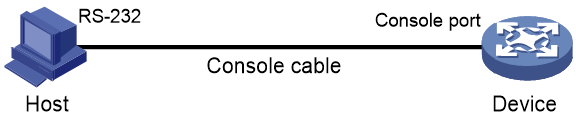

As shown in Figure 1, use a terminal emulator program, such as HyperTerminal or PuTTY to connect the configuration terminal to the device.
Figure 1 Connecting the PC to the device
Configure the terminal parameters as follows:
· Bits per second—9600.
· Data bits—8.
· Stop bits—1.
· Parity—None.
· Flow control—None.
