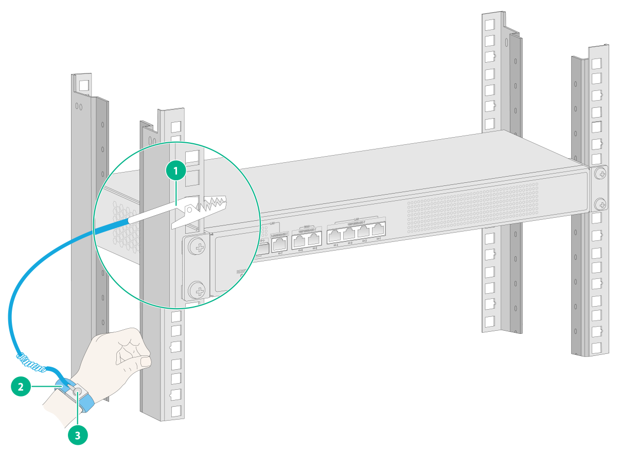

· Before working with the device, wear ESD gloves and ESD garment, and remove conductive objects such as jewelry or watch. Make sure the wrist strap makes good skin contact and is reliably grounded.
· Always remember to wear an ESD wrist strap when working with a transceiver module.
No ESD wrist strap is provided with the device. Prepare one yourself.
To attach an ESD wrist strap:
1. Wear the wrist strap on your wrist.
2. Lock the wrist strap tight around your wrist to maintain good contact with the skin.
3. Secure the wrist strap lock and the alligator clip lock together.
4. Attach the alligator clip to the rack.
5. Make sure the rack is reliably grounded.
Figure1-1 Attaching an ESD wrist strap
(1) Alligator clip |
(2) ESD wrist strap |
(3) Lock |

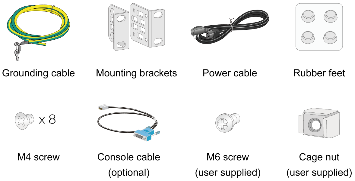

Installation accessories
Figure1-2 Installation accessories for the device

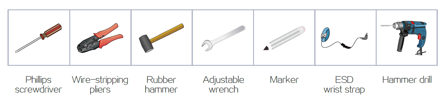

Installation tools
No installation tools are provided with the device. Prepare installation tools as required.
Figure1-3 Installation tools
