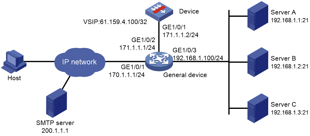

As shown in Figure 1, configure server load balancing on the device to load balance FTP traffic on the three servers. Configure email alerting to send alert emails to the network administrator ([email protected]) when a server fails.
Figure 1 Network diagram
1.     Assign IP addresses to interfaces and configure routes. Make sure the network connections are available. (Details not shown.)
2.     Configure server load balancing.
For more information, see server load balancing in Load Balancing Configuration Guide.
3.     Configure the email server:
# Create an email server and enter email server view.
<Device> system-view
[Device] email-server smtp-server1
# Specify the IPv4 address of the email server as 200.1.1.1.
[Device-email-server-smtp-server1] email-server host ip 200.1.1.1
4.     Test the email server:
# Send a test email to test the availability of the configured email server.
[Device-email-server-smtp-server1] email-server test
Email server is available.
# Return to system view.
[Device-email-server-smtp-server1] quit
5.     Configure email sending settings:
# Create and enter the email view of the warning type.
[Device] send-email type warning
# Configure the node failure event as a trigger for sending alert emails.
[Device-email-warning] event node-failure
# Specify smtp-server1 as the SMTP server for sending alert emails.
[Device-email-warning] email-server smtp-server1
# Configure the email subject as The state of real server.
[Device-email-warning] email-subject The state of real server
# Configure the recipient's email address as [email protected].
[Device-email-warning] email-recipients [email protected]
# Configure the sender's email address as [email protected].
[Device-email-warning] email-sender [email protected]
# Enable email sending.
[Device-email-warning] email-sending enable
[Device-email-warning] quit
# Display the configuration of email server smtp-server1.
[Device] display email-server name smtp-server1
Server name: smtp-server1
  Domain name:
  IPv4 address: 200.1.1.1
  IPv6 address:
  Port number: 25
  Email server client-authentication: Enabled
  Email server username: admin
# Display email sending settings.
<Device> display send-email type warning
Email type: Warning
  Event: node-failure
  Email server: smtp-server1
  Email subject: The state of real server
  Email recipients: [email protected]
  Email sender: [email protected]
  Email sending frequency: 60 sec
  Email sending function state: Enabled
