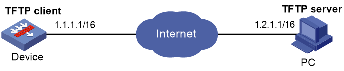

As shown in Figure 2, use Tcl to create a monitor policy on the Device. This policy must meet the following requirements:
·     EAA sends the log message "rtm_tcl_test is running" when a command that contains the display this string is entered.
·     The system executes the command only after it executes the policy successfully.
Figure 2 Network diagram
# Edit a Tcl script file (rtm_tcl_test.tcl, in this example) for EAA to send the message "rtm_tcl_test is running" when a command that contains the display this string is executed.
::platformtools::rtm::event_register cli sync mode execute pattern display this user-role network-admin
::platformtools::rtm::action syslog priority 1 facility local4 msg rtm_tcl_test is running
# Download the Tcl script file from the TFTP server at 1.2.1.1.
<Sysname> tftp 1.2.1.1 get rtm_tcl_test.tcl
# Create Tcl-defined policy test and bind it to the Tcl script file.
<Sysname> system-view
[Sysname] rtm tcl-policy test rtm_tcl_test.tcl
[Sysname] quit
# Execute the display rtm policy registered command to verify that a Tcl-defined policy named test is displayed in the command output.
<Sysname> display rtm policy registered
Total number: 1
Type  Event             TimeRegistered       PolicyName
TCL   CLI               Jan 01 09:47:12 2019 test
# Enable the information center to output log messages to the current monitoring terminal.
<Sysname> terminal monitor
The current terminal is enabled to display logs.
[Sysname] info-center enable
Information center is enabled.
[Sysname] quit
# Execute the display this command. Verify that the system displays an "rtm_tcl_test is running" message and a message that the policy is being executed successfully.
<Sysname> display this
%Jan  1 09:50:04:634 2019 Sysname RTM/1/RTM_ACTION:-Context=1;  rtm_tcl_test is running
%Jan  1 09:50:04:636 2019 Sysname RTM/6/RTM_POLICY:-Context=1;  TCL policy test is running successfully.
Return

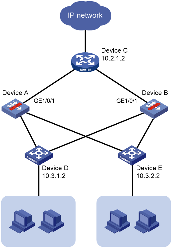

As shown in Figure 3, Device A has established BGP sessions with Device D and Device E. Traffic from Device D and Device E to the Internet is forwarded through Device A.
Configure a CLI-defined EAA monitor policy on Device A to disconnect the sessions with Device D and Device E when GigabitEthernet 1/0/1 connected to Device C is down. In this way, traffic from Device D and Device E to the Internet can be forwarded through Device B.
Figure 3 Network diagram
# Display BGP peer information for Device A.
<DeviceA> display bgp peer ipv4
 BGP local router ID: 1.1.1.1
 Local AS number: 100
 Total number of peers: 3                  Peers in established state: 3
  * - Dynamically created peer
  Peer                    AS  MsgRcvd  MsgSent OutQ PrefRcv Up/Down  State
  10.2.1.2                200       13       16    0       0 00:16:12 Established
  10.3.1.2                300       13       16    0       0 00:10:34 Established
  10.3.2.2                300       13       16    0       0 00:10:38 Established
# Create track entry 1 and associate it with the link state of GigabitEthernet 1/0/1.
<Device A> system-view
[Device A] track 1 interface gigabitethernet 1/0/1
# Configure a CLI-defined EAA monitor policy so that the system automatically disables session establishment with Device D and Device E when GigabitEthernet 1/0/1 is down.
[Device A] rtm cli-policy test
[Device A-rtm-test] event track 1 state negative
[Device A-rtm-test] action 0 cli system-view
[Device A-rtm-test] action 1 cli bgp 100
[Device A-rtm-test] action 2 cli peer 10.3.1.2 ignore
[Device A-rtm-test] action 3 cli peer 10.3.2.2 ignore
[Device A-rtm-test] user-role network-admin
[Device A-rtm-test] commit
[Device A-rtm-test] quit
# Shut down GigabitEthernet 1/0/1.
[Device A] interface gigabitethernet 1/0/1
[Device A-GigabitEthernet1/0/1] shutdown
# Execute the display bgp peer ipv4 command on Device A to display BGP peer information. No BGP peers are in established state.
