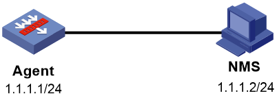

SNMP framework
The SNMP framework contains the following elements:
·     SNMP manager—Works on an NMS to monitor and manage the SNMP-capable devices in the network. It can get and set values of MIB objects on the agent.
·     SNMP agent—Works on a managed device to receive and handle requests from the NMS, and sends notifications to the NMS when events, such as an interface state change, occur.
·     Management Information Base (MIB)—Specifies the variables (for example, interface status and CPU usage) maintained by the SNMP agent for the SNMP manager to read and set.
Figure 1 Relationship between NMS, agent, and MIB

SNMP configuration examples
Example: Configuring SNMPv1/SNMPv2c
The configuration procedure is the same for SNMPv1 and SNMPv2c. The following example configures SNMPv1.
As shown in Figure 3, the NMS (1.1.1.2/24) uses SNMPv1 to manage the SNMP agent (1.1.1.1/24), and the agent automatically sends notifications to report events to the NMS.
Figure 3 Network diagram
IMPORTANT
IMPORTANT:
For the NMS to monitor, configure, and receive notifications from the agent, make sure the agent and the NMS have same configurations..
1.     Configure the agent:
# Assign IP address 1.1.1.1/24 to the agent and make sure the agent and the NMS are reachable to each other. (Details not shown.)
# Specify SNMPv1, and create read-only community public and read and write community private.
<Agent> system-view
[Agent] snmp-agent sys-info version v1
[Agent] snmp-agent community read public
[Agent] snmp-agent community write private
# Configure contact and physical location information for the agent.
[Agent] snmp-agent sys-info contact Mr.Wang-Tel:3306
[Agent] snmp-agent sys-info location telephone-closet,3rd-floor
# Enable the agent to use SNMPv1 community name public to send SNMP notifications to the NMS at 1.1.1.2.
[Agent] snmp-agent trap enable
[Agent] snmp-agent target-host trap address udp-domain 1.1.1.2 params securityname public v1
2.     Configure the SNMP NMS:
¡     Specify SNMPv1.
¡     Create read-only community public and read and write community private.
¡     Set the timeout timer and maximum number of retries as needed.
For information about configuring the NMS, see the NMS manual.
# Try to get the MTU value of the NULL0 interface from the agent. The attempt succeeds.
Send request to 1.1.1.1/161 ...
Protocol version: SNMPv1
Operation: Get
Request binding:
1: 1.3.6.1.2.1.2.2.1.4.135471
Response binding:
1: Oid=ifMtu.135471 Syntax=INT Value=1500
Get finished
# Use an incorrect community name to get the value of a MIB node on the agent. An authentication failure trap is sent to the NMS.
1.1.1.1/2934 V1 Trap = authenticationFailure
SNMP Version = V1
Community = public
Command = Trap
Enterprise = 1.3.6.1.4.1.43.1.16.4.3.50
GenericID = 4
SpecificID = 0
Time Stamp = 8:35:25.68
