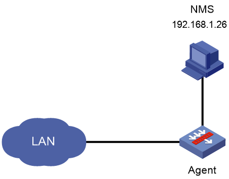

If the value of the monitored object crosses a threshold multiple times in succession, the managed device triggers an alarm event only for the first crossing. For example, if the value of a sampled object crosses the rising threshold multiple times before it crosses the falling threshold, only the first crossing triggers a rising alarm event, as shown in Figure 1.
Figure 1 Rising and falling alarm events

Example: Configuring an existence trigger test
As shown in Figure 2, the device acts as the agent. Use the Event MIB to monitor the device. When interface hot-swap or virtual interface creation or deletion occurs on the device, the agent sends an mteTriggerFired notification to the NMS.
Figure 2 Network diagram
1.     Enable and configure the SNMP agent on the device:
# Create SNMPv3 group g3 and add SNMPv3 user owner1 to g3.
<Sysname> system-view
[Sysname] snmp-agent usm-user v3 owner1 g3
[Sysname] snmp-agent group v3 g3 read-view a write-view a notify-view a
[Sysname] snmp-agent mib-view included a iso
# Configure context contextnameA for the agent.
[Sysname] snmp-agent context contextnameA
# Enable SNMP notifications for the Event MIB module. Specify the NMS at 192.168.1.26 as the target host for the notifications.
[Sysname] snmp-agent trap enable event-mib
[Sysname] snmp-agent target-host trap address udp-domain 192.168.1.26 params securityname owner1 v3
2.     Configure the Event MIB global sampling parameters.
# Set the Event MIB minimum sampling interval to 50 seconds.
[Sysname] snmp mib event sample minimum 50
# Set the maximum number to 100 for object instances that can be concurrently sampled.
[Sysname] snmp mib event sample instance maximum 100
3.     Create and configure a trigger:
# Create a trigger and enter its view. Specify its owner as owner1 and its name as triggerA.
[Sysname] snmp mib event trigger owner owner1 name triggerA
# Set the sampling interval to 60 seconds. Make sure the sampling interval is greater than or equal to the Event MIB minimum sampling interval.
[Sysname-trigger-owner1-triggerA] frequency 60
# Specify object OID 1.3.6.1.2.1.2.2.1.1 as the monitored object. Enable OID wildcarding.
[Sysname-trigger-owner1-triggerA] oid 1.3.6.1.2.1.2.2.1.1
[Sysname-trigger-owner1-triggerA] wildcard oid
# Configure context contextnameA for the monitored object and enable context wildcarding.
[Sysname-trigger-owner1-triggerA] context contextnameA
[Sysname-trigger-owner1-triggerA] wildcard context
# Specify the existence trigger test for the trigger.
[Sysname-trigger-owner1-triggerA] test existence
[Sysname-trigger-owner1-triggerA-existence] quit
# Enable trigger sampling.
[Sysname-trigger-owner1-triggerA] trigger enable
[Sysname-trigger-owner1-triggerA] quit
# Display Event MIB brief information.
[Sysname] display snmp mib event summary
TriggerFailures               : 0
EventFailures                 : 0
SampleMinimum                 : 50
SampleInstanceMaximum         : 100
SampleInstance                : 20
SampleInstancesHigh           : 20
SampleInstanceLacks           : 0
# Display information about the trigger with owner owner1 and name trigger A.
[Sysname] display snmp mib event trigger owner owner1 name triggerA
Trigger entry triggerA owned by owner1:
  TriggerComment              : N/A
  TriggerTest                 : existence
  TriggerSampleType           : absoluteValue
  TriggerValueID              : 1.3.6.1.2.1.2.2.1.1<ifIndex>
  TriggerValueIDWildcard      : true
  TriggerTargetTag            : N/A
  TriggerContextName          : contextnameA
  TriggerContextNameWildcard  : true
  TriggerFrequency(in seconds): 60
  TriggerObjOwner             : N/A
  TriggerObjName              : N/A
  TriggerEnabled              : true
  Existence entry:
   ExiTest                    : present | absent
   ExiStartUp                 : present | absent
   ExiObjOwner                : N/A
   ExiObjName                 : N/A
   ExiEvtOwner                : N/A
   ExiEvtName                 : N/A
# Create VLAN-interface 2 on the device.
[Sysname] vlan 2
[Sysname-vlan2] quit
[Sysname] interface vlan 2
The NMS will receive an mteTriggerFired notification from the device.
