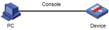

Example: Outputting logs to the console
Configure the device to output to the console FTP logs that have a minimum severity level of warning.
Figure 2 Network diagram
# Enable the information center.
<Device> system-view
[Device] info-center enable
# Disable log output to the console.
[Device] info-center source default console deny
To avoid output of unnecessary information, disable all modules from outputting logs to the specified destination (console in this example) before you configure the output rule.
# Configure an output rule to output to the console FTP logs that have a minimum severity level of warning.
[Device] info-center source ftp console level warning
[Device] quit
# Enable log output to the console.
<Device> terminal logging level 6
<Device> terminal monitor
The current terminal is enabled to display logs.
Now, if the FTP module generates logs, the information center automatically sends the logs to the console, and the console displays the logs on the monitor terminal.

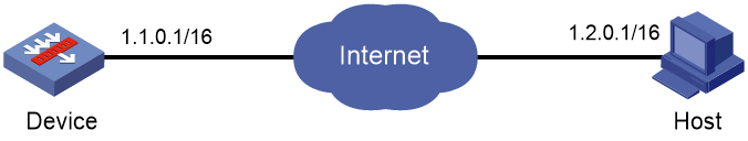

Example: Outputting logs to a UNIX log host
Configure the device to output to the UNIX log host FTP logs that have a minimum severity level of informational.
Figure 3 Network diagram
1.     Make sure the device and the log host can reach each other. (Details not shown.)
2.     Configure the device:
# Specify log host 1.2.0.1/16 with local4 as the logging facility.
[Device] info-center loghost 1.2.0.1 facility local4
# Disable log output to the log host.
[Device] info-center source default loghost deny
To avoid output of unnecessary information, disable all modules from outputting logs to the specified destination (loghost in this example) before you configure an output rule.
# Configure an output rule to output to the log host FTP logs that have a minimum severity level of informational.
[Device] info-center source ftp loghost level informational
3.     Configure the log host:
The log host configuration procedure varies by the vendor of the UNIX operating system. The following shows an example:
a.     Log in to the log host as a root user.
b.     Create a subdirectory named Device in directory /var/log/, and then create file info.log in the Device directory to save logs from the device.
# mkdir /var/log/Device
# touch /var/log/Device/info.log
c.     Edit file syslog.conf in directory /etc/ and add the following contents:
# Device configuration messages
local4.info /var/log/Device/info.log
In this configuration, local4 is the name of the logging facility that the log host uses to receive logs. The value info indicates the informational severity level. The UNIX system records the log information that has a minimum severity level of informational to file /var/log/Device/info.log.
Follow these guidelines while editing file /etc/syslog.conf:
·     Comments must be on a separate line and must begin with a pound sign (#).
·     No redundant spaces are allowed after the file name.
·     The logging facility name and the severity level specified in the /etc/syslog.conf file must be identical to those configured on the device by using the info-center loghost and info-center source commands. Otherwise, the log information might not be output to the log host correctly.
d.     Display the process ID of syslogd, kill the syslogd process, and then restart syslogd by using the –r option to validate the configuration.
# ps -ae | grep syslogd
147
# kill -HUP 147
# syslogd -r &
Now, the device can output FTP logs to the log host, which stores the logs to the specified file.
