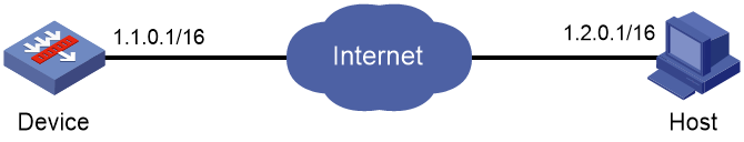

Example: Configuring fast log output to a log host
As shown in Figure 1, configure fast log output on the device to send session logs to the log host.
Figure 1 Network diagram
1.     Make sure the device and the log host can reach each other. (Details not shown.)
2.     Configure the device:
# Enable fast log output for the session management module.
<Device> system-view
[Device] customlog format session
# Output logs of the session management module to the log host at 1.2.0.1/16.
[Device] customlog host 1.2.0.1 port 1000 export session
# Enable logging for session creation and deletion.
[Device] session log flow-begin
[Device] session log flow-end
# Enable IPv4 session logging in the inbound direction of GigabitEthernet 1/0/1, the interface connected to the internal network.
[Device-GigabitEthernet1/0/1] session log enable ipv4 inbound
3.     Configure the host:
The log host configuration varies by log host. For more information, see related document of the log host.
On the host, verify that logs are received from the device successfully.
