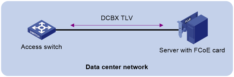

DCBX application scenario
Figure 6 DCBX application scenario
DCBX enables lossless packet transmission on DCE networks.
As shown in Figure 6, DCBX applies to an FCoE-based data center network, and operates on an access switch. DCBX enables the switch to control the server or storage adapter, and simplifies the configuration and guarantees configuration consistency. DCBX extends LLDP by using the IEEE 802.1 organizationally specific TLVs (DCBX TLVs) to transmit DCBX data, including:
·     In DCBX Rev 1.00 and DCBX Rev 1.01:
¡     Application Protocol (APP).
¡     Enhanced Transmission Selection (ETS).
¡     Priority-based Flow Control (PFC).
·     In IEEE Std 802.1Qaz-2011:
¡     ETS Configuration.
¡     ETS Recommendation.
¡     PFC.
¡     APP.
H3C devices can send these types of DCBX information to a server or storage adapter supporting FCoE. However, H3C devices cannot accept these types of DCBX information.

DCBX configuration examples
Example: Configuring DCBX
As shown in Figure 7, Ten-GigabitEthernet 1/0/1 of the access switch (Switch A) connects to the FCoE adapter of the data center server (DC server).
Configure Switch A to implement lossless FCoE and FIP frame transmission to DC server.
In this example, both Switch A and the DC server support DCBX Rev 1.01.
Figure 7 Network diagram

[SwitchA-qospolicy-plcy] quit
# Apply QoS policy plcy to the outgoing traffic of Ten-GigabitEthernet 1/0/1.
[SwitchA] interface ten-gigabitethernet 1/0/1
[SwitchA-Ten-GigabitEthernet1/0/1] qos apply policy plcy outbound
[SwitchA-Ten-GigabitEthernet1/0/1] quit
4.     Configure ETS parameters:
# Configure the 802.1p-to-local priority mapping table to map 802.1p priority value 3 to local precedence 3. (This is the default mapping table. You can modify this configuration as needed.)
[SwitchA] qos map-table outbound dot1p-lp
[SwitchA-maptbl-out-dot1p-lp] import 3 export 3
[SwitchA-maptbl-out-dot1p-lp] quit
# Enable byte-count WRR queuing on Ten-GigabitEthernet 1/0/1, and configure queue 3 on the interface to use SP queuing.
[SwitchA-Ten-GigabitEthernet1/0/1] qos wrr byte-count
[SwitchA-Ten-GigabitEthernet1/0/1] qos wrr 3 group sp
5.     Configure PFC:
# Enable PFC in auto mode on Ten-GigabitEthernet 1/0/1.
[SwitchA-Ten-GigabitEthernet1/0/1] priority-flow-control auto
# Enable PFC for 802.1 priority 3.
[SwitchA-Ten-GigabitEthernet1/0/1] priority-flow-control no-drop dot1p 3
# Display the data exchange result on the DC server through the software interface. This example uses the data exchange result for a QLogic adapter on the DC server.

The output shows that the DC server will use SP queuing (priority group ID 15) for 802.1p priority 3.

The output shows that the DC server will use PFC for 802.1p priority 3.
