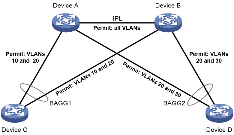

Root port rapid transition
When a root port is blocked, the bridge will elect the alternate port with the highest priority as the new root port. If the new root port's peer is in the forwarding state, the new root port immediately transits to the forwarding state.
As shown in Figure 13, Port C2 on Device C is a root port and Port C1 is an alternate port. When Port C2 transits to the blocking state, Port C1 is elected as the root port and immediately transits to the forwarding state.
Figure 13 Root port rapid transition

Configuring TC Snooping
As shown in Figure 18, an IRF fabric connects to two user networks through double links.
· Device A and Device B form the IRF fabric.
· The spanning tree feature is disabled on Device A and Device B and enabled on all devices in user network 1 and user network 2.
· The IRF fabric transparently transmits BPDUs for both user networks and is not involved in the calculation of spanning trees.
When the network topology changes, it takes time for the IRF fabric to update its MAC address table and ARP table. During this period, traffic in the network might be interrupted.
Figure 18 TC Snooping application scenario
To avoid traffic interruption, you can enable TC Snooping on the IRF fabric. After receiving a TC-BPDU through a port, the IRF fabric updates MAC address table and ARP table entries associated with the port's VLAN. In this way, TC Snooping prevents topology change from interrupting traffic forwarding in the network. For more information about the MAC address table and the ARP table, see "Configuring the MAC address table" and Layer 3—IP Services Configuration Guide.

When the link between Port A1 and Port B1 fails in the direction of Port A1 to Port B1 and becomes unidirectional, the following events occur:
1. Port A1 can only receive BPDUs and cannot send BPDUs to Port B1.
2. Port B1 does not receive BPDUs from Port A1 for a certain period of time.
3. Device B determines itself as the root bridge.
4. Port B1 sends its BPDUs to Port A1.
5. Port A1 determines the received BPDUs are inferior to its own BPDUs. A dispute is detected.
6. Dispute guard is triggered and blocks Port A1 to prevent a loop.
Figure 19 Dispute guard triggering scenario (on a designated port)
As shown in Figure 20, in normal conditions, Device A is the root bridge, and Port B1 and Port C1 are root ports. When the links between Device A and Device B become unidirectional (the links fail in the direction of Port A1 to Port B1), the following events occur:
1. Device B cannot receive BPDUs from Device A.
2. Device B determines itself as the root bridge.
3. Port B1 sends BPDUs in which the root bridge is Device B to Port C1.
4. Port C1 receives BPDUs from two root bridges, Device A and Device B. A dispute is detected.
5. Dispute guard is triggered and blocks Port C1 to avoid a loop.
Figure 20 Dispute guard triggering scenario (on a root port)
However, dispute guard might disrupt the network connectivity. You can disable dispute guard to avoid connectivity loss in VLAN networks. As shown in Figure 21, the spanning tree feature is disabled on Device B and enabled on Device A and device C. Device B transparently transmits BPDUs.
Device C cannot receive superior BPDUs of VLAN 1 from Device A because Port B1 of Device B is configured to deny packets of VLAN 1. Device C determines itself as the root bridge after a certain period of time. Then, Port C1 sends an inferior BPDU of VLAN 100 to Device A.
When Device A receives the inferior BPDU, dispute guard blocks Port A1, which causes traffic interruption. To ensure service continuity, you can disable dispute guard on Device A to prevent the link from being blocked.
Figure 21 Disabling dispute guard application scenario
You can disable dispute guard if the network does not have unidirectional link failures.

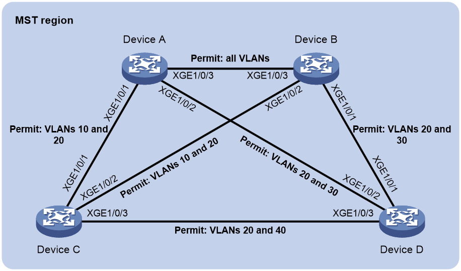

As shown in Figure 22, all devices on the network are in the same MST region. Device A and Device B work at the distribution layer. Device C and Device D work at the access layer.
Configure MSTP so that frames of different VLANs are forwarded along different spanning trees.
· VLAN 10 frames are forwarded along MSTI 1.
· VLAN 30 frames are forwarded along MSTI 3.
· VLAN 40 frames are forwarded along MSTI 4.
· VLAN 20 frames are forwarded along MSTI 0.
VLAN 10 and VLAN 30 are terminated on the distribution layer devices, and VLAN 40 is terminated on the access layer devices. The root bridges of MSTI 1 and MSTI 3 are Device A and Device B, respectively, and the root bridge of MSTI 4 is Device C.
IMPORTANT: By default, interfaces on the device are disabled (in ADM or Administratively Down state). To have an interface operate, you must use the undo shutdown command to enable that interface. |
1. Configure VLANs and VLAN member ports. (Details not shown.)
¡ Create VLAN 10, VLAN 20, and VLAN 30 on both Device A and Device B.
¡ Create VLAN 10, VLAN 20, and VLAN 40 on Device C.
¡ Create VLAN 20, VLAN 30, and VLAN 40 on Device D.
¡ Configure the ports on these devices as trunk ports and assign them to related VLANs.

In this example, Device B has the lowest root bridge ID. As a result, Device B is elected as the root bridge in MSTI 0.
When the network is stable, you can use the display stp brief command to display brief spanning tree information on each device.
# Display brief spanning tree information on Device A.
[DeviceA] display stp brief
MST ID Port Role STP State Protection
0 Ten-GigabitEthernet1/0/1 ALTE DISCARDING NONE
0 Ten-GigabitEthernet1/0/2 DESI FORWARDING NONE
0 Ten-GigabitEthernet1/0/3 ROOT FORWARDING NONE
1 Ten-GigabitEthernet1/0/1 DESI FORWARDING NONE
1 Ten-GigabitEthernet1/0/3 DESI FORWARDING NONE
3 Ten-GigabitEthernet1/0/2 DESI FORWARDING NONE
3 Ten-GigabitEthernet1/0/3 ROOT FORWARDING NONE
# Display brief spanning tree information on Device B.
[DeviceB] display stp brief
0 Ten-GigabitEthernet1/0/1 DESI FORWARDING NONE
0 Ten-GigabitEthernet1/0/3 DESI FORWARDING NONE
1 Ten-GigabitEthernet1/0/2 DESI FORWARDING NONE
1 Ten-GigabitEthernet1/0/3 ROOT FORWARDING NONE
3 Ten-GigabitEthernet1/0/1 DESI FORWARDING NONE
3 Ten-GigabitEthernet1/0/3 DESI FORWARDING NONE
# Display brief spanning tree information on Device C.
[DeviceC] display stp brief
0 Ten-GigabitEthernet1/0/2 ROOT FORWARDING NONE
1 Ten-GigabitEthernet1/0/1 ROOT FORWARDING NONE
1 Ten-GigabitEthernet1/0/2 ALTE DISCARDING NONE
4 Ten-GigabitEthernet1/0/3 DESI FORWARDING NONE
# Display brief spanning tree information on Device D.
[DeviceD] display stp brief
0 Ten-GigabitEthernet1/0/1 ROOT FORWARDING NONE
0 Ten-GigabitEthernet1/0/2 ALTE DISCARDING NONE
0 Ten-GigabitEthernet1/0/3 ALTE DISCARDING NONE
3 Ten-GigabitEthernet1/0/1 ROOT FORWARDING NONE
3 Ten-GigabitEthernet1/0/2 ALTE DISCARDING NONE
4 Ten-GigabitEthernet1/0/3 ROOT FORWARDING NONE
Based on the output, you can draw each MSTI mapped to each VLAN, as shown in Figure 23.

[DeviceC] stp vlan 40 root primary
# Enable the spanning tree feature globally and in VLAN 10, VLAN 20, and VLAN 40.
[DeviceC] stp global enable
[DeviceC] stp vlan 10 20 40 enable
5. Configure Device D:
# Set the spanning tree mode to PVST.
<DeviceD> system-view
[DeviceD] stp mode pvst
# Enable the spanning tree feature globally and in VLAN 20, VLAN 30, and VLAN 40.
[DeviceD] stp global enable
[DeviceD] stp vlan 20 30 40 enable
VLAN ID Port Role STP State Protection
10 Ten-GigabitEthernet1/0/1 DESI FORWARDING NONE
10 Ten-GigabitEthernet1/0/3 DESI FORWARDING NONE
20 Ten-GigabitEthernet1/0/1 DESI FORWARDING NONE
20 Ten-GigabitEthernet1/0/2 DESI FORWARDING NONE
20 Ten-GigabitEthernet1/0/3 DESI FORWARDING NONE
30 Ten-GigabitEthernet1/0/2 DESI FORWARDING NONE
30 Ten-GigabitEthernet1/0/3 ROOT FORWARDING NONE
10 Ten-GigabitEthernet1/0/2 DESI FORWARDING NONE
10 Ten-GigabitEthernet1/0/3 ROOT FORWARDING NONE
20 Ten-GigabitEthernet1/0/3 ROOT FORWARDING NONE
30 Ten-GigabitEthernet1/0/1 DESI FORWARDING NONE
30 Ten-GigabitEthernet1/0/3 DESI FORWARDING NONE
10 Ten-GigabitEthernet1/0/1 ROOT FORWARDING NONE
10 Ten-GigabitEthernet1/0/2 ALTE DISCARDING NONE
20 Ten-GigabitEthernet1/0/1 ROOT FORWARDING NONE
20 Ten-GigabitEthernet1/0/2 ALTE DISCARDING NONE
40 Ten-GigabitEthernet1/0/3 DESI FORWARDING NONE
20 Ten-GigabitEthernet1/0/1 ALTE DISCARDING NONE
20 Ten-GigabitEthernet1/0/2 ROOT FORWARDING NONE
20 Ten-GigabitEthernet1/0/3 ALTE DISCARDING NONE
30 Ten-GigabitEthernet1/0/1 ROOT FORWARDING NONE
30 Ten-GigabitEthernet1/0/2 ALTE DISCARDING NONE
40 Ten-GigabitEthernet1/0/3 ROOT FORWARDING NONE
Based on the output, you can draw a topology for each VLAN spanning tree, as shown in Figure 25.
Figure 25 VLAN spanning tree topologies
Example: Configuring DRNI with PVST
As shown in Figure 26, Device A and Device B work at the distribution layer, and Device C and Device D work at the access layer.
Configure DRNI on Device A and Device B. In the DR system, Device A is the primary DR device, and Device B is the secondary DR device.
Configure PVST on the devices to meet the following requirements:
· Frames of a VLAN are forwarded along the spanning trees of the VLAN.
· VLAN 10, VLAN 20, and VLAN 30 are terminated on the distribution layer devices.
· The root bridge of VLAN 10, VLAN 20, and VLAN 30 is the DR system formed by Device A and Device B.
NOTE: · As a best practice, do not connect ports on Device A and Device B that have the same port ID with each other, for example Layer 2 aggregate ports. Otherwise, when Device A and Device B communicate through the link, the spanning tree protocol determines that the device receives its own BPDUs. Loop guard will block the link, though spanning tree features are not affected. · You can view port IDs of interfaces on the device by using the display stp interface command. · The preceding restrictions do not apply to IPPs and their member ports. |
¡ Create VLAN 10, and VLAN 20 on Device C.
¡ Create VLAN 20, and VLAN 30 on Device D.
2. Configure DRNI on Device A and Device B. (Details not shown.)
For more information about DRNI, see "Configuring DRNI."
3. Configure Device A:
<DeviceA> system-view
[DeviceA] stp mode pvst
# Configure the device as the root bridge of VLAN 10 and VLAN 20.
[DeviceA] stp vlan 10 20 root primary
# Enable the spanning tree feature globally and in VLAN 10, VLAN 20, and VLAN 30.
[DeviceA] stp global enable
[DeviceA] stp vlan 10 20 30 enable
4. Configure Device B in the same way Device A is configured. (Details not shown.)
5. Configure Device C:
<DeviceC> system-view
[DeviceC] stp mode pvst
# Enable the spanning tree feature globally and in VLAN 10, and VLAN 20.
[DeviceC] stp vlan 10 20 enable
6. Configure Device D:
# Enable the spanning tree feature globally and in VLAN 20, and VLAN 30.
[DeviceD] stp vlan 20 30 enable
# Display brief spanning tree information of the DR system on the primary DR device, Device A.
10 Bridge-Aggregation1 DESI FORWARDING NONE
20 Bridge-Aggregation1 DESI FORWARDING NONE
20 Bridge-Aggregation2 DESI FORWARDING NONE
30 Bridge-Aggregation2 DESI FORWARDING NONE
10 Bridge-Aggregation1 ROOT FORWARDING NONE
20 Bridge-Aggregation1 ROOT FORWARDING NONE
20 Bridge-Aggregation2 ROOT FORWARDING NONE
30 Bridge-Aggregation2 ROOT FORWARDING NONE
