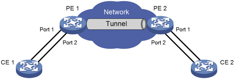

Enabling transparent LACPDU transmission
To establish a dynamic aggregation between two remote CEs in an L2VPN network, use transparent LACPDU transmission on the PEs to which the CEs are attached, as shown in Figure 6.
This feature enables the PEs to forward LACPDUs for the CEs to establish a dynamic aggregation.
If this feature is disabled, the PEs terminate the LACPDUs. The remote CEs cannot establish dynamic aggregations.
Figure 6 Application scenario of transparent LACPDU transmission
Perform the following tasks on PEs:
1. Configure the untagged or default frame match criterion for the Ethernet service instances on the interfaces connected to CEs.
2. Map the Ethernet service instances to different VSIs and set the access mode to Ethernet for the VSIs.
For more information about L2VPN and Ethernet service instances, see MPLS L2VPN configuration in MPLS Configuration Guide.
When you use this feature on the PEs, follow these guidelines:
· Enable transparent LACPDU transmission on the interfaces that transmit traffic between CEs and PEs and between PEs.
· Do not use an interface for dynamic link aggregation if you enable transparent LACPDU transmission on that interface. With transparent LACPDU transmission enabled, an interface cannot be selected for aggregation.

Setting the load sharing mode for tunneled traffic
Perform this task to set the criterion used by aggregation groups to distribute tunneled traffic for load sharing.
The device can use one of the following modes to distribute tunneled traffic on a link aggregation:
· All—Distributes tunneled traffic based on the inner IP header and outer IP header.
¡ For tunneled traffic to be forwarded with the tunnel header removed, information in the inner IP header is used for load sharing.
¡ For tunneled traffic to be forwarded without removing the tunnel header, information in both the inner and outer IP headers is used for load sharing.
· Inner—Distributes tunneled traffic based on the inner IP header.
· Outer—Distributes tunneled traffic based on the outer IP header.
1. Enter system view.
2. Set the load sharing mode for tunneled traffic on aggregate links.
link-aggregation global load-sharing tunnel { all | inner | outer }
By default, tunneled traffic is distributed based on the outer IP header on aggregate links.
