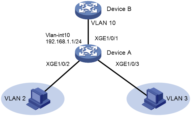

As shown in Figure 2:
· Host A and Host C belong to Department A. VLAN 100 is assigned to Department A.
· Host B and Host D belong to Department B. VLAN 200 is assigned to Department B.
Configure port-based VLANs so that only hosts in the same department can communicate with each other.

# Configure Ten-GigabitEthernet 1/0/3 as a trunk port, and assign the port to VLANs 100 and 200.
[DeviceA] interface ten-gigabitethernet 1/0/3
[DeviceA-Ten-GigabitEthernet1/0/3] port link-type trunk
[DeviceA-Ten-GigabitEthernet1/0/3] port trunk permit vlan 100 200
Please wait... Done.
2. Configure Device B in the same way Device A is configured. (Details not shown.)
3. Configure hosts:
a. Configure Host A and Host C to be on the same IP subnet. For example, 192.168.100.0/24.
b. Configure Host B and Host D to be on the same IP subnet. For example, 192.168.200.0/24.
# Verify that Host A and Host C can ping each other, but they both fail to ping Host B and Host D. (Details not shown.)
# Verify that Host B and Host D can ping each other, but they both fail to ping Host A and Host C. (Details not shown.)
# Verify that VLANs 100 and 200 are correctly configured on Device A.

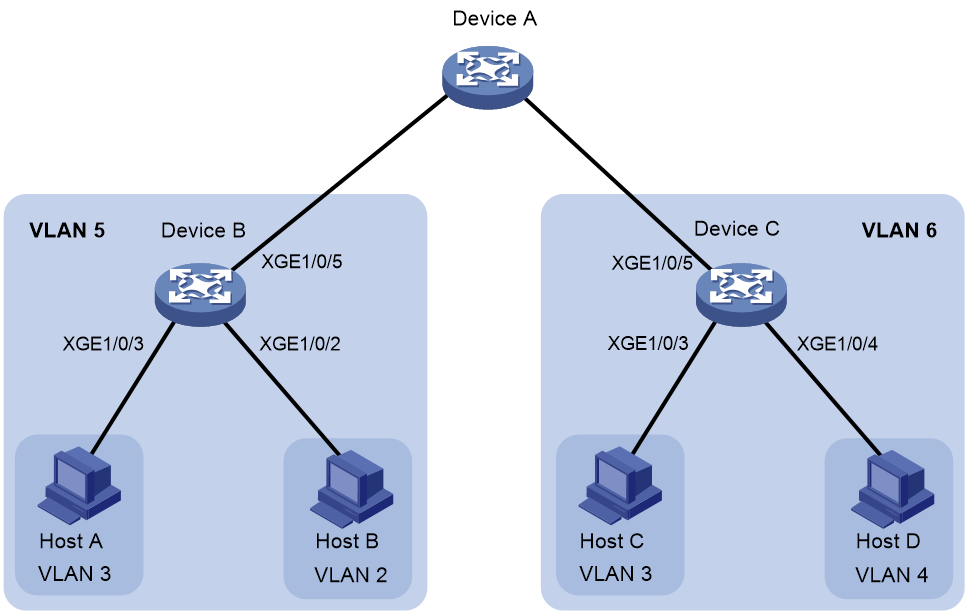

As shown in Figure 3:
· Ten-GigabitEthernet 1/0/1 and Ten-GigabitEthernet 1/0/2 are in VLAN 2.
· Ten-GigabitEthernet 1/0/3 and Ten-GigabitEthernet 1/0/4 are in VLAN 3.
· Ten-GigabitEthernet 1/0/5 and Ten-GigabitEthernet 1/0/6 are in VLAN 5.
To save IP addresses and enable sub-VLANs to be isolated at Layer 2 but interoperable at Layer 3, perform the following tasks:
· Create a super VLAN and assign an IP address to its VLAN interface.
· Associate the super VLAN with VLANs 2, 3, and 5.
IMPORTANT: By default, interfaces on the device are disabled (in ADM or Administratively Down state). To have an interface operate, you must use the undo shutdown command to enable that interface. |

# Create VLAN 2, and assign Ten-GigabitEthernet 1/0/1 and Ten-GigabitEthernet 1/0/2 to the VLAN.
[DeviceA] vlan 2
[DeviceA-vlan2] port ten-gigabitethernet 1/0/1 ten-gigabitethernet 1/0/2
[DeviceA-vlan2] quit
# Create VLAN 3, and assign Ten-GigabitEthernet 1/0/3 and Ten-GigabitEthernet 1/0/4 to the VLAN.
[DeviceA] vlan 3
[DeviceA-vlan3] port ten-gigabitethernet 1/0/3 ten-gigabitethernet 1/0/4
[DeviceA-vlan3] quit
# Create VLAN 5, and assign Ten-GigabitEthernet 1/0/5 and Ten-GigabitEthernet 1/0/6 to the VLAN.
[DeviceA] vlan 5
[DeviceA-vlan5] port ten-gigabitethernet 1/0/5 ten-gigabitethernet 1/0/6
[DeviceA-vlan5] quit
# Configure VLAN 10 as a super VLAN, and associate sub-VLANs 2, 3, and 5 with the super VLAN.
[DeviceA] vlan 10
[DeviceA-vlan10] supervlan
[DeviceA-vlan10] subvlan 2 3 5
[DeviceA-vlan10] quit
[DeviceA] quit

Private VLAN configuration examples
Example: Configuring promiscuous ports
As shown in Figure 5, configure the private VLAN feature to meet the following requirements:
· On Device B, VLAN 5 is a primary VLAN that is associated with secondary VLANs 2 and 3. Ten-GigabitEthernet 1/0/5 is in VLAN 5. Ten-GigabitEthernet 1/0/2 is in VLAN 2. Ten-GigabitEthernet 1/0/3 is in VLAN 3.
· On Device C, VLAN 6 is a primary VLAN that is associated with secondary VLANs 3 and 4. Ten-GigabitEthernet 1/0/5 is in VLAN 6. Ten-GigabitEthernet 1/0/3 is in VLAN 3. Ten-GigabitEthernet 1/0/4 is in VLAN 4.
· Device A is aware of only VLAN 5 on Device B and VLAN 6 on Device C.
This example describes the configurations on Device B and Device C.
1. Configure Device B:
# Configure VLAN 5 as a primary VLAN.
<DeviceB> system-view
[DeviceB] vlan 5
[DeviceB-vlan5] private-vlan primary
[DeviceB-vlan5] quit
# Create VLANs 2 and 3.
[DeviceB] vlan 2 to 3
# Associate secondary VLANs 2 and 3 with primary VLAN 5.
[DeviceB] vlan 5
[DeviceB-vlan5] private-vlan secondary 2 to 3
# Configure the uplink port (Ten-GigabitEthernet 1/0/5) as a promiscuous port of VLAN 5.
[DeviceB] interface ten-gigabitethernet 1/0/5
[DeviceB-Ten-GigabitEthernet1/0/5] port private-vlan 5 promiscuous
[DeviceB-Ten-GigabitEthernet1/0/5] quit
# Assign downlink port Ten-GigabitEthernet 1/0/2 to VLAN 2, and configure the port as a host port.
[DeviceB] interface ten-gigabitethernet 1/0/2
[DeviceB-Ten-GigabitEthernet1/0/2] port access vlan 2
[DeviceB-Ten-GigabitEthernet1/0/2] port private-vlan host
[DeviceB-Ten-GigabitEthernet1/0/2] quit
# Assign downlink port Ten-GigabitEthernet 1/0/3 to VLAN 3, and configure the port as a host port.
[DeviceB] interface ten-gigabitethernet 1/0/3
[DeviceB-Ten-GigabitEthernet1/0/3] port access vlan 3
[DeviceB-Ten-GigabitEthernet1/0/3] port private-vlan host
[DeviceB-Ten-GigabitEthernet1/0/3] quit
2. Configure Device C:
# Configure VLAN 6 as a primary VLAN.
<DeviceC> system-view
[DeviceC] vlan 6
[DeviceC–vlan6] private-vlan primary
[DeviceC–vlan6] quit
# Create VLANs 3 and 4.
[DeviceC] vlan 3 to 4
# Associate secondary VLANs 3 and 4 with primary VLAN 6.
[DeviceC] vlan 6
[DeviceC-vlan6] private-vlan secondary 3 to 4
[DeviceC-vlan6] quit
# Configure the uplink port (Ten-GigabitEthernet 1/0/5) as a promiscuous port of VLAN 6.
[DeviceC] interface ten-gigabitethernet 1/0/5
[DeviceC-Ten-GigabitEthernet1/0/5] port private-vlan 6 promiscuous
[DeviceC-Ten-GigabitEthernet1/0/5] quit
[DeviceC] interface ten-gigabitethernet 1/0/3
[DeviceC-Ten-GigabitEthernet1/0/3] port access vlan 3
[DeviceC-Ten-GigabitEthernet1/0/3] port private-vlan host
[DeviceC-Ten-GigabitEthernet1/0/3] quit
# Assign downlink port Ten-GigabitEthernet 1/0/4 to VLAN 4, and configure the port as a host port.
[DeviceC] interface ten-gigabitethernet 1/0/4
[DeviceC-Ten-GigabitEthernet1/0/4] port access vlan 4
[DeviceC-Ten-GigabitEthernet1/0/4] port private-vlan host
[DeviceC-Ten-GigabitEthernet1/0/4] quit
# Verify the private VLAN configurations on the devices, for example, on Device B.
[DeviceB] display private-vlan
Primary VLAN ID: 5
Secondary VLAN ID: 2-3
VLAN ID: 5
VLAN type: Static
Private VLAN type: Primary
Route interface: Not configured
Description: VLAN 0005
Tagged ports: None
Untagged ports:
VLAN ID: 2
VLAN type: Static
Private VLAN type: Secondary
Description: VLAN 0002
Tagged ports: None
Untagged ports:
VLAN ID: 3
VLAN type: Static
Description: VLAN 0003
Tagged Ports: None
Untagged Ports:
The output shows that:
· The promiscuous port (Ten-GigabitEthernet 1/0/5) is an untagged member of primary VLAN 5 and secondary VLANs 2 and 3.
· Host port Ten-GigabitEthernet 1/0/2 is an untagged member of primary VLAN 5 and secondary VLAN 2.
· Host port Ten-GigabitEthernet 1/0/3 is an untagged member of primary VLAN 5 and secondary VLAN 3.
Example: Configuring trunk promiscuous ports
As shown in Figure 6, configure the private VLAN feature to meet the following requirements:
· VLANs 5 and 10 are primary VLANs on Device B. The uplink port (Ten-GigabitEthernet 1/0/1) on Device B permits the packets from VLANs 5 and 10 to pass through tagged.
· On Device B, downlink port Ten-GigabitEthernet 1/0/2 permits secondary VLAN 2. Downlink port Ten-GigabitEthernet 1/0/3 permits secondary VLAN 3. Secondary VLANs 2 and 3 are associated with primary VLAN 5.
· On Device B, downlink port Ten-GigabitEthernet 1/0/4 permits secondary VLAN 6. Downlink port Ten-GigabitEthernet 1/0/5 permits secondary VLAN 8. Secondary VLANs 6 and 8 are associated with primary VLAN 10.
· Device A is aware of only VLANs 5 and 10 on Device B.
# Configure VLANs 5 and 10 as primary VLANs.
[DeviceB] vlan 5
[DeviceB] vlan 10
[DeviceB-vlan10] private-vlan primary
[DeviceB-vlan10] quit
# Create VLANs 2, 3, 6, and 8.
[DeviceB] vlan 6
[DeviceB-vlan6] quit
[DeviceB] vlan 8
[DeviceB-vlan8] quit
[DeviceB] vlan 5
# Associate secondary VLANs 6 and 8 with primary VLAN 10.
[DeviceB] vlan 10
[DeviceB-vlan10] private-vlan secondary 6 8
# Configure the uplink port (Ten-GigabitEthernet 1/0/1) as a trunk promiscuous port of VLANs 5 and 10.
[DeviceB] interface ten-gigabitethernet 1/0/1
[DeviceB-Ten-GigabitEthernet1/0/1] port private-vlan 5 10 trunk promiscuous
[DeviceB-Ten-GigabitEthernet1/0/1] quit
# Assign downlink port Ten-GigabitEthernet 1/0/4 to VLAN 6, and configure the port as a host port.
[DeviceB] interface ten-gigabitethernet 1/0/4
[DeviceB-Ten-GigabitEthernet1/0/4] port access vlan 6
[DeviceB-Ten-GigabitEthernet1/0/4] port private-vlan host
[DeviceB-Ten-GigabitEthernet1/0/4] quit
# Assign downlink port Ten-GigabitEthernet 1/0/5 to VLAN 8, and configure the port as a host port.
[DeviceB-Ten-GigabitEthernet1/0/5] port access vlan 8
[DeviceB-Ten-GigabitEthernet1/0/5] port private-vlan host
2. Configure Device A:
# Create VLANs 5 and 10.
[DeviceA] vlan 5

Example: Configuring trunk promiscuous and trunk secondary ports
As shown in Figure 7, configure the private VLAN feature to meet the following requirements:
· VLANs 10 and 20 are primary VLANs on Device A. The uplink port (Ten-GigabitEthernet 1/0/5) on Device A permits the packets from VLANs 10 and 20 to pass through tagged.
· VLANs 11, 12, 21, and 22 are secondary VLANs on Device A.
¡ Downlink port Ten-GigabitEthernet 1/0/2 permits the packets from secondary VLANs 11 and 21 to pass through tagged.
¡ Downlink port Ten-GigabitEthernet 1/0/1 permits secondary VLAN 22.
¡ Downlink port Ten-GigabitEthernet 1/0/3 permits secondary VLAN 12.
· Secondary VLANs 11 and 12 are associated with primary VLAN 10.
· Secondary VLANs 21 and 22 are associated with primary VLAN 20.

2. Configure Device B:
# Create VLANs 11 and 21.
[DeviceB] vlan 11
[DeviceB-vlan11] quit
[DeviceB] vlan 21
[DeviceB-vlan21] quit
# Configure Ten-GigabitEthernet 1/0/2 as a hybrid port, and assign it to VLANs 11 and 21 as a tagged VLAN member.
[DeviceB-Ten-GigabitEthernet1/0/2] port link-type hybrid
[DeviceB-Ten-GigabitEthernet1/0/2] port hybrid vlan 11 21 tagged
# Assign Ten-GigabitEthernet 1/0/3 to VLAN 11.
[DeviceB-Ten-GigabitEthernet1/0/3] port access vlan 11
# Assign Ten-GigabitEthernet 1/0/4 to VLAN 21.
[DeviceB-Ten-GigabitEthernet1/0/4] port access vlan 21
3. Configure Device C:
# Create VLANs 10 and 20.
[DeviceC] vlan 10
[DeviceC-vlan10] quit
[DeviceC] vlan 20
[DeviceC-vlan20] quit
# Configure Ten-GigabitEthernet 1/0/5 as a hybrid port, and assign it to VLANs 10 and 20 as a tagged VLAN member.
[DeviceC-Ten-GigabitEthernet1/0/5] port link-type hybrid
[DeviceC-Ten-GigabitEthernet1/0/5] port hybrid vlan 10 20 tagged

Example: Configuring Layer 3 communication for secondary VLANs
As shown in Figure 8, configure the private VLAN feature to meet the following requirements:
· Primary VLAN 10 on Device A is associated with secondary VLANs 2 and 3. The IP address of VLAN-interface 10 is 192.168.1.1/24.
· Ten-GigabitEthernet 1/0/1 belongs to VLAN 10. Ten-GigabitEthernet 1/0/2 and Ten-GigabitEthernet 1/0/3 belong to VLAN 2 and VLAN 3, respectively.
· Secondary VLANs are isolated at Layer 2 but interoperable at Layer 3.
# Create VLAN 10 and configure it as a primary VLAN.
<DeviceA> system-view
[DeviceA] vlan 10
[DeviceA-vlan10] private-vlan primary
[DeviceA] vlan 2 to 3
# Associate primary VLAN 10 with secondary VLANs 2 and 3.
[DeviceA] vlan 10
[DeviceA-vlan10] private-vlan secondary 2 3
# Configure the uplink port (Ten-GigabitEthernet 1/0/1) as a promiscuous port of VLAN 10.
[DeviceA] interface ten-gigabitethernet 1/0/1
[DeviceA-Ten-GigabitEthernet1/0/1] port private-vlan 10 promiscuous
[DeviceA-Ten-GigabitEthernet1/0/1] quit
[DeviceA] interface ten-gigabitethernet 1/0/2
[DeviceA-Ten-GigabitEthernet1/0/2] port access vlan 2
[DeviceA-Ten-GigabitEthernet1/0/2] port private-vlan host
[DeviceA-Ten-GigabitEthernet1/0/2] quit
[DeviceA-Ten-GigabitEthernet1/0/3] port access vlan 3
[DeviceA-Ten-GigabitEthernet1/0/3] port private-vlan host
[DeviceA-Ten-GigabitEthernet1/0/3] quit
# Enable Layer 3 communication between secondary VLANs 2 and 3 that are associated with primary VLAN 10.
[DeviceA] interface vlan-interface 10
[DeviceA-Vlan-interface10] private-vlan secondary 2 3
# Assign IP address 192.168.1.1/24 to VLAN-interface 10.
[DeviceA-Vlan-interface10] ip address 192.168.1.1 255.255.255.0
# Enable local proxy ARP on VLAN-interface 10.
[DeviceA-Vlan-interface10] local-proxy-arp enable
[DeviceA-Vlan-interface10] quit
