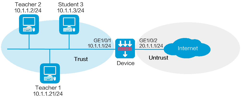

Example: Configuring a single traffic profile
As shown in Figure 1, configure bandwidth management on the device to meet the following requirements:
·     The maximum bandwidth is limited to 30 Mbps for both upstream and downstream iQiYiPPS application traffic of the host in the intranet.
·     The guaranteed bandwidth is 30 Mbps for both upstream and downstream FTP traffic of the host .
·     The bandwidth of the interface to the Internet is limited to 100 Mbps.
Figure 1 Network diagram

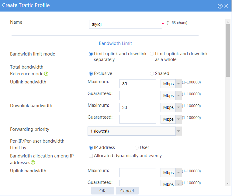

3.     Configure traffic profiles.
# On the top navigation bar, click Policies.
# From the navigation pane, select Bandwidth Management > Traffic Profiles.
# Click Create.
# In the dialog box that opens, create a traffic profile named aiqiyi as shown in Figure 2.
Figure 2 Creating a traffic profile named aiqiyi
# Click OK.

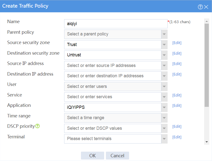

# In the dialog box that opens, create a traffic policy named aiqiyi, as shown in Figure 4.
Figure 4 Creating a traffic policy named aiqiyi
Figure 5 Creating a traffic policy named aiqiyi (continued)
# Click OK.
# After creating the traffic policy, select the policy and click Enable to enable the policy.

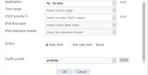

# Create a traffic policy FTP in the same way you create traffic policy aiqiyi, as shown in Figure 6.
Figure 6 Creating a traffic policy named FTP
Figure 7 Creating a traffic policy named FTP (continued)
# Click OK.

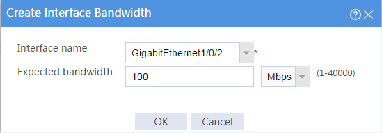

5.     Configure interface bandwidth.
# From the navigation pane, select Bandwidth Management > Interface Bandwidth.
# Click Create.
# In the dialog box that opens, configure interface bandwidth as shown in Figure 8.
Figure 8 Configuring interface bandwidth
# Click OK.
# Verify that the iQiYiPPS application traffic rate cannot exceed 30 Mbps and the FTP traffic rate can reach a minimum of 30 Mbps when the total traffic rate on GigabitEthernet 1/0/2 reaches 100 Mbps.

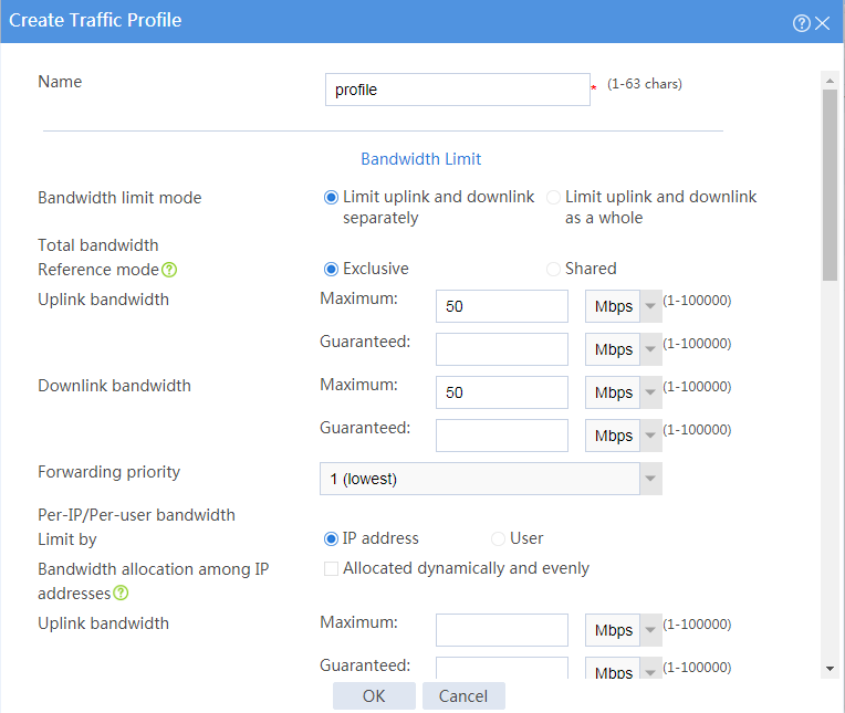

# Click Create.
# In the dialog box that opens, configure a traffic profile as shown in Figure 10.
Figure 10 Creating a traffic profile named profile
# Click OK.

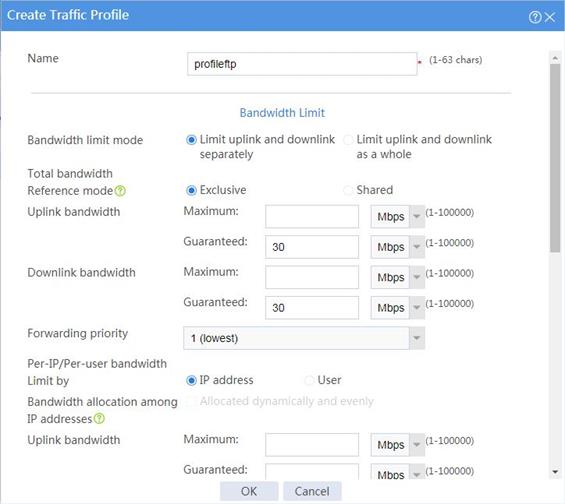

# Create a traffic profile named profileftp in the same way you create the traffic profile named profile, as shown in Figure 12.
Figure 12 Creating a traffic profile named profileftp
# Click OK.

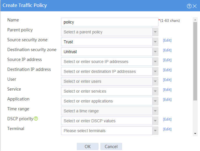

# In the dialog box that opens, create a traffic policy named policy as shown in Figure 13.
Figure 13 Creating a traffic policy named policy
Figure 14 Creating a traffic policy named policy (continued)
# Click OK.

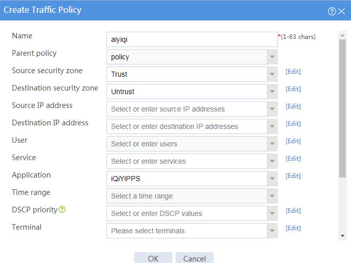

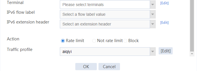

# In the dialog box that opens, create a traffic policy named aiqiyi as shown in Figure 15.
Figure 15 Creating a traffic policy named aiqiyi
Figure 16 Creating a traffic policy named aiqiyi (continued)
# Click OK.

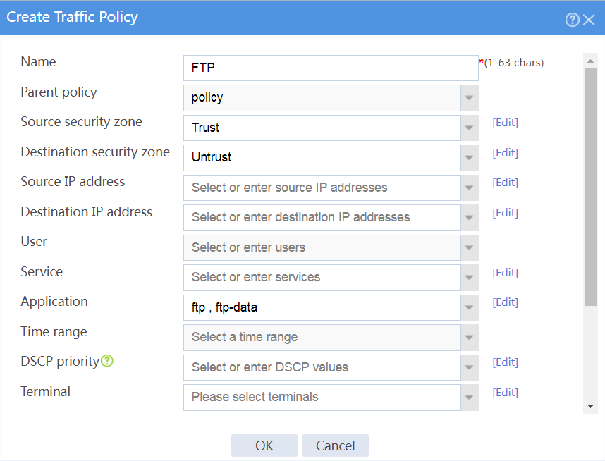

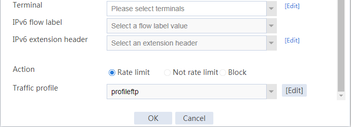

# Create a traffic policy named FTP in the same way you create the traffic policy named policy, as shown in Figure 17.
Figure 17 Creating a traffic policy named FTP
Figure 18 Creating a traffic policy named FTP (continued)
# Click OK.

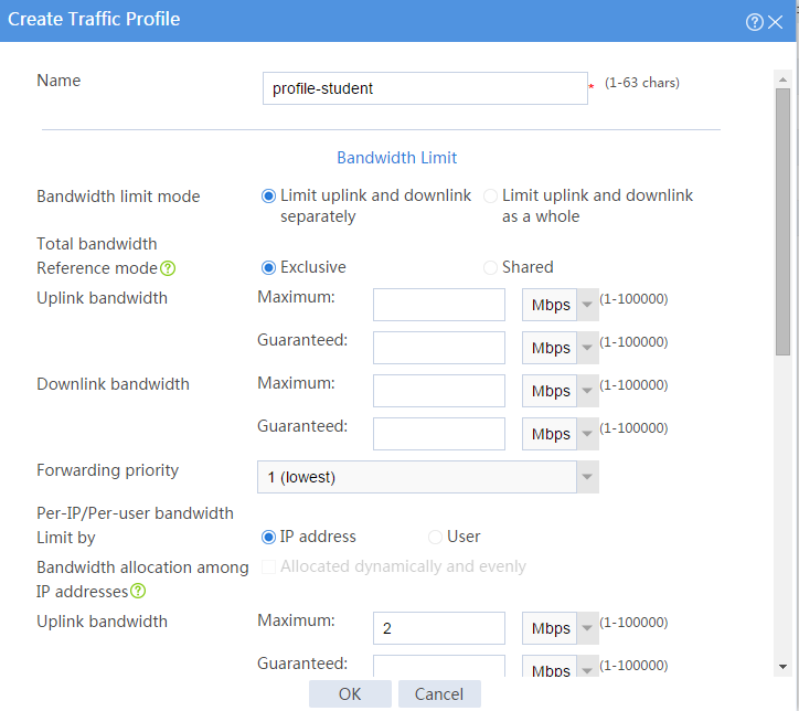

4.     Configure traffic profiles.
# Click Create.
# In the dialog box that opens, create a traffic profile named profile-teacher as shown in Figure 20.
Figure 20 Creating a traffic profile named profile-teacher
# Click OK.
# Create a traffic profile named profile-student as shown in Figure 21.
Figure 21 Creating a traffic profile named profile-student
# Click OK.

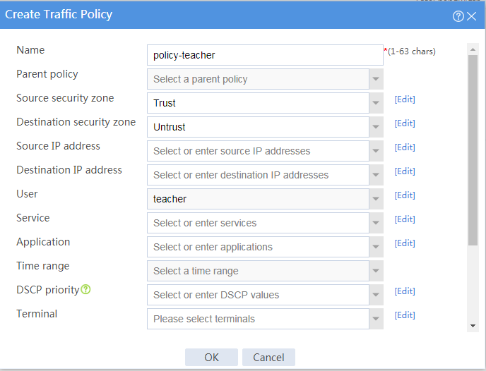

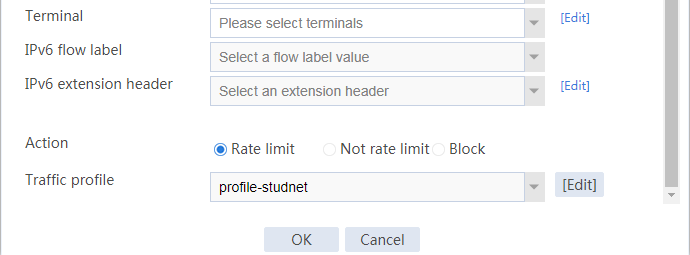

5.     Configure traffic policies.
# From the navigation pane, select Bandwidth Management > Traffic Policies.
# Click Create.

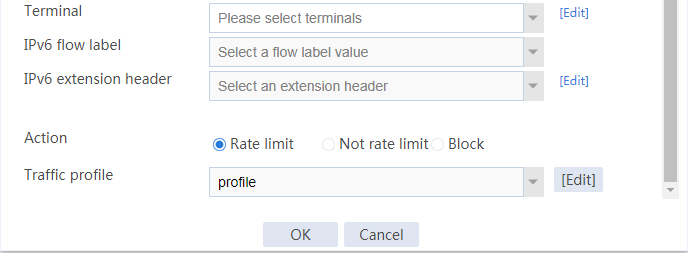

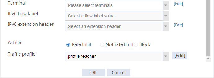

# In the dialog box that opens, create a traffic policy named policy-teacher as shown in Figure 22.
Figure 22 Creating a traffic policy named policy-teacher
Figure 23 Creating a traffic policy named policy-teacher (continued)
# Click OK.
# Create a traffic policy named policy-student in the same way you create the traffic policy named policy-teacher, as shown in Figure 24.
Figure 24 Creating a traffic policy named policy-student
Figure 25 Creating a traffic policy named policy-student (continued)
# Click OK.
