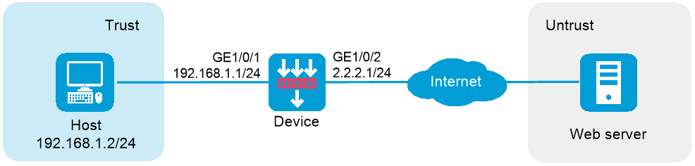

As shown in Figure 1, the internal users in the Trust security zone can access the Internet resources in the Untrust security zone. Configure the device to update the IPS signature library at 3:00:00 every Saturday.

1.     Assign IP addresses to interfaces and add the interfaces to security zones.
# On the top navigation bar, click Network.
# From the navigation pane, select Interface Configuration > Interfaces.
# Click the Edit icon for GE 1/0/1.
# In the dialog box that opens, configure the interface:
○          Select the Trust security zone.
○          On the IPv4 Address tab, enter the IP address and mask of the interface. This example uses 192.168.1.1/24.
○          Use the default settings for other parameters.
○          Click OK.
# Add GE 1/0/2 to the Untrust security zone and set its IP address to 2.2.2.1./24 in the same way you configure GE 1/0/1.

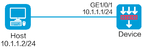

As shown in Figure 6, the up-to-date IPS signature file V7-IPS-1.0.128.dat is saved locally. Use the manual update method to load the file to the update the device IPS signature library.
Figure 6 Network diagram
Software versions used
This configuration example was created and verified on R8860 of the CSAP-NTA-300 device.

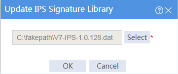

# Click the Manual update link for the IPS signature library.
# In the dialog box that opens, select the locally saved signature file V7-IPS-1.0.128.dat.
Figure 7 Selecting the locally saved signature file
# Click OK.
On the signature library update list, verify that the IPS signature library has been updated.
