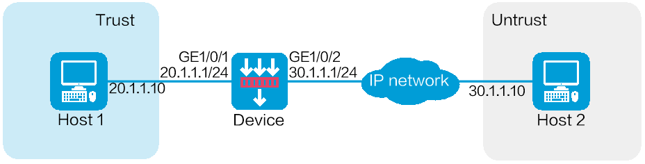

As shown in Figure 1, configure an IPv4 address object group on the device to allow Host 1 to communicate with Host 2.
Figure 1 Network diagram

This configuration example was created and verified on R8860 of the CSAP-NTA-300 device.

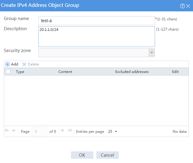

2.     Create an IPv4 address object group.
# On the top navigation bar, click Objects.
# From the navigation pane, select Object Groups > IPv4 Address Object Groups.
# Click Create.
# In the dialog box that opens, configure the IPv4 address object group:
a.     Enter a group name. In this example, enter test-a.
b.     Enter a description. In this example, enter 20.1.1.0/24.
c.     Click Add.
Figure 2 Create an IPv4 address object group

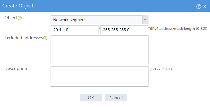

d.     In the dialog box that opens, select the Network segment object, and enter the IPv4 address and mask length 20.1.1.0/24.
e.     Click OK.
Figure 3 Create an object

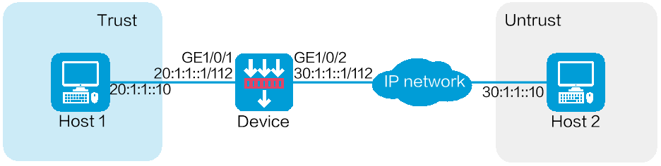

As shown in Figure 4, configure an IPv6 address object group on the device to allow Host 1 to communicate with Host 2.
Figure 4 Network diagram

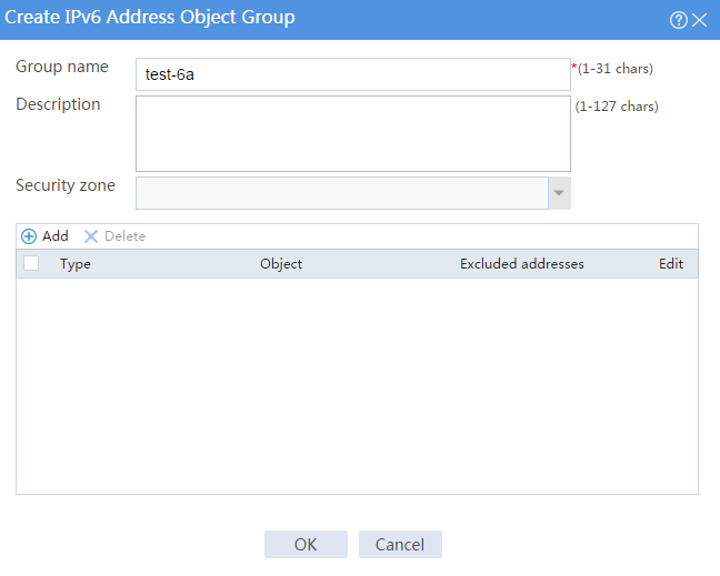

# In the dialog box that opens, configure the IPv6 address object group:
a.     Enter a group name. In this example, enter test-6a.
b.     Click Add.
Figure 5 Create an IPv6 address object group

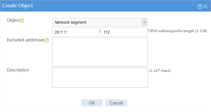

c.     In the dialog box that opens, select the Network segment object, and enter the IPv6 address and prefix length 20:1:1::/112.
d.     Click OK.
Figure 6 Create an object

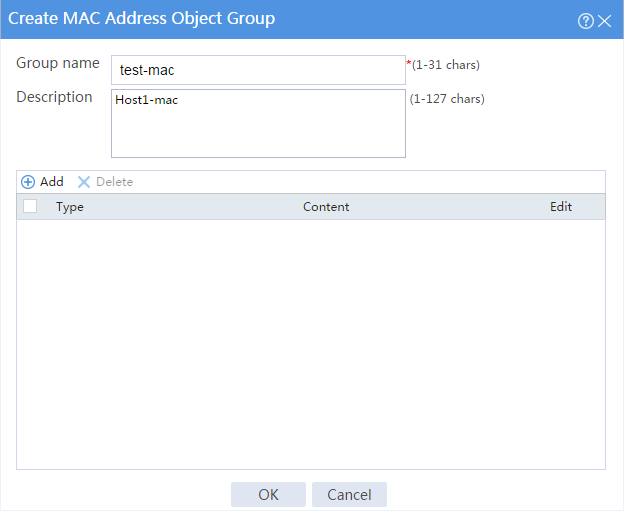

2.     Create a MAC address object group.
# From the navigation pane, select Object Groups > MAC Address Object Groups.
# Click Create.
# In the dialog box that opens, configure the MAC address object group:
a.     Enter a group name. In this example, enter test-mac.
b.     Enter a description. In this example, enter Host1-mac.
c.     Click Add.
Figure 8 Create a MAC address object group

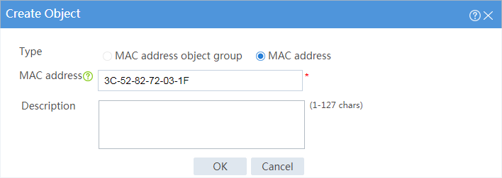

d.     In the dialog box that opens, configure a MAC address object.
-     Select type MAC address.
-     Enter MAC address 3C-52-82-72-03-1F.
e.     Click OK.
Figure 9 Create an object

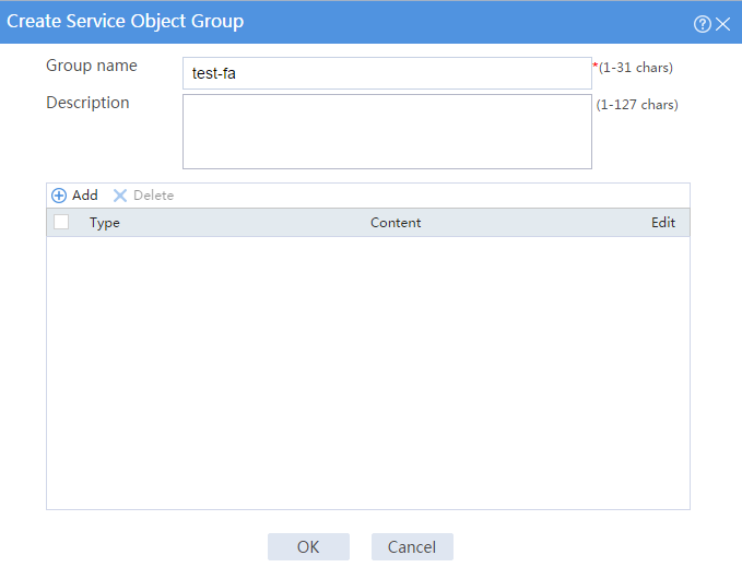

2.     Create a service object group.
# From the navigation pane, select Object Groups > Service Object Groups.
# Click Create.
# In the dialog box that opens, configure the service object group:
a.     Enter a group name. In this example, enter test-fa.
b.     Click Add.
Figure 11 Create a service object group

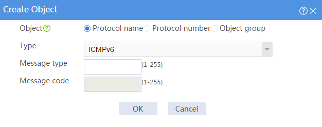

c.     In the dialog box that opens, configure a service object.
-     Select object Protocol name.
-     Select type ICMPv6.
d.     Click OK.
Figure 12 Create an object
# Click Create.
b.     Click Add.
Figure 14 Create a service object group
d.     Click OK.
Figure 15 Create an object
e.     On the Create Service Object Group page, click OK.

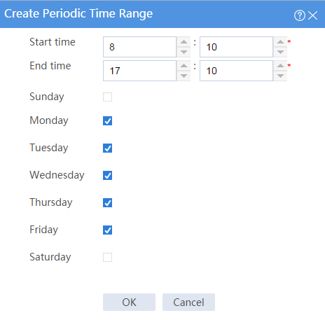

3.     Create a time range.
# On the top navigation bar, click Object.
# From the navigation pane, select Object Groups > Time Ranges.
# Click Create.
# In the dialog box that appears, enter name test-time and then click Create for Periodic time range.
# In the dialog box that appears, configure the time range:
¡     Set the start time to 08:10.
¡     Set the end time to 17:10.
¡     Select Monday, Tuesday, Wednesday, Thursday, and Friday.
# Click OK.
Figure 16 Configure a time range
# In the Create Time Range page, click OK.
