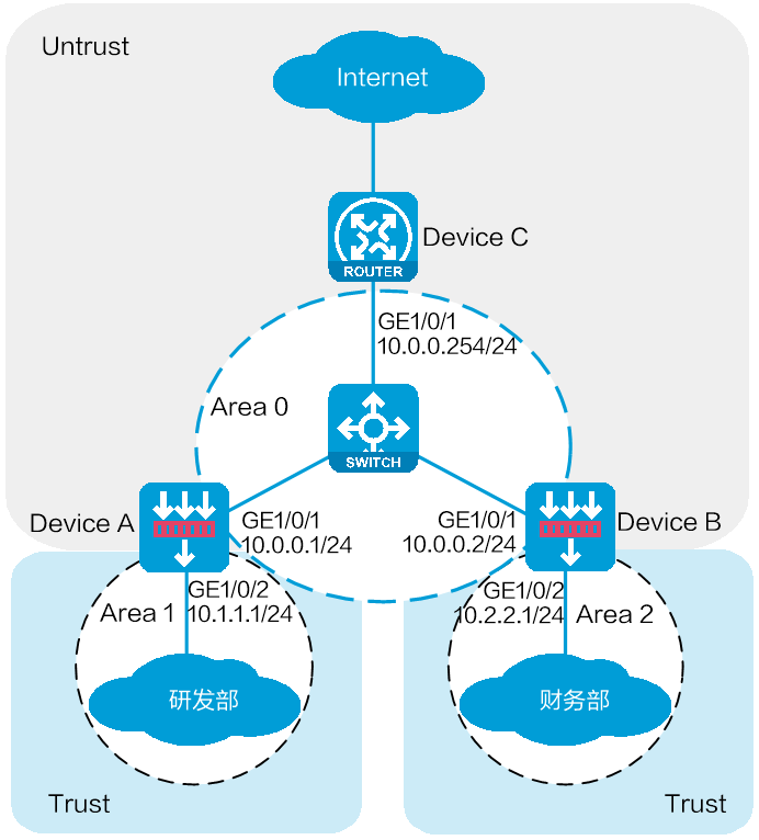

As shown in Figure 1, Device A and Device B are connected to R&D and finance departments, respectively. Device C is a router that acts as the gateway to the Internet.
Configure OSPF on the devices to enable the R&D and finance departments to learn routing information from each other. Configure a default route with the next hop being the gateway address 200.2.2.254 on Device C, and redistribute the default route to OSPF.
Figure 1 Network diagram

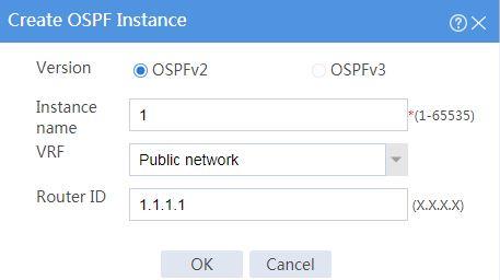

# Click Create.
# In the dialog box that opens, configure an OSPF instance.
Figure 3 Creating an OSPF instance
# Click OK.

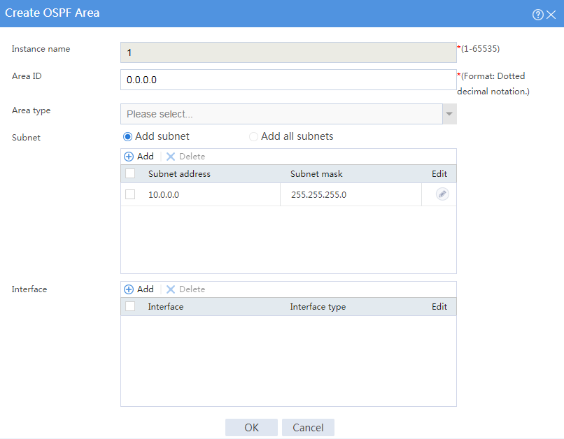

# On the OSPF area configuration page that opens, click Create.
# In the dialog box that opens, configure Area 0.
Figure 6 Creating Area 0
# Click OK.

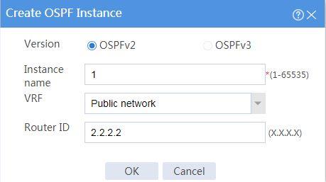

# Click Create.
Figure 9 Creating an OSPF instance
# Click OK.

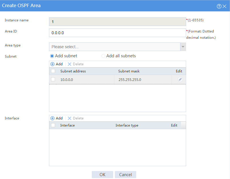

Figure 12 Creating Area 0
# Click OK.

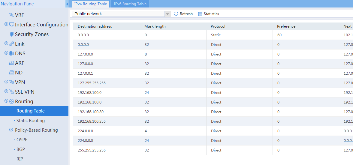

1.     View information about the OSPF routing table of Device A.
# On the top navigation bar, click Network.
# From the navigation pane, select Routing > Routing Table.
# On the IPv4 Routing Table tab, view the OSPF routing table information.
Figure 14 OSPF routing table of Device A
