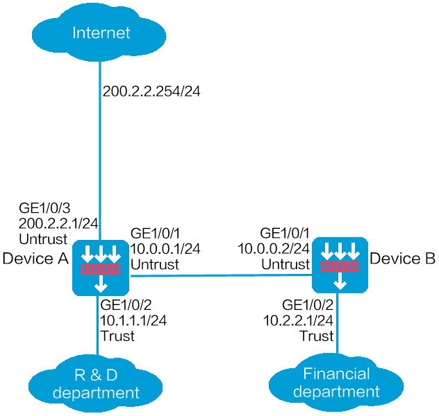

As shown in Figure 1, an enterprise deploys Device A and Device B for the R&D and financial departments, respectively. Device A also acts as the gateway to the Internet.
Configure RIP for the departments to learn routes from each other. Configure a default route on Device A, with the next hop pointing to the gateway address 200.2.2.254, and redistribute the default route to RIP.
Figure 1 Network diagram

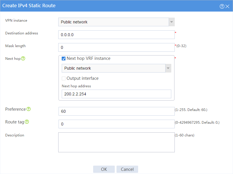

3.     Configure a default route to the ISP.
# On the top navigation bar, click Network.
# From the navigation pane, select Routing > Static Routing.
# Click Create.
# In the dialog box that opens, configure a static route as shown in Figure 2.
Figure 2 Creating a static route
# Click OK.

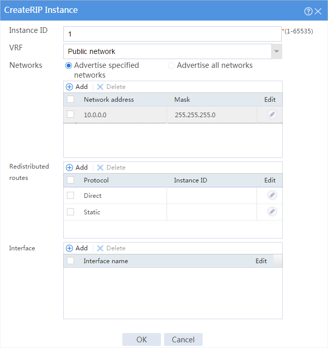

# In the dialog box that opens, configure the RIP instance as shown in Figure 4. Add the configured static route and the direct network of the R&D department as redistributed routes.
Figure 4 Creating a RIP instance

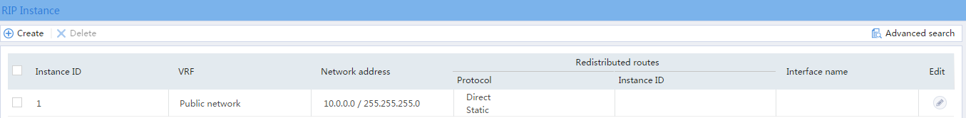

# Click OK. The RIP instance is created, as shown in Figure 5.
Figure 5 RIP instance

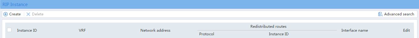

# From the navigation pane, select Routing > RIP. The RIP configuration page opens, as shown in Figure 6.
Figure 6 RIP configuration page

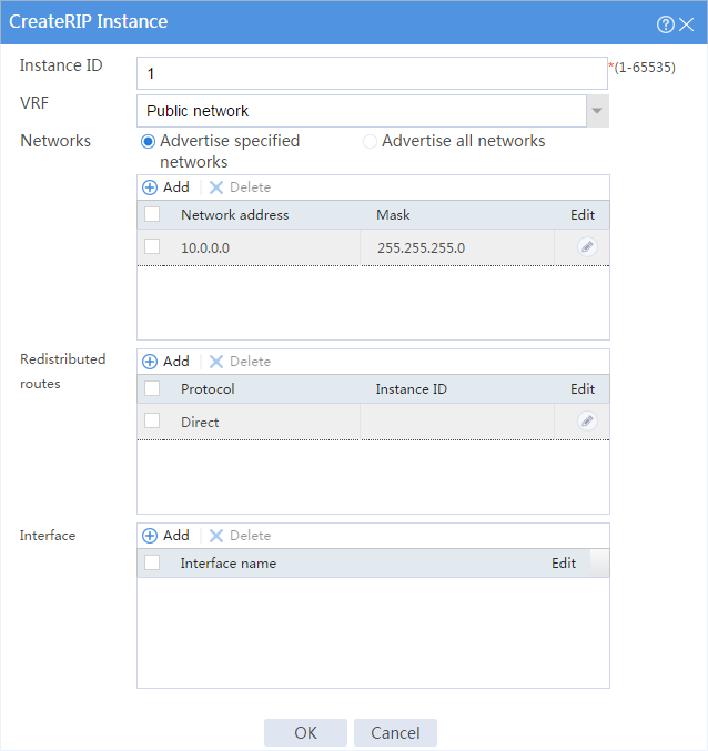

# In the dialog box that opens, configure the RIP instance as shown in Figure 7. Add the direct network of the financial department as a redistributed route.
Figure 7 Creating a RIP instance

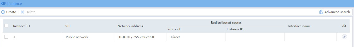

# Click OK. The RIP instance is created, as shown in Figure 8.
Figure 8 RIP instance
