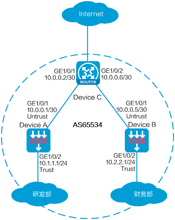

As shown in Figure 1, Device A and Device B are connected to R&D and finance departments, respectively. Device C is a router that acts as the gateway to the Internet.
Configure BGP on the devices to enable the R&D and finance departments to learn routing information from each other. Configure a default route with the next hop being gateway address 200.2.2.254 on Device C, and redistribute the default route to BGP.
Figure 1 Network diagram

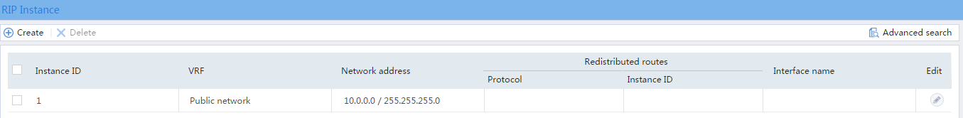

# In the dialog box that opens, configure a RIP instance.
Figure 2 RIP instance

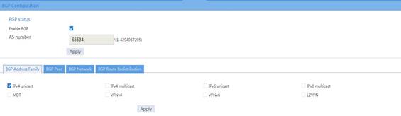

4.     Configure BGP.
# On the top navigation bar, click Network.
# From the navigation pane, select Routing > BGP.

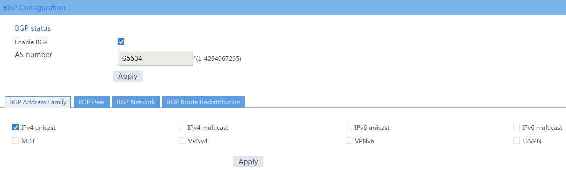

# Select Enable BGP, enter AS number 65534, and then click Apply.
Figure 3 Configuring BGP
# On the BGP Address Family tab, select an address family, and then click Apply.
Figure 4 Selecting a BGP address family

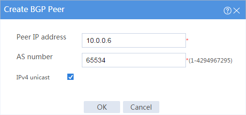

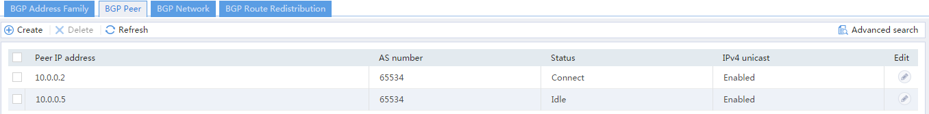

# On the BGP Peer tab, click Create.
# In the dialog box that opens, specify a BGP peer, and then click OK.
Figure 5 Specifying a BGP peer
# Repeat the above two steps to specify another BGP peer.
Figure 6 Specifying another BGP peer
Figure 7 BGP peers

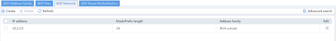

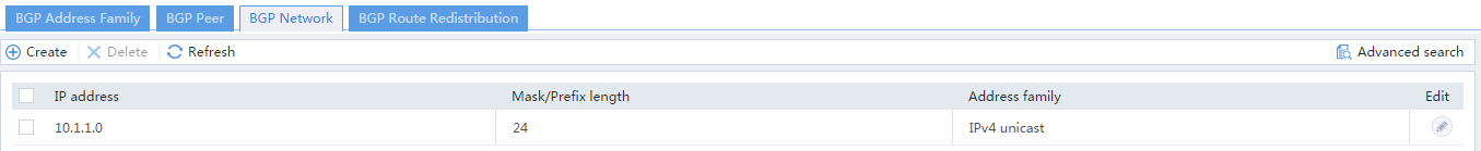

# On the BGP Network tab, click Create.
# In the dialog box that opens, specify the network to be advertised for the specified address family, and then click OK.
Figure 8 BGP network advertisement
Figure 9 BGP network advertisement
Figure 10 RIP instance

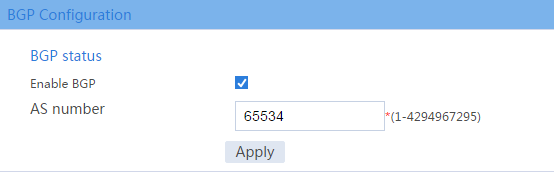

4.     Configure BGP.
Figure 11 Configuring BGP
Figure 12 Selecting a BGP address family
Figure 13 Specifying a BGP peer
Figure 14 Specifying another BGP peer

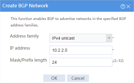

Figure 16 BGP network advertisement
Figure 17 BGP network advertisement

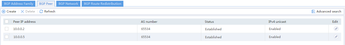

1.     View information about BGP peers of Device A.

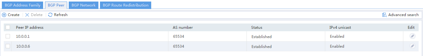

# On the BGP Peer tab, verify that the BGP peers are in Established state.
Figure 18 BGP routing table of Device A
You can see that the BGP peers are in Established state.
2.     View information about BGP peers of Device B.
Figure 19 BGP routing table of Device B
