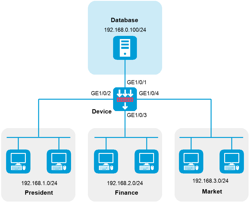

As shown in Figure 1, configure security policy to achieve the following goals:
·     The president office can access the financial database server through HTTP at any time.
·     The financial office can access the financial database server through HTTP from 8:00 to 18:00 on weekdays.
·     The marketing office cannot access the financial database server through HTTP at any time.
Figure 1 Network diagram

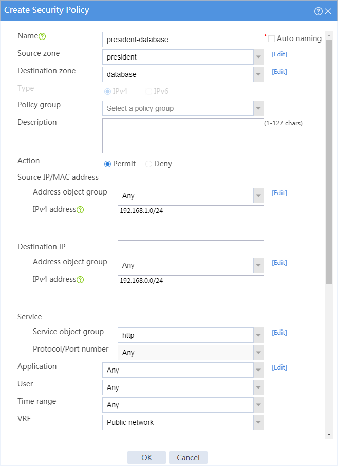

4.     Create a security policy from security zone president to security zone database to allow the president office to access the database through HTTP at any time.
# On the top navigation bar, click Policies.
# From the navigation pane, select Security Policies > Security Policies.
# Click Create, and then click Create a policy.
# In the dialog box that opens, create a security policy as shown in Figure 2:
Figure 2 Create a security policy for the president office
# Click OK.

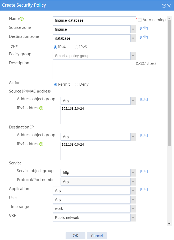

5.     Create a security policy from security zone finance to security zone database to allow the financial office to access the database through HTTP from 8:00 to 18:00 on weekdays.
# In the dialog box that opens, create a security policy as shown in Figure 3:
Figure 3 Create a security policy for the financial office
# Click OK.

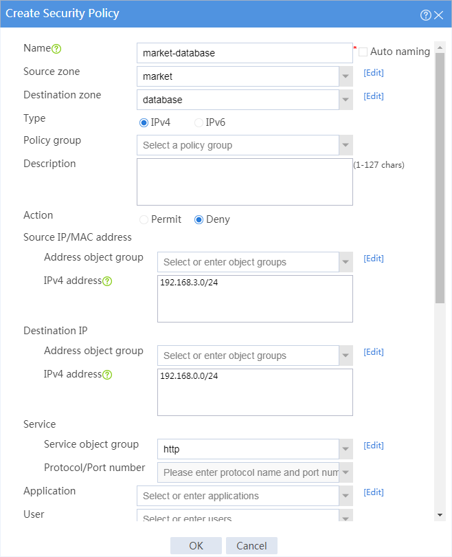

6.     Create a security policy from security zone market to security zone database to forbid the marketing office from accessing the database through HTTP at any time.
# In the dialog box that opens, create a security policy as shown in Figure 4:
Figure 4 Create a security policy for the marketing office
# Click OK.

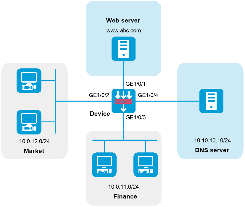

As shown in Figure 5, a Web server with domain name www.abc.com is deployed for financial management, and the domain name has been registered on the DNS server in the internal network. Configure a security policy to achieve the following goals:
·     The financial office can access the financial server through HTTP.
·     The marketing office cannot access the financial server through HTTP at any time.
Figure 5 Network diagram

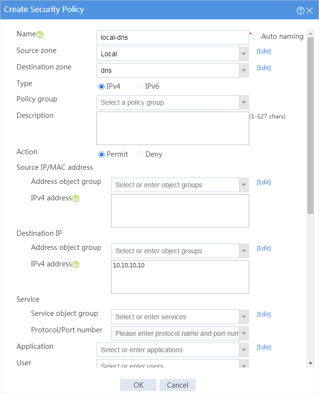

5.     Create a security policy from security zone local to security zone dns to allow the device to access the DNS server for host name translation.
# In the dialog box that opens, create a security policy as shown in Figure 6:
Figure 6 Create a security policy for the device to access the DNS server
# Click OK.

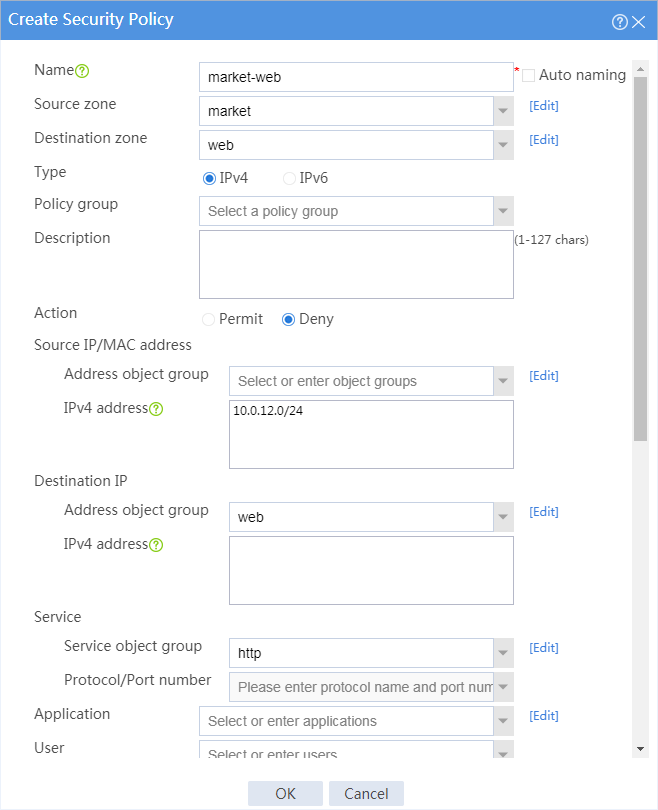

8.     Create a security policy from security zone market to security zone web to forbid the marketing office from accessing the financial Web server through HTTP at any time.
# In the dialog box that opens, create a security policy as shown in Figure 9:
Figure 9 Create a security policy for the marketing office
# Click OK.

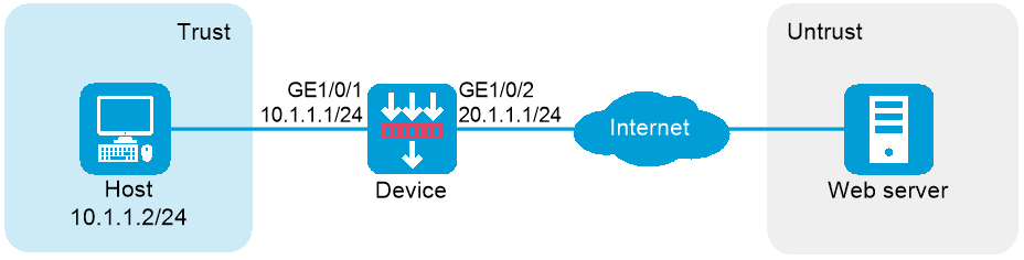

As shown in Figure 10, the host in the internal network accesses the Internet through the device. Configure a security policy and DPI on the device with the following settings:
·     Perform anti-virus detection on data packets from the internal network and drop packets with viruses.
·     Specify virus with ID 90321 as a virus exception.
·     Specify RenMinWang as an application exception. Enable the system to permit packets with viruses to RenMinWang and generate alarms.
Figure 10 Network diagram

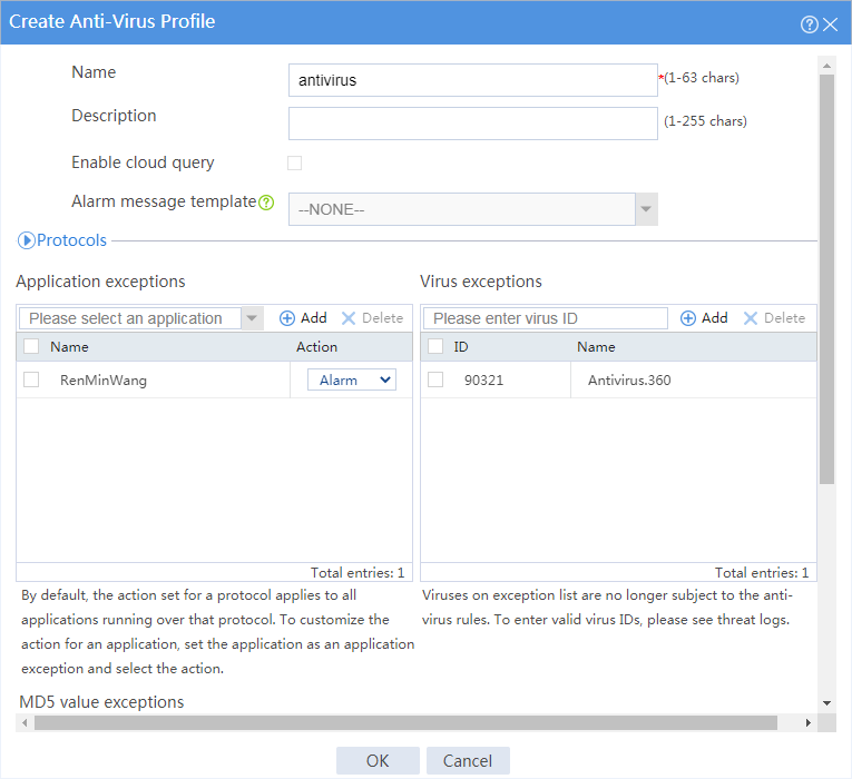

2.     Create an anti-virus profile.
# On the top navigation bar, click Objects.
# From the navigation pane, select APPSecurity > Anti-Virus > Profile.
# Click Create.
# In the dialog box that opens, create an anti-virus profile as shown in Figure 11.
Figure 11 Create an anti-virus profile
# Click OK.

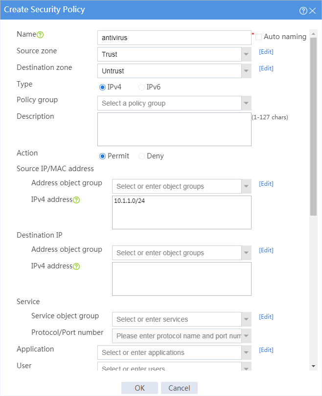

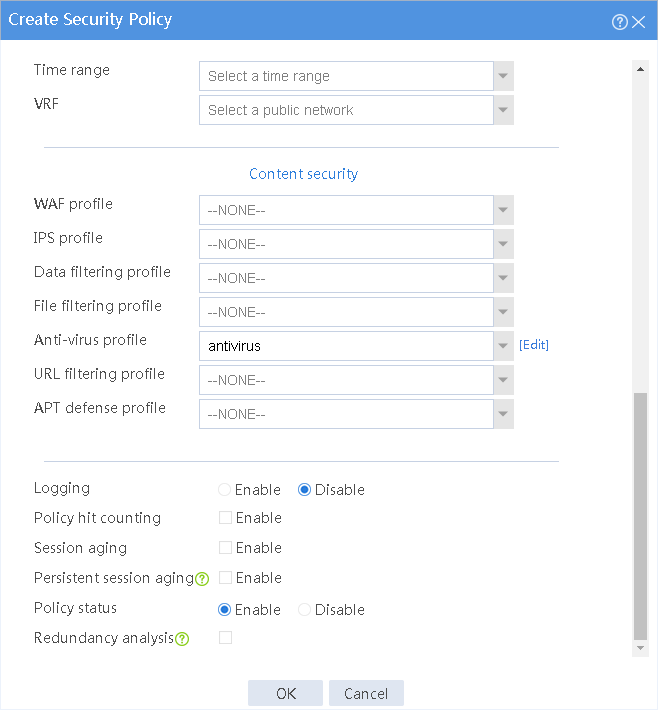

3.     Create a security policy.
# In the dialog box that appears, create a security policy as shown in Figure 12 and Figure 13.
Figure 12 Create basic security policy settings
Figure 13 Configure content security settings
# Click OK.
