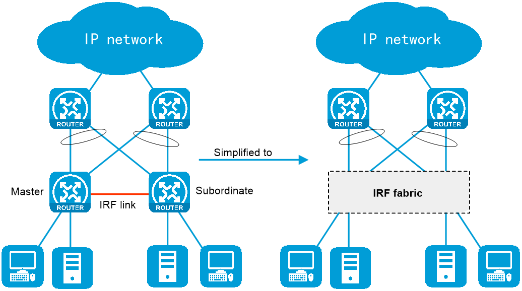

Figure 1 shows an IRF fabric that has two devices, which appear as a single node to the upper-layer and lower-layer devices.
Figure 1 IRF application scenario

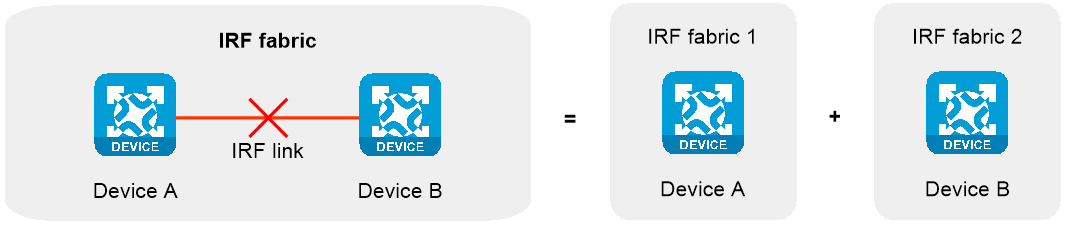

IRF split occurs when an IRF fabric breaks up into two IRF fabrics because of IRF link failures, as shown in Figure 2. The split IRF fabrics operate with the same IP address. IRF split causes routing and forwarding problems on the network.
Figure 2 IRF split

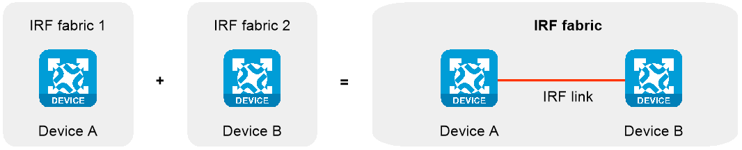

IRF merge occurs when two split IRF fabrics reunite or when two independent IRF fabrics are united, as shown in Figure 3.
Figure 3 IRF merge

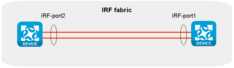

When you connect two neighboring IRF members, follow these restrictions and guidelines:
·     You must connect the physical interfaces of IRF-port 1 on one member to the physical interfaces of IRF-port 2 on the other, as shown in Figure 4.
·     An IRF fabric can only use daisy-chain topology. No intermediate devices are allowed between neighboring IRF member devices.
·     Make sure the two ends of an aggregate IRF link have the same number of IRF physical interfaces and the IRF physical interfaces are the same type.
Figure 4 Connecting IRF physical interfaces
