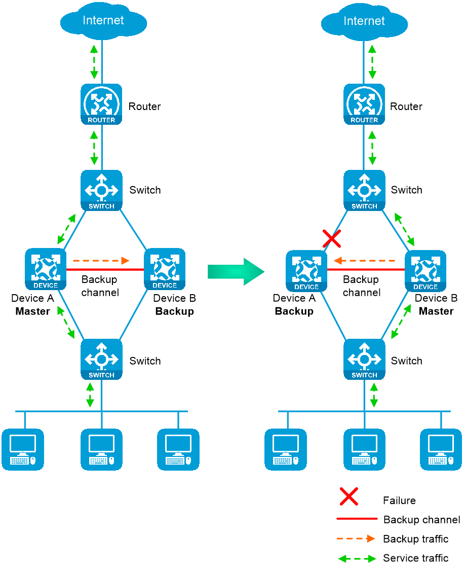

In active/standby mode, one device acts as the master to process services, and the other device stands by as a backup, as shown in Figure 1. When an interface or link on the master fails or when the master fails, the backup takes over the master role to process services.
Figure 1 Active/standby mode of the HA group

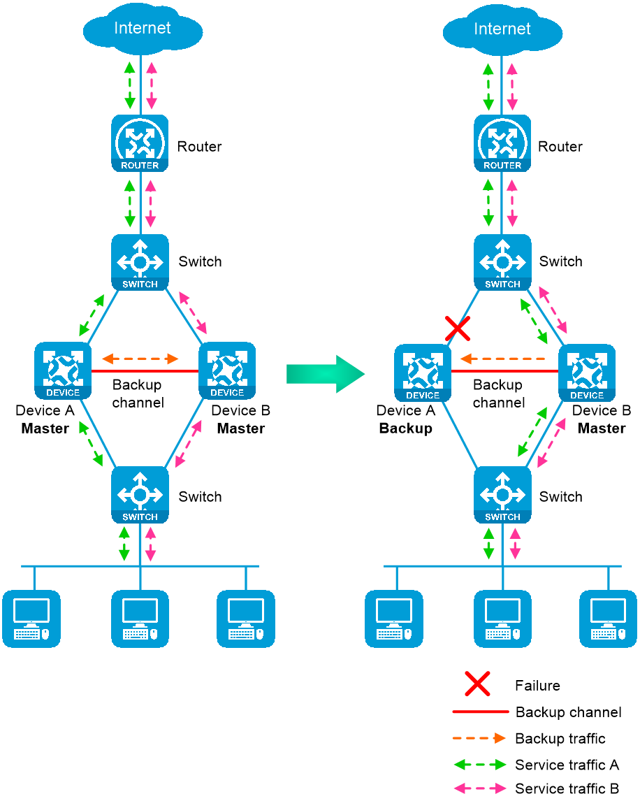

In dual-active mode, both devices process services to increase capability of the HA group, as shown in Figure 2. When one device fails, its traffic is switched to the other device for forwarding.
Figure 2 Dual-active mode of the HA group

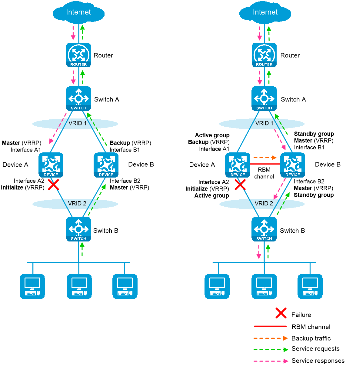

You can use the HA group and VRRP in combination to control master/backup switchover for device role consistency (master or backup) in multiple VRRP groups. This ensures that both inbound and outbound traffic can be switched to the new master for symmetric forwarding upon device failure.
Figure 3 illustrates VRRP association with the HA group in active/standby mode.
·     As shown in the left, VRRP cannot ensure symmetric forwarding upon failure on a device, which causes traffic interruption.
·     As shown in the right, after the HA control channel is established, the HA group determines the roles of the devices in all VRRP groups. The master election mechanism of VRRP no longer takes effect. If the HA control channel is disconnected, the master election mechanism of VRRP takes effect again.
Figure 3 HA group in collaboration with VRRP

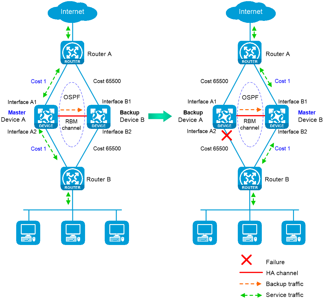

Overview
You can use the HA group to enable the routing protocols on the secondary device to advertise modified link cost. The feature ensures that both inbound and outbound traffic can be switched to the new master for symmetric forwarding.
To use the HA group with routing protocols, you must use track entries to monitor the status of uplink and downlink interfaces for the HA group to perform a primary/secondary member switchover when link or interface failure occurs.
The following information uses OSPF on the HA group in active/standby mode to describe how the HA group collaborates with dynamic routing protocols:
·     As shown in Figure 4, when both Device A (primary) and Device B (secondary) are operating correctly, Device A advertises the original link cost 1, and Device B advertises the link cost 65500, which has been adjusted by the HA group. As a result, Device A forwards all traffic that traverses the HA group.
·     As shown in Figure 4, when downlink Interface A2 of Device A fails, Device A and Device B switch their roles. Then, Device B (primary) advertises the original link cost 1, and Device A (secondary) advertises the adjusted link cost 65500. As a result, Device B forwards all traffic that traverses the HA group.
Figure 4 HA group in collaboration with routing protocols
Mechanism
The HA group adjusts the link costs advertised by dynamic routing protocols by using one of the following methods:
·     Replacing the original link cost with the absolute link cost that you configure.
·     Adding an increment value to the original link cost.
The link cost changes do not affect the HA roles of devices, and you must configure the same link cost adjustment settings on the primary and secondary member devices.

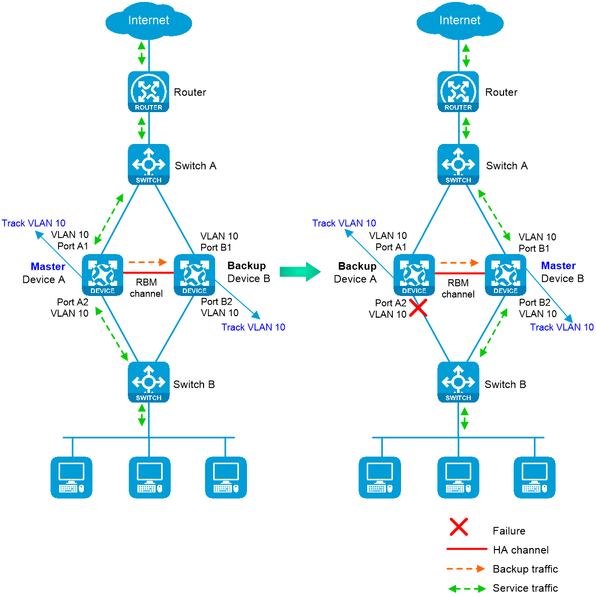

Transparent in-path deployment of the HA group
When you use this networking scheme, you can configure the HA group to monitor interfaces or VLANs to enable collaboration between uplink and downlink interfaces. The monitoring configuration ensures that a group of interfaces have the same status, and uplink and downlink traffic can be switched simultaneously between the member devices.
The following information uses VLAN monitoring as an example to describe how interfaces collaborate:
·     As shown in Figure 5, when both Device A (primary) and Device B (secondary) are operating correctly, tracked VLAN 10 is in active state on Device A and in inactive state on Device B. As a result, Device A forwards all traffic that traverses the HA group.
·     As shown in Figure 5, when downlink Port A2 of Device A fails, Device A and Device B switch their roles. Then, the HA group places VLAN 10 in inactive state on Device A (secondary) and in active state on Device B (primary). As a result, Device B forwards all traffic that traverses the HA group.
Figure 5 Transparent in-path deployment of the HA group
You can use the HA group only with VRRP master/backup mode. VRRP load sharing mode does not support the HA group.
You can configure the HA group to monitor track entries, VLANs, or interfaces, but you cannot configure VLAN monitoring in combination with track entry monitoring or interface monitoring. When you configure the HA group to monitor both track entries and interfaces, make sure the track entries are not associated with the monitored interfaces.

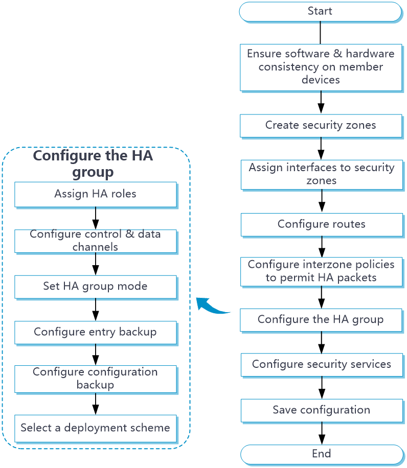

HA group configuration flow
Figure 6 HA group configuration flow chart

Configure the HA group to collaborate with a routing protocol
1.     Click the System tab.
2.     In the navigation pane, select High Availability > HA Group.
The HA Group page opens.
3.     Click Configure.
The Configure HA Group page opens.
4.     Configure routing collaboration parameters. For more information about the related parameters, see Table 3.
Table 5 Routing collaboration parameters
Parameter
Description
OSPF
Adjust the link costs advertised by OSPF.
IS-IS
Adjust the link costs advertised by IS-IS.
BGP
Adjust the link costs advertised by BGP.
OSPFv3
Adjust the link costs advertised by OSPFv3.
Set absolute cost
Enter an absolute link cost. The HA group will use this value to replace the link costs to be advertised.
Set increment cost
Enter an increment value. The HA group will add this value to the link costs to be advertised.
5.     Click OK.
Configure transparent in-path deployment
3.     Click Configure.
4.     Configure monitoring parameters. For more information about the related parameters, see Table 4.
Table 6 Monitoring parameters
Parameter
Description
Interface
Select the interfaces to be monitored by the HA group.
You cannot configure the HA group to monitor aggregation member ports.
The HA group monitors the status of the monitored interfaces to ensure interface status consistency. A monitored interface can forward traffic only when all monitored interfaces are up.
VLAN
Select the VLANs to be monitored by the HA group.
The HA group monitors the member ports of a monitored VLAN to ensure member port status consistency. A port in a monitored VLAN can forward traffic only when all ports in the VLAN are up.
You cannot configure the HA group to monitor VLAN 1. All access ports belong to VLAN 1 by default. If you configure the HA group to monitor VLAN 1, traffic forwarding will be affected on ports in use when an unused port is placed in down state in VLAN 1.
5.     Click OK.
