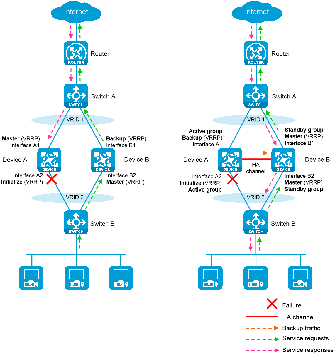

Figure 1 shows a typical VRRP network (on the left) and a network configured with VRRP-HA group association (on the right). Upon a link switchover in the typical VRRP network, traffic might be interrupted if the master in uplink and downlink VRRP groups resides on different devices.
To resolve this issue, you can use HA group to control the master/backup state switchover in different VRRP groups.
Figure 1 Network diagram
VRRP active/standby group
A VRRP active/standby group can be in master or backup state, which determines the state of devices in the associated VRRP groups. For example, if a VRRP active group is in master state, all devices in the associated VRRP groups are masters.
The initial state of a VRRP active/standby group is as follows:
·     Active/Standby mode—On the primary management device, the initial state is master for the VRRP active and standby groups. On the secondary management device, the initial state is backup for the VRRP active and standby groups.
·     Dual-active mode—The state of a VRRP active/standby group is not affected by the HA roles. The initial state is master for the VRRP active group and is backup for the VRRP standby group.
VRRP master election in the HA group environment
In the network configured with VRRP-HA group association as shown in Figure 1, the master/backup state switchover in the VRRP groups is as follows:
1.     Typically, the VRRP active group state is master on Device A (suppose it is the primary device), so Device A is the master in both VRRP group 1 and VRRP group 2. The VRRP standby group state is backup on Device B (suppose it is the secondary device), so Device B is the backup in both VRRP group 1 and VRRP group 2.
2.     When Interface A2 (downlink interface on Device A) fails, the HA group receives an interface failure event. The HA group then notifies Device B of the VRRP active/standby group state change event in an update packet, requesting Device B to change the VRRP standby group state to master.
3.     Upon receiving the update packet, Device B changes the VRRP standby group state to master. Meantime, Device B changes its state to master in VRRP group 1 and VRRP group 2. After the state change, Device B sends a reply to Device A.
4.     Upon receiving the reply, Device A changes the VRRP active group state to backup. Meantime, Device A changes its state to backup in VRRP group 1 and VRRP group 2.
For traffic to switch back when Interface A2 recovers, the devices will perform another master/backup state switchover that is similar to the procedure described above.
