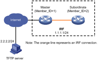

ISSU examples for using issu series commands in IRF mode
HTTP feature upgrade to a compatible version
Upgrade requirements
As shown in Figure 4, the IRF fabric has two members. Each member has one MPU in slot 0 (active MPU) and one MPU in slot 1 (standby MPU).
Upgrade the HTTP feature from R0201 to R0202, which is a compatible version.
Figure 4 Network diagram
Upgrade procedure

HTTP feature upgrade to an incompatible version
As shown in Figure 5, the IRF fabric has two members. Each member has one MPU in slot 0 (active MPU) and one MPU in slot 1 (standby MPU).
Upgrade the HTTP feature from R0201 to R0202, which is an incompatible version.
Figure 5 Network diagram
Upgrade procedure
# Download the image file that contains the R0202 HTTP feature from the TFTP server.
<Sysname> tftp 2.2.2.2 get http-r0202.bin

HTTP feature rollback example
Rollback requirement
As shown in Figure 6, the IRF fabric has two members. Each member has one MPU in slot 0 (active MPU) and one MPU in slot 1 (standby MPU).
Roll back the HTTP feature from R0202 to R0201 after upgrading it from R0201 to R0202. R0202 and R0201 are compatible.
Figure 6 Network diagram
Rollback procedure

ISSU examples for using install series commands in IRF mode
HTTP feature upgrade example
As shown in Figure 8, the IRF fabric has two members. Each member has one MPU in slot 0 (active MPU) and one MPU in slot 1 (standby MPU).
Figure 8 Network diagram
Upgrade procedure
The HTTP feature has been upgraded from R0201 to R0202, but the software change has not been confirmed.
Roll back the HTTP feature from R0202 to R0201.
