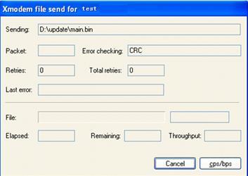

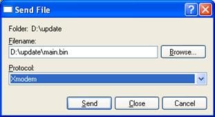

Upgrading Comware software through the console port
You can upgrade the Comware software through the console port or modify the baud rate of the console port from the Serial submenu.
To upgrade the Comware software through the console port from the Serial submenu:
1.     Enter 2 in the EXTENDED-BOOTWARE menu to access the Serial submenu.
===========================<Enter Serial SubMenu>===========================
|Note:the operating device is cfa0                                         |
|<1> Download Image Program To SDRAM And Run                               |
|<2> Update Main Image File                                                |
|<3> Update Backup Image File                                              |
|<4> Update User Private File                                              |
|<5> Modify Serial Interface Parameter                                     |

6.     On the configuration terminal, configure the communication settings and transfer the upgrade file. For more information, see "Using XMODEM to upgrade software through the console port."
In this example, the system sets the file as a main software image file when the file transfer is complete. The following is the sample output:
Waiting ...CCC
Download successfully!
47979456 bytes downloaded!

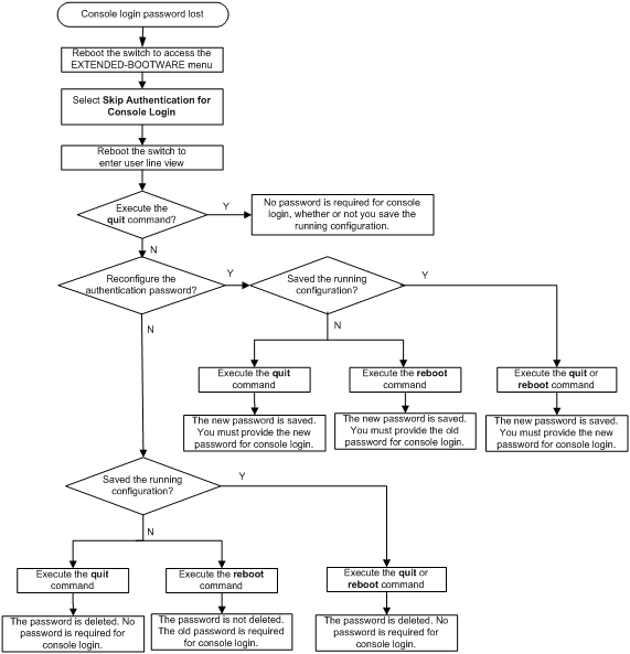

Skipping console login authentication
IMPORTANT:
·     To perform this task, make sure password recovery capability is enabled. If the capability is disabled, you cannot perform this task.
·     Perform this task only when the switch has one MPU. When the switch has two MPUs, you cannot skip console login authentication.
If you cannot remember the console login password, enter 7 in the EXTENDED-BOOTWARE menu, and then enter 1 or 0 in the EXTENDED-BOOTWARE menu. The switch will reboot and load the next-startup configuration file with the console login password ignored.
Enter your choice(0-9): 7
Clear Image Password Success!
After the switch starts up, you can configure a new console login password and save the running configuration so the new password takes effect (see Figure 1). If you do not configure a new console login password, the old password continues to take effect for the subsequent reboot.
Figure 1 Skipping console login authentication
Waiting ...CCC
Updating File cfa0:/test.bin..............................................
..Done!

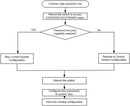

Restoring the factory-default configuration
CAUTION
CAUTION:
Performing this task can cause all next-startup configuration files in the current storage medium to be permanently deleted.
IMPORTANT
IMPORTANT:
Perform this task only when the switch has one MPU. When the switch has two MPUs, you cannot restore the factory-default configuration.
To restore the factory-default configuration from the EXTENDED-BOOTWARE menu, make sure password recovery capability is disabled. If the capability is enabled, you cannot perform the task.
To enable the system to start up with the factory-default configuration instead of a next-startup configuration file:
1.     Enter 5 in the EXTENDED-BOOTWARE menu.
==========================<EXTENDED-BOOTWARE MENU>==========================
|<1> Boot System                                                           |
|<2> Enter Serial SubMenu                                                  |
|<3> Enter Ethernet SubMenu                                                |
|<4> File Control                                                          |
|<5> Restore to Factory Default Configuration                              |
|<6> BootWare Operation Menu                                               |
|<7> Skip Authentication for Console Login                                 |
|<8> Storage Device Operation                                              |
|<0> Reboot                                                                |
Ctrl+Z: Access EXTENDED ASSISTANT MENU
Ctrl+F: Format File System
Enter your choice(0-8):5
2.     Follow the system instruction to complete the task.
¡     If password recovery capability is enabled, first disable the capability from the CLI, and then reboot the device to access the EXTENDED-BOOTWARE menu.
Password recovery capability is enabled. To perform this operation, first
disable the password recovery capability using the undo password-recovery
enable command in CLI.
¡     If password recovery capability is disabled, enter Y at the prompt to complete the task.
Because the password recovery capability is disabled, this operation can
cause the configuration files to be deleted, and the system will start up
with factory defaults. Are you sure to continue?[Y/N]Y
Setting...Done.
IMPORTANT
IMPORTANT:
Enter your choice(0-8): 7
After the switch starts up, you can configure a new console login password and save the running configuration so the new password takes effect (see Figure 2). If you do not configure a new console login password, the old password continues to take effect for the subsequent reboot.
Figure 2 Skipping console login authentication

Disabling password recovery capability (for LST1MRPNC1 MPUs)
Password recovery capability controls console user access to the device configuration and SDRAM from BootWare menus. This feature also decides the method for handling console login password loss (see Figure 3).
If password recovery capability is enabled, a console user can access the device configuration without authentication to configure new passwords.
If password recovery capability is disabled, console users must restore the factory-default configuration before they can configure new passwords. Restoring the factory-default configuration deletes the next-startup configuration files.
To enhance system security, disable password recovery capability.
Figure 3 Handling console login password loss
Table 24 summarizes options whose availability depends on the password recovery capability setting.

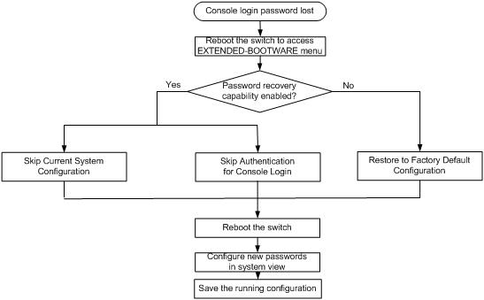

Disabling password recovery capability (for LST1MRPNE1 and LST1MRPNE2 MPUs)
Password recovery capability controls console user access to the device configuration and SDRAM from BootWare menus. This feature also decides the method for handling console login password loss (see Figure 4).
Figure 4 Handling console login password loss
Table 25 summarizes options whose availability depends on the password recovery capability setting.

6.     Select Transfer > Send File in the HyperTerminal window. In the dialog box that appears, click Browse to select the source file, and select Xmodem from the Protocol list. In this example, the file D:\update\main.bin is selected.
Figure 5 File transmission dialog box
7.     Click Send.
The following dialog box appears:
Figure 6 File transfer progress
After the file transfer is complete, the Serial submenu appears again. You can choose other options as required.
