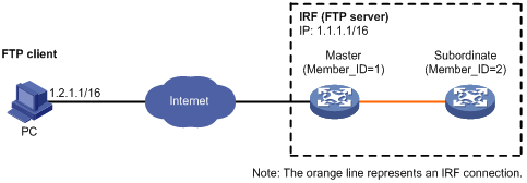

FTP server configuration example in IRF mode
Network requirements
·           Configure the IRF fabric as an FTP server.
·           Create a local user account with username abc and password 123456 on the FTP server.
·           Use the user account to log in to the FTP server from the FTP client.
·           Upload the file temp.bin from the FTP client to the FTP server.
·           Download the configuration file config.cfg from the FTP server to the FTP client for backup.
Figure 3 Network diagram
Configuration procedure
1.      Configure IP addresses as shown in Figure 3. Make sure the IRF fabric and the PC can reach each other. (Details not shown.)
2.      Configure the FTP server:
# Examine the storage space on the member devices. If the free space is insufficient, use the delete/unreserved file-url command to delete unused files. (Details not shown.)
# Create a local user with the username abc and password 123456.
<Sysname> system-view
[Sysname] local-user abc class manage
[Sysname-luser-manage-abc] password simple 123456
# Assign the user role network-admin to the user. Set the working directory to the root directory of the flash memory on the global active MPU. (To set the working directory to the root directory of the flash memory on one of the global standby MPUs, replace flash:/ with, for example, chassis2#slot1#flash:/.)
[Sysname-luser-manage-abc] authorization-attribute user-role network-admin work-directory flash:/
# Assign the service type FTP to the user.
[Sysname-luser-manage-abc] service-type ftp
[Sysname-luser-manage-abc] quit
# Enable the FTP server.
[Sysname] ftp server enable
[Sysname] quit
3.      Perform FTP operations from the FTP client:
