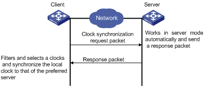

I. Server/client mode
Figure 1-2 Server/client mode

Server/client mode
Configure the local S3100-52P Ethernet switch to work in the NTP client mode. In this mode, the remote server serves as the local time server, while the local switch serves as the client.
