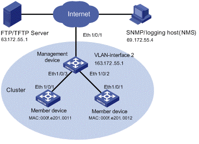

2.1.1  Introduction to HGMP
A cluster contains a group of switches. Through cluster management, you can manage multiple geographically dispersed in a centralized way.
Cluster management is implemented through Huawei Group Management Protocol (HGMP). HGMP version 2 (HGMPv2) is used at present.
A switch in a cluster plays one of the following three roles:
l           Management device
l           Member device
l           Candidate device
A cluster comprises of a management device and multiple member devices. To manage the devices in a cluster, you need only to configure an external IP address for the management switch. Cluster management enables you to configure and manage remote devices in batches, reducing the workload of the network configuration. Normally, there is no need to configure external IP addresses for member devices.
Figure 2-1 illustrates a cluster implementation.
Figure 2-1 A cluster implementation
HGMP V2 has the following advantages:
l           It eases the configuration and management of multiple switches: You just need to configure a public IP address for the management device instead of for all the devices in the cluster; and then you can configure and manage all the member devices through the management device without the need to log onto them one by one.
l           It provides the topology discovery and display function, which assists in monitoring and maintaining the network.
l           It allows you to configure and upgrade multiple switches at the same time.
l           It enables you to manage your remotely devices conveniently regardless of network topology and physical distance.
l           It saves IP address resource.

Configuring inside-outside interaction for a cluster
Optional

VIII. Configuring inside-outside interaction for a cluster
Follow these steps to configure inside-outside interaction for a cluster:
To do…
Use the command…
Remarks
Enter system view
Enter cluster view
cluster
Required
Configure a shared FTP server for the cluster
ftp-server ip-address
Optional
By default, the management device acts as the shared FTP server.
Configure a shared TFTP server for the cluster
tftp-server ip-address
Optional
By default, no shared TFTP server is configured.
Configure a shared logging host for the cluster
logging-host ip-address
Optional
By default, no shared logging host is configured.
Configure a shared SNMP host for the cluster
snmp-host ip-address
Optional
By default, no shared SNMP host is configured.

2.4.1  Basic Cluster Configuration Example
I. Network requirements
Three switches compose a cluster, where:
l           An S3100-52P switch serves as the management device.
l           The rest are member devices.
Serving as the management device, the S3100-52P switch manages the two member devices. The configuration for the cluster is as follows:
l           The two member devices connect to the management device through Ethernet 1/0/2 and Ethernet 1/0/3.
l           The management device connects to the Internet through Ethernet 1/0/1.
l           Ethernet 1/0/1 belongs to VLAN 2, whose interface IP address is 163.172.55.1.
l           All the devices in the cluster share the same FTP server and TFTP server.
l           The FTP server and TFTP server use the same IP address: 63.172.55.1.
l           The NMS and logging host use the same IP address: 69.172.55.4.
II. Network diagram
Figure 2-4 Network diagram for HGMP cluster configuration
III. Configuration procedure
1)         Configure the member devices (taking one member as an example)
# Enable NDP globally and on Ethernet 1/0/1.
<Sysname> system-view
[Sysname] ndp enable
[Sysname] interface Ethernet 1/0/1
[Sysname-Ethernet1/0/1] ndp enable
[Sysname-Ethernet1/0/1] quit
# Enable NTDP globally and on Ethernet 1/0/1.
[Sysname] ntdp enable
[Sysname-Ethernet1/0/1] ntdp enable
# Enable the cluster function.
[Sysname] cluster enable
2)         Configure the management device
# Add port Ethernet 1/0/1 to VLAN 2.
[Sysname] vlan 2
[Sysname-vlan2] port Ethernet 1/0/1
[Sysname-vlan2] quit
# Disable NDP and NTDP on the uplink port Ethernet 1/0/1.
[Sysname] undo ndp enable interface Ethernet 1/0/1
[Sysname-Ethernet1/0/1] undo ntdp enable
# Configure VLAN 2 as the management VLAN, Create VLAN-interface 2 and configure the IP address of VLAN-interface 2 as 163.172.55.1.
[Sysname] management-vlan 2
[Sysname] interface Vlan-interface 2
[Sysname-Vlan-interface2] ip address 163.172.55.1 255.255.255.0
[Sysname-Vlan-interface2] quit
# Enable NDP on Ethernet 1/0/2 and Ethernet 1/0/3.
[Sysname] interface Ethernet 1/0/2
[Sysname-Ethernet1/0/2] ndp enable
[Sysname-Ethernet1/0/2] quit
[Sysname] interface Ethernet 1/0/3
[Sysname-Ethernet1/0/3] ndp enable
[Sysname-Ethernet1/0/3] quit
# Set the hold time of NDP information to 200 seconds.
[Sysname] ndp timer aging 200
# Set the interval between sending NDP packets to 70 seconds.
[Sysname] ndp timer hello 70
# Enable NTDP globally and on Ethernet 1/0/2 and Ethernet 1/0/3.
[Sysname-Ethernet1/0/2] ntdp enable
[Sysname-Ethernet1/0/3] ntdp enable
 # Set the topology collection range to 2 hops.
[Sysname] ntdp hop 2
# Set the delay for a member device to forward topology collection requests to 150 ms.
[Sysname] ntdp timer hop-delay 150
# Set the delay for a member device port to forward topology collection requests to 15 ms.
[Sysname] ntdp timer port-delay 15
# Set the interval between collecting topology information to 3 minutes.
[Sysname] ntdp timer 3
# Enter cluster view.
[Sysname] cluster
[Sysname-cluster]
# Configure a private IP address pool for the cluster. The IP address pool contains six IP addresses, starting from 172.16.0.1.
[Sysname-cluster] ip-pool 172.16.0.1 255.255.255.248
# Name and build the cluster.
[Sysname-cluster] build aaa
[aaa_0.Sysname-cluster]
# Add the attached two switches to the cluster.
[aaa_0.Sysname-cluster] add-member 1 mac-address 000f-e201-0011
[aaa_0.Sysname-cluster] add-member 17 mac-address 000f-e201-0012
# Set the holdtime of member device information to 100 seconds.
[aaa_0.Sysname-cluster] holdtime 100
# Set the interval between sending handshake packets to 10 seconds.
[aaa_0.Sysname-cluster] timer 10
# Configure the shared FTP server, TFTP server, logging host and SNMP host for the cluster.
[aaa_0.Sysname-cluster] ftp-server 63.172.55.1
[aaa_0.Sysname-cluster] tftp-server 63.172.55.1
[aaa_0.Sysname-cluster] logging-host 69.172.55.4
[aaa_0.Sysname-cluster] snmp-host 69.172.55.4
