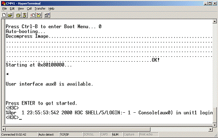

3)         Turn on the switch. You will be prompted to press the Enter key if the switch successfully completes POST (power-on self test). The prompt (such as <H3C>) appears after you press the Enter key, as shown in Figure 2-5.
Figure 2-5 HyperTerminal CLI
4)         You can then configure the switch or check the information about the switch by executing the corresponding commands. You can also acquire help by typing the ? character. Refer to related parts in this manual for information about the commands used for configuring the switch.

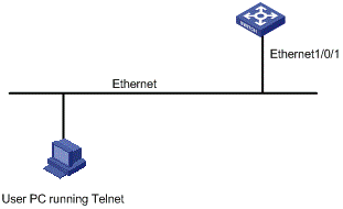

II. Network diagram
Figure 2-6  Network diagram for AUX user interface configuration (with the authentication mode being none)

II. Network diagram
Figure 2-7 Network diagram for AUX user interface configuration (with the authentication mode being password)

II. Network diagram
Figure 2-8 Network diagram for AUX user interface configuration (with the authentication mode being scheme)

3.2.2  Configuration Example
I. Network requirements
Assume current user logins through the console port, and the current user level is set to the administrator level (level 3). Perform the following configurations for users logging in through VTY 0 using Telnet.
l           Do not authenticate the users.
l           Commands of level 2 are available to the users.
l           Telnet protocol is supported.
l           The screen can contain up to 30 lines.
l           The history command buffer can contain up to 20 commands.
l           The timeout time of VTY 0 is 6 minutes.
II. Network diagram
Figure 3-1 Network diagram for Telnet configuration (with the authentication mode being none)
III. Configuration procedure
# Enter system view.
<Sysname> system-view
# Enter VTY 0 user interface view.
[Sysname] user-interface vty 0
# Configure not to authenticate Telnet users logging in to VTY 0.
[Sysname-ui-vty0] authentication-mode none
# Specify commands of level 2 are available to users logging in to VTY 0.
[Sysname-ui-vty0] user privilege level 2
# Configure Telnet protocol is supported.
[Sysname-ui-vty0] protocol inbound telnet
# Set the maximum number of lines the screen can contain to 30.
[Sysname-ui-vty0] screen-length 30
# Set the maximum number of commands the history command buffer can store to 20.
[Sysname-ui-vty0] history-command max-size 20
# Set the timeout time to 6 minutes.
[Sysname-ui-vty0] idle-timeout 6

II. Network diagram
Figure 3-2 Network diagram for Telnet configuration (with the authentication mode being password)
# Configure to authenticate users logging in to VTY 0 using the password.
[Sysname-ui-vty0] authentication-mode password
# Set the local password to 123456 (in plain text).
[Sysname-ui-vty0] set authentication password simple 123456

II. Network diagram
Figure 3-3 Network diagram for Telnet configuration (with the authentication mode being scheme)

l           Launch a terminal emulation utility (such as Terminal in Windows 3.X or HyperTerminal in Windows 95/Windows 98/Windows NT/Windows 2000/Windows XP) on the PC terminal, with the baud rate set to 9,600 bps, data bits set to 8, parity check set to none, and flow control set to none.
l           Turn on the switch and press Enter as prompted. The prompt (such as <H3C>) appears, as shown in the following figure.
Figure 3-5 The terminal window

8.2.5  Configuration Example
Only the Telnet users sourced from the IP address of 10.110.100.52 are permitted to access the switch.
II. Network diagram
Figure 8-1 Network diagram for controlling Telnet users using ACLs
# Define a basic ACL.
[Sysname] acl number 2000
[Sysname-acl-basic-2000] rule 1 permit source 10.110.100.52 0
[Sysname-acl-basic-2000] quit
# Apply the ACL.
[Sysname] user-interface vty 0 4
[Sysname-ui-vty0-4] acl 2000 inbound
