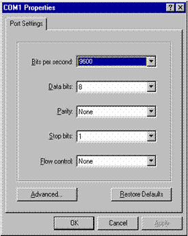

Table 2-1 lists the default settings of a Console port.
Table 2-1 The default settings of a Console port
Setting
Default
Baud rate
9,600 bps
Flow control
None
Check mode (Parity)
None
Stop bits
1
Data bits
8

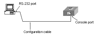

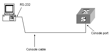

1)         Connect the serial port of your PC/terminal to the Console port of the switch, as shown in Figure 2-1.
Figure 2-1 Diagram for setting the connection to the Console port

Figure 2-4 Set port parameters

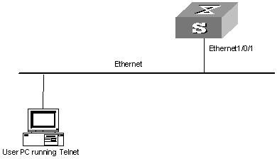

2.4.2  Configuration Example
I. Network requirements
Assume the switch is configured to allow you to login through Telnet, and your user level is set to the administrator level (level 3). After you telnet to the switch, you need to limit the console user at the following aspects.
l           Do not authenticate users logging in through the Console port.
l           Commands of level 2 are available to users logging into the AUX user interface.
l           The baud rate of the Console port is 19,200 bps.
l           The screen can contain up to 30 lines.
l           The history command buffer can contain up to 20 commands.
l           The timeout time of the AUX user interface is 6 minutes.

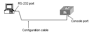

II. Network diagram
Figure 2-5  Network diagram for AUX user interface configuration (with the authentication mode being none)
III. Configuration procedure

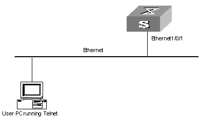

2.5.2  Configuration Example
l           Authenticate users logging in through the Console port using the local password.
l           Set the local password to 123456 (in plain text).
l           The commands of level 2 are available to users logging into the AUX user interface.
l           The history command buffer can store up to 20 commands.
II. Network diagram
Figure 2-6 Network diagram for AUX user interface configuration (with the authentication mode being password)

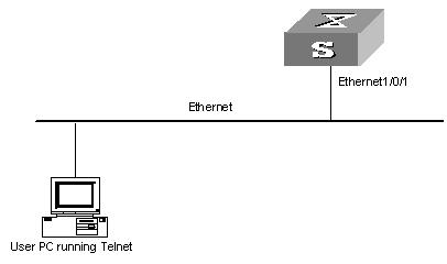

2.6.2  Configuration Example
l           Configure the name of the local user to be “guest”.
l           Set the authentication password of the local user to 123456 (in plain text).
l           Set the service type of the local user to Terminal.
l           Configure to authenticate users logging in through the Console port in the scheme mode.
II. Network diagram
Figure 2-7 Network diagram for AUX user interface configuration (with the authentication mode being scheme)

3.2.2  Configuration Example
Assume the switch is configured to allow you to login through Console, and your user level is set to the administrator level (level 3). After you login through Console, you need to limit the telnet user into VTY 0 at the following aspects.
l           Do not authenticate users logging into VTY 0.
l           Commands of level 2 are available to users logging into VTY 0.
l           Telnet protocol is supported.
l           The timeout time of VTY 0 is 6 minutes.
II. Network diagram
Figure 3-1 Network diagram for Telnet configuration (with the authentication mode being none)

3.3.2  Configuration Example
l           Authenticate users logging into VTY 0 using the local password.
II. Network diagram
Figure 3-2 Network diagram for Telnet configuration (with the authentication mode being password)

3.4.2  Configuration Example
l           Set the service type of VTY users to Telnet.
l           Configure to authenticate users logging into VTY 0 in scheme mode.
l           The commands of level 2 are available to users logging into VTY 0.
l           Only Telnet protocol is supported in VTY 0.
II. Network diagram
Figure 3-3 Network diagram for Telnet configuration (with the authentication mode being scheme)
# Enter system view.
<H3C> system-view
# Create a local user named “guest” and enter local user view.
[H3C] local-user guest
# Set the authentication password of the local user to 123456 (in plain text).
[H3C-luser-guest] password simple 123456
# Set the service type to Telnet, Specify commands of level 2 are available to users logging into VTY 0..
[H3C-luser-guest] service-type telnet level 2
[H3C-luser-guest] quit
# Enter VTY 0 user interface view.
[H3C] user-interface vty 0
# Configure to authenticate users logging into VTY 0 in the scheme mode.
[H3C-ui-vty0] authentication-mode scheme
# Set the command level available to the users logging into the AUX user interface to 2.
[H3C-ui-aux0] user privilege level 2
# Configure Telnet protocol is supported.
[H3C-ui-vty0] protocol inbound telnet
# Set the maximum number of lines the screen can contain to 30.
[H3C-ui-vty0] screen-length 30
# Set the maximum number of commands the history command buffer can store to 20.
[H3C-ui-vty0] history-command max-size 20
# Set the timeout time to 6 minutes.
[H3C-ui-vty0] idle-timeout 6

1)         Assign an IP address to the interface of the management VLAN of a switch. This can be achieved by executing the ip address command in VLAN interface view after you log in through the Console port.
l           Connect the serial port of your PC/terminal to the Console port of the switch, as shown in Figure 3-4
Figure 3-4 Diagram for establishing connection to a Console port
l           Launch a terminal emulation utility (such as Terminal in Windows 3.X or HyperTerminal in Windows 9X) on the PC, with the baud rate set to 9,600 bps, data bits set to 8, parity check set to none, and flow control set to none.
l           Turn on the switch and press Enter as prompted. The prompt (such as <H3C>) appears, as shown in the following figure.

2)         Perform Telnet-related configuration on the switch. Refer to section 3.2  "Telnet Configuration with Authentication Mode Being None”, section 3.3  “Telnet Configuration with Authentication Mode Being Password”, and section 3.4  “Telnet Configuration with Authentication Mode Being Scheme” for more.
3)         Connect your PC/terminal and the Switch to an Ethernet, as shown in Figure 3-6. Make sure the port through which the switch is connected to the Ethernet belongs to the management VLAN and the route between your PC and the management VLAN interface is reachable.
Figure 3-6 Network diagram for Telnet connection establishment
4)         Launch Telnet on your PC, with the IP address of the management VLAN interface of the switch as the parameter, as shown in Figure 3-7.
Figure 3-7 Launch Telnet
5)         Enter the password when the Telnet window displays “Login authentication” and prompts for login password. The CLI prompt (such as <H3C>) appears if the password is correct. If all VTY user interfaces of the switch are in use, you will fail to establish the connection and receive the message that says “All user interfaces are used, please try later!”. A H3C series Ethernet switch can accommodate up to five Telnet connections at same time.
6)         After successfully Telneting to a switch, you can configure the switch or display the information about the switch by executing corresponding commands. You can also type ? at any time for help. Refer to the following chapters for the information about the commands.
&  Note:
l      A Telnet connection is terminated if you delete or modify the IP address of the VLAN interface in the Telnet session.
l      By default, commands of level 0 are available to Telnet users authenticated by password. Refer to section 1.2 “Command Hierarchy/Command View” in CLI module for information about command hierarchy.
3.5.2  Telneting to another Switch from the Current Switch
You can Telnet to another switch from the current switch. In this case, the current switch operates as the client, and the other operates as the server. If the interconnected Ethernet ports of the two switches are in the same LAN segment, make sure the IP addresses of the two management VLAN interfaces to which the two Ethernet ports belong to are of the same network segment, or the route between the two VLAN interfaces is available.
As shown in Figure 3-8, after Telneting to a switch (labeled as Telnet client), you can Telnet to another switch (labeled as Telnet server) by executing the telnet command and then configure it.
Figure 3-8 Network diagram for Telneting to another switch from the current switch
1)         Perform Telnet-related configuration on the switch operating as the Telnet server. Refer to section 3.2  "Telnet Configuration with Authentication Mode Being None”, section 3.3  “Telnet Configuration with Authentication Mode Being Password”, and section 3.4  “Telnet Configuration with Authentication Mode Being Scheme” for more.
2)         Telnet to the switch operating as the Telnet client.
3)         Execute the following command on the switch operating as the Telnet client:
<H3C> telnet xxxx
Where xxxx is the IP address or the host name of the switch operating as the Telnet server. You can use the ip host to assign a host name to a switch.
4)         Enter the password. If the password is correct, the CLI prompt (such as <H3C>) appears. If all VTY user interfaces of the switch are in use, you will fail to establish the connection and receive the message that says “All user interfaces are used, please try later!”.
5)         After successfully Telneting to the switch, you can configure the switch or display the information about the switch by executing corresponding commands. You can also type ? at any time for help. Refer to the following chapters for the information about the commands.

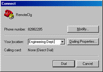

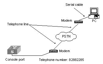

3)         Connect your PC, the modems, and the switch, as shown in the following figure.
Figure 4-1 Establish the connection by using modems
4)         Launch a terminal emulation utility on the PC and set the telephone number to call the modem directly connected to the switch, as shown in Figure 4-2 and Figure 4-3. Note that you need to set the telephone number to that of the modem directly connected to the switch.
Figure 4-2 Set the telephone number
Figure 4-3 Call the modem
5)         Provide the password when prompted. If the password is correct, the prompt (such as <H3C>) appears. You can then configure or manage the switch. You can also enter the character ? at anytime for help. Refer to the following chapters for information about the configuration commands.

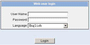

3)         Establish an HTTP connection between your PC and the switch, as shown in the following figure.
Figure 5-1 Establish an HTTP connection between your PC and the switch
4)         Log into the switch through IE. Launch IE on the Web-based network management terminal (your PC) and enter the IP address of the management VLAN interface of the switch (here it is http://10.153.17.82) in the address bar. (Make sure the route between the Web-based network management terminal and the switch is available.)
5)         When the login interface (as shown in Figure 5-2) appears, enter the user name and the password configured in step 2 and click <Login> to bring up the main page of the Web-based network management system.
Figure 5-2 The login page of the Web-based network management system

8.2.5  Configuration Example
Only the Telnet users sourced from the IP address of 10.110.100.52 and 10.110.100.46 are permitted to log into the switch.
II. Network diagram
Figure 8-1 Network diagram for controlling Telnet users using ACLs
# Define a basic ACL.
<H3C> system-view
[H3C] acl number 2000 match-order config
[H3C-acl-basic-2000] rule 1 permit source 10.110.100.52 0
[H3C-acl-basic-2000] rule 2 permit source 10.110.100.46 0
[H3C-acl-basic-2000] rule 3 deny source any
[H3C-acl-basic-2000] quit
# Apply the ACL.
[H3C] user-interface vty 0 4
[H3C-ui-vty0-4] acl 2000 inbound

8.3.3  Configuration Example
Only SNMP users sourced from the IP addresses of 10.110.100.52 and 10.110.100.46 are permitted to access the switch.
II. Network diagram
Figure 8-2 Network diagram for controlling SNMP users using ACLs
<H3C> system-view
# Apply the ACL to only permit SNMP users sourced from the IP addresses of 10.110.100.52 and 10.110.100.46 to access the switch.
[H3C] snmp-agent community read aaa acl 2000
[H3C] snmp-agent group v2c groupa acl 2000
[H3C] snmp-agent usm-user v2c usera groupa acl 2000

8.4.4  Configuration Example
Only the users sourced from the IP address of 10.110.100.46 are permitted to access the switch.
II. Network diagram
Figure 8-3 Network diagram for controlling Web users using ACLs
<H3C> system-view
[H3C] acl number 2030 match-order config
[H3C-acl-basic-2030] rule 1 permit source 10.110.100.46 0
[H3C-acl-basic-2030] rule 2 deny source any
# Apply the ACL to only permit the Web users sourced from the IP address of 10.110.100.46 to access the switch.
