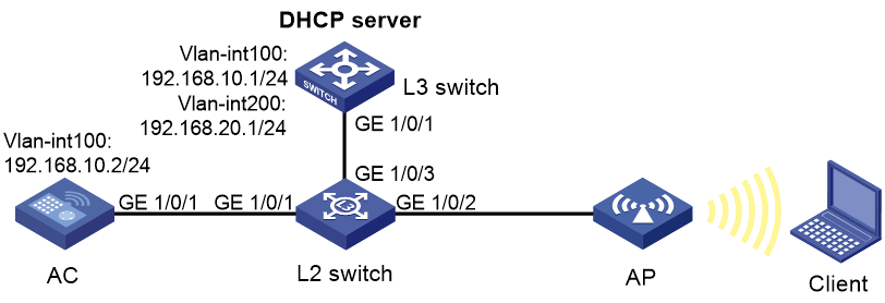

As shown in Figure 1, the AC connects to the Layer 2 switch and the Layer 3 switch acts as a DHCP server to assign IP addresses to the AP and the client.
Configure network settings to meet the following requirements:
·     The client accesses the WLAN over VLAN 200.
·     The AC and the AP communicate with each other over VLAN 100.
·     The Layer 2 switch supplies power to the AP through PoE.
·     The AP provides WLAN access services only from 8:00 to 20:00 every day.
Figure 1 Network diagram
Analysis
·     For the Layer 3 switch to act as a DHCP server, enable the DHCP server feature on the switch.
·     For the Layer 2 switch to supply power to the AP, enable the PoE feature on the switch.
·     Create two schedules to enable and disable the WLAN service template on the AC at specific time points.

 dhcp enable
vlan 1
vlan 100
vlan 200
dhcp server ip-pool 1
 gateway-list 192.168.10.1
 network 192.168.10.0 mask 255.255.255.0
 forbidden-ip 192.168.10.2
dhcp server ip-pool 2
 gateway-list 192.168.20.1
 network 192.168.20.0 mask 255.255.255.0
 dns-list 192.168.20.1
interface Vlan-interface100
 ip address 192.168.10.1 255.255.255.0
interface Vlan-interface200
 ip address 192.168.20.1 255.255.255.0
 port link-type trunk
 undo port trunk permit vlan 1
 port trunk permit vlan 100 200
·     AC
vlan 100
vlan 200
wlan service-template 1
 ssid service1
 client forwarding-location ac
akm mode psk
 preshared-key pass-phrase cipher $c$3$oLf6pOZ6bxrf25nodjOJKYEfnZ6g6ErccHyQ
 cipher-suite ccmp
 security-ie rsn
 service-template enable
 ip address 192.168.10.2 255.255.255.0
scheduler job officeap_service_disable
 command 1 system-view
 command 2 wlan service-template 1
 command 3 undo service-template enable
 command 4 quit
scheduler job officeap_service_enable
 command 3 service-template enable
 command 4 quit
scheduler schedule officeap_service_disable
 user-role network-operator
 user-role network-admin
 time repeating at 20:00
scheduler schedule officeap_service_enable
 time repeating at 08:00
wlan ap-group group1
 ap officeap
 ap-model WA6320
  radio 1
   radio enable
   service-template 1 vlan 200
  radio 2
wlan ap officeap model WA6320
 serial-id 209801A28N819CE0002T
·     L2 switch
vlan 100
vlan 200
 port link-type access
 port access vlan 100
 poe enable
