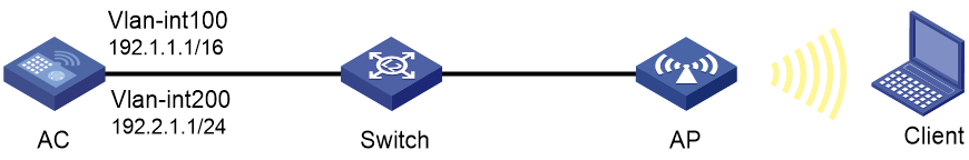

As shown in Figure 1, the switch acts as a DHCP server to assign IP addresses to the AP and the client. Perform the following tasks:
·     Configure PSK on the AC to enable the client to use PSK for encryption.
·     Configure open system authentication and bypass authentication so that the client can access the WLAN without being authenticated.
·     Configure PSK as the authentication and key management (AKM) mode.
·     Set the cipher suite to CCMP.
·     Set the security IE to RSN.
·     Set the security mode to WPA3-SAE.
Figure 1 Network diagram
When you configure PSK encryption with the WPA3-SAE security mode, follow these restrictions and guidelines:
