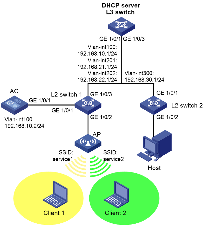

Example: Binding service templates with different SSIDs to radios
As shown in Figure 1, the AC connects to Layer 2 switch 1 and the Layer 3 switch acts as a DHCP server to assign IP addresses to the AP, the host, and the clients. Radio 1 and radio 2 of the AP operates at 5GHz band and 2.4 GHz band, respectively.
Configure network settings to meet the following requirements:
·     Client 1 accesses WLAN service1 over VLAN 201.
·     Client 2 accesses WLAN service2 over VLAN 202.
·     The host accesses the network over VLAN 300.
·     The AC and the AP communicate with each other over VLAN 100.
·     Layer 2 switch 1 supplies power to the AP through PoE.
Figure 1 Network diagram
Analysis
·     For the Layer 3 switch to act as a DHCP server, enable the DHCP server feature on the switch.
·     For Layer 2 switch 1 to supply power to the AP, enable the PoE feature on the switch.
·     For the clients to ping the host through different WLANs, configure service templates with different SSIDs on the AC.
When you configure a serial ID for the AP, use the serial ID labeled on the AP's rear panel.

# Use the display wlan ap all command to view AP information on the AC. If the AP has connected to the AC, the state of the AP is R/M.
<AC> display wlan ap all
Total number of APs: 1
Total number of connected APs: 1
Total number of connected manual APs: 1
Total number of connected auto APs: 0
Total number of connected common APs: 1
Total number of connected WTUs: 0
Total number of inside APs: 0
Maximum supported APs: 3072
Remaining APs: 3071
Total AP licenses: 512
Local AP licenses: 512
Server AP licenses: 0
Remaining local AP licenses: 511
Sync AP licenses: 0
                                 AP information
 State : I = Idle,      J  = Join,       JA = JoinAck,    IL = ImageLoad
         C = Config,    DC = DataCheck,  R  = Run,   M = Master,  B = Backup
AP name                APID   State   Model             Serial ID
officeap               1      R/M     WA6320            219801A28N819CE0002T
# Use the display wlan client command to view client information on the AC. Client 1 has connected to radio 1 of the AP and Client 2 has connected to radio 2 of the AP.
<AC> display wlan client
Total number of clients: 2
MAC address    User name            AP name               R IP address      VLAN
109a-dd9d-fc68 N/A                  officeap              1 192.168.21.2    201
109a-dd9d-fc69 N/A                  officeap              2 192.168.22.2    202
# After Client 1 obtains IP address 192.168.21.2 from the DHCP server, the host and Client 1 can ping each other successfully.
C:\Users\system32>ping 192.168.21.2 -t
Pinging 192.168.21.2 with 32 bytes of data:
Reply from 192.168.21.2: bytes=32 time=8ms TTL=255
Reply from 192.168.21.2: bytes=32 time<1ms TTL=255
Ping statistics for 192.168.21.2:
    Packets: Sent = 11, Received = 11, Lost = 0 (0% loss),
    Minimum = 0ms, Maximum = 8ms, Average = 0ms
Control-C
^C
C:\Users\system32>
Configuration files
·     L3 switch
 dhcp enable
vlan 1
vlan 100
vlan 201
vlan 202
vlan 300
dhcp server ip-pool 1
 gateway-list 192.168.10.1
 network 192.168.10.0 mask 255.255.255.0
 forbidden-ip 192.168.10.2
dhcp server ip-pool 2
 gateway-list 192.168.21.1
 network 192.168.21.0 mask 255.255.255.0
 dns-list 192.168.21.1
dhcp server ip-pool 3
 gateway-list 192.168.22.1
 network 192.168.22.0 mask 255.255.255.0
 dns-list 192.168.22.1
dhcp server ip-pool 4
 gateway-list 192.168.30.1
 network 192.168.30.0 mask 255.255.255.0
 dns-list 192.168.30.1
interface Vlan-interface100
 ip address 192.168.10.1 255.255.255.0
interface Vlan-interface200
 ip address 192.168.20.1 255.255.255.0
interface Vlan-interface300
 ip address 192.168.30.1 255.255.255.0
 port link-type trunk
 undo port trunk permit vlan 1
 port trunk permit vlan 100 201 202
 port trunk permit vlan 300
·     AC
vlan 100
vlan 201
vlan 202
wlan service-template 1
ssid service1
 client forwarding-location ac
 akm mode psk
 preshared-key pass-phrase cipher $c$3$EGdeMZ4taNF5ifpRCaOKOoDAjSMh+WKIhH3+
 cipher-suite ccmp
 security-ie rsn
 service-template enable
wlan service-template 2
ssid service2
 akm mode psk
 preshared-key pass-phrase cipher $c$3$s/vZYild4fsFquikaZVkEJGR5qdDX/50oME5
 cipher-suite ccmp
 security-ie rsn
 ip address 192.168.10.2 255.255.255.0
wlan ap-group group1
 vlan 1
 ap officeap
 ap-model WA6320
  radio 1
   radio enable
   service-template 1 vlan 201
radio 2
   radio enable
   service-template 2 vlan 202
  gigabitethernet 1
wlan ap officeap model WA6320
 serial-id 219801A28N819CE0002T
·     L2 switch 1
vlan 100
vlan 201
vlan 202
 port link-type access
 port access vlan 100
 poe enable
·     L2 switch 2
vlan 300
 port access vlan 300
 poe enable
