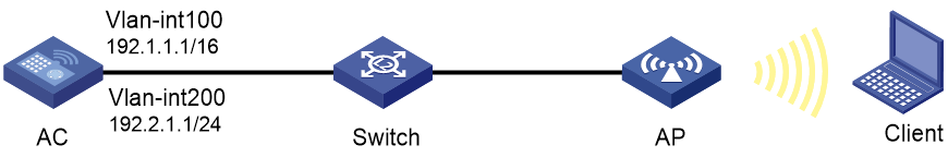

As shown in Figure 1, the switch acts as a DHCP server to assign IP addresses to the AP and the client. Configure WEP on the AC to enable the client to use WEP for encryption.
Figure 1 Network diagram
