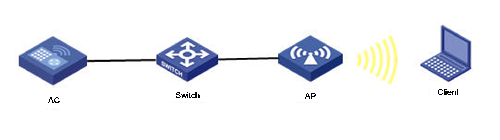

As shown in Figure 1, the AP connects to the AC through a Layer 2 switch and the Layer 2 switch supplies power to the AP through PoE. The AC acts as a DHCP server to assign IP addresses to the AP and the client.
Configure a schedule to enable radio 1 on the AP at 8:00 and disable the radio at 20:00 every day.
Figure 1 Network diagram

Configuring the Layer 2 switch
# Create VLAN 100 and VLAN 200. The switch will use VLAN 100 to forward CAPWAP tunnel traffic and use VLAN 200 for client access.
<L2 switch> system-view
[L2 switch] vlan 100
[L2 switch-vlan100] quit
[L2 switch] vlan 200
[L2 switch-vlan200] quit
# Set the link type of GigabitEthernet 1/0/1 that connects the switch to the AC to trunk and assign the port to VLANs 100 and 200.
[L2 switch] interface gigabitEthernet 1/0/1
[L2 switch-GigabitEthernet1/0/1] port link-type trunk
[L2 switch-GigabitEthernet1/0/1] port trunk permit vlan 100 200
[L2 switch-GigabitEthernet1/0/1] quit
# Set the link type of GigabitEthernet 1/0/2 that connects the switch to the AP to trunk. Remove the port from VLAN 1, assign the port to VLAN 100, and enable PoE.
[L2 switch] interface gigabitEthernet 1/0/2
[L2 switch-GigabitEthernet1/0/2] port link-type trunk
[L2 switch-GigabitEthernet1/0/2] undo port trunk permit vlan 1
[L2 switch-GigabitEthernet1/0/2] port trunk permit vlan 100
[L2 switch-GigabitEthernet1/0/2] port trunk pvid vlan 100
[L2 switch-GigabitEthernet1/0/2] poe enable
[L2 switch-GigabitEthernet1/0/2] quit
