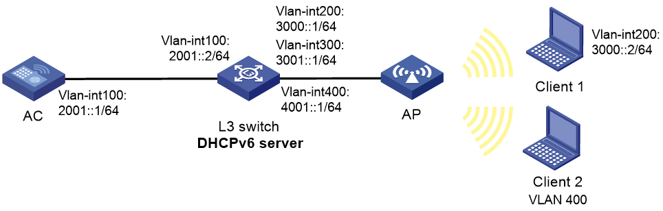

Example: Configuring IPv6 WLAN access
As shown in Figure 1, the Layer 3 switch acts as a DHCP server to assign IPv6 addresses to the AP and Client 1 and assign an IPv6 prefix to Client 2. Configure wireless services to ensure that the WLAN uses IPv6 addresses and Client 1 and Client 2 can access the WLAN. Assume that centralized forwarding is used in this example.
Figure 1 Network diagram

ipv6 dhcp pool 1
 network 3000::0/64
 gateway-list 3000::1
ipv6 dhcp pool 2
 network 3001::0/64
 gateway-list 3001::1
 option 52 hex 00010000000000000001000000000001
ipv6 dhcp pool 3
 network 4001::0/64
 prefix-pool 1
 gateway-list 4001::1
interface Vlan-interface100
 ipv6 address 2001::2/64
interface Vlan-interface200
 ipv6 dhcp select server
 ipv6 address 3000::1/64
 ipv6 nd autoconfig managed-address-flag
 ipv6 nd autoconfig other-flag
 undo ipv6 nd ra halt
interface Vlan-interface300
 ipv6 address 3001::1/64
interface Vlan-interface400
 ipv6 address 4001::1/64
 port link-type trunk
 undo port trunk permit vlan 1
 port trunk permit vlan 100 200 400
 port trunk permit vlan 300
 port trunk pvid vlan 300
