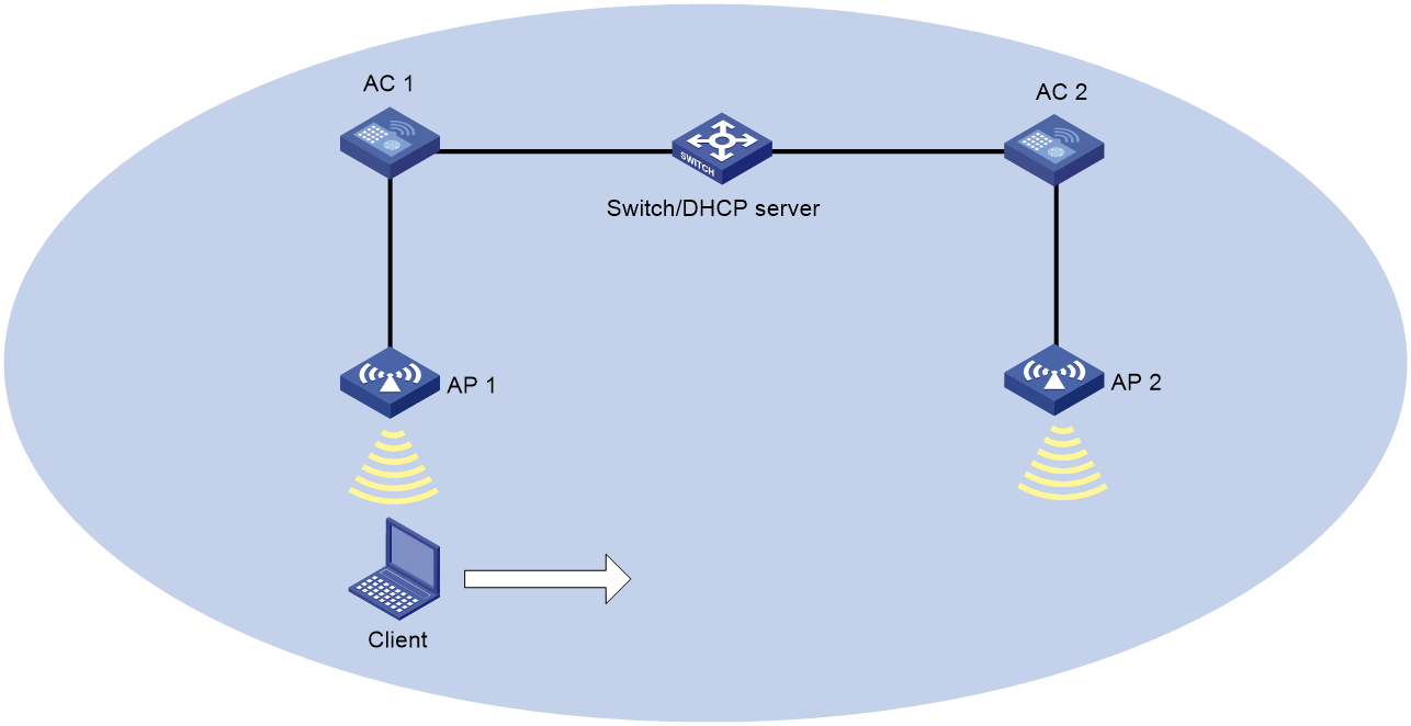

As shown in Figure 1, deploy two ACs connected through a switch to provide wireless services. The switch acts as a DHCP server to assign IP addresses to APs and clients. Specify the same VLAN group for each AP to enable clients to roam between the two ACs without changing client VLANs.
Figure 1 Network diagram
Device
Interface
IP address
AC 1
Vlan-int100
192.1.0.2/16
Vlan-int200
192.2.0.2/16
AC 2
Vlan-int100
192.1.0.3/16
Vlan-int400
192.4.0.2/16
Switch
Vlan-int100
192.1.0.1/16
Vlan-int200
192.2.0.1/16
Vlan-int400
192.4.0.1/16
When you configure inter-AC roaming with static client VLAN allocation, follow these restrictions and guidelines:
·     Make sure the configured SSID, authentication and key management (AKM) mode, and cipher suite are the same on APs for wireless roaming.
·     Use the serial ID labeled on the AP's rear panel to specify an AP.

# Make a client come online from AC 1.
# Use the display wlan client command to view the client's VLAN and IP address from AC 1.
[AC] display wlan client
Total number of clients: 1
MAC address    User name  AP name        R IP address      VLAN
68db-ca64-23fd N/A        ap1            1 192.2.0.3       200
# Make the client roam to AC 2.
# Use the display wlan client command to view the client's VLAN and IP address from AC 2. Verify that the client's VLAN and IP address are not changed after roaming.
68db-ca64-23fd N/A        ap2            1 192.2.0.3       200
