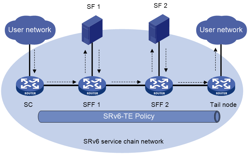

SRv6 service chain basic concepts
As shown in Figure 1, specific service packets from the user network are steered into the application service nodes in the SRv6 service chain network. After the service nodes process the packets, the packets are forwarded to the destination.
Figure 1 SRv6 service chain network diagram
An SRv6 service chain network contains the following components:
·     Service classifier (SC)—Source node of the SRv6 service chain, which is located at the edge of the SRv6 service chain network. The SC can use multiple methods to steer service data to an SRv6 TE policy tunnel.
·     Service function (SF)—Node that provides specific application services for data traffic. The following types of SFs are supported:
¡     SRv6-unaware SF—An SRv6-unaware SF cannot recognize or process SRv6 packets. It cannot parse or handle information in the SRH. Instead, it relies on the SFF node to act as a proxy to handle the SRv6 packets, forward the processed packets to the SF, and let the SF provide value-added services. This type of SRv6 SFC capability is referred to as SRv6-unaware service.
¡     SRv6-aware SF—An SRv6-aware SF can recognize and process SRv6 packets while providing value-added services. This type of SRv6 SFC capability is referred to as SRv6-aware service.
·     Service function forwarder (SFF)—Node that acts as a service chain proxy for SFs. Based on the SRv6 decapsulation information of received packets, the SFF forwards the packets to the SFs associated with the SFF. The SFs process the packets, and then return the packets back to the SFF. The SFF determines whether to continue forwarding the packets.

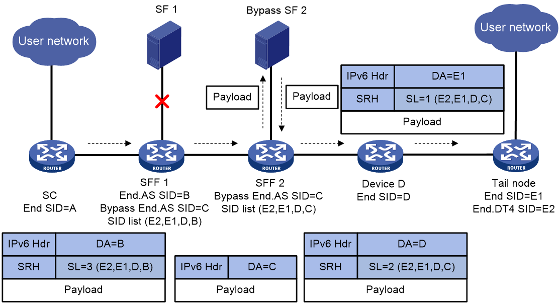

In static proxy mode

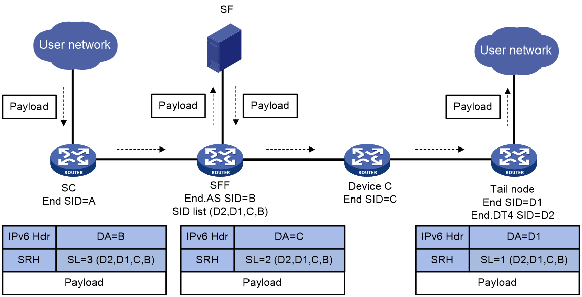

As shown in Figure 2, packets pass through an SRv6 service chain in static proxy mode as follows in an IPv4 L3VPN over SRv6-TE network:
1.     After the SC (source node) receives IPv4 packets from the user network, it steers the packets to an SRv6 TE policy. Then, the SC adds an SRH and outer IPv6 header to the packets according to the SRv6 TE policy. The destination address of the SRv6 packets is the End.AS SID of the SFF. The SRH includes path information in the SRv6 TE policy and the End.DT4 SID of the tail node.
2.     When the SFF receives the SRv6 packets, it looks up the local SID forwarding table and finds that the destination address of the packets is the local End.AS SID. Then, the SFF records the SL value in the packets and performs the following operations:
a.     Removes the outer IPv6 header and SRH from the packets.
b.     Forwards the original packets to the SF through the specified output interface.
3.     After the SF processes the packets, it forwards the packets back to the SFF.
4.     The SFF searches for SID list configuration based on the input interface of the packets or the input interface and inbound VLANs of the packets. Then, the SFF performs the following operations:
a.     Reencapsulates the packets as SRv6 packets according to the configured SID list. The SID list in the SRH must be the same as the path in the SRv6 TE policy on the source node (SC). In addition, the SL value in the SRH decreases by 1 based on the SL value recorded in step 2. The destination address of the SRv6 packets is the SID next to the local End.AS SID, which is the End SID of Device C.
b.     Looks up the IPv6 routing table for a route that can reach the destination IPv6 address in the packets and forwards the packets.
5.     When Device C receives the packets, it looks up the local SID forwarding table and finds that the destination address is the local End SID. Then, Device C processes the packets as follows:
a.     Replaces the destination address with D1 (End SID of the tail node).
b.     Decreases the SL value by 1.
c.     Looks up the IPv6 routing table to forward the packets.
6.     After the tail node receives the packets, it looks up the local SID forwarding table and finds that the destination address is D1 (the local End SID). Then, the tail node performs the following operations:
a.     Replaces the destination address with D2 (End.DT4 SID of the tail node) and decreases the SL value by 1. The SL value changes to 0.
b.     Executes the function of the End.DT4 SID, which is decapsulating the SRv6 packets and forwards the original packets to the public network or the destination VPN instance.
Figure 2 SRv6 service chain traffic forwarding in static proxy mode

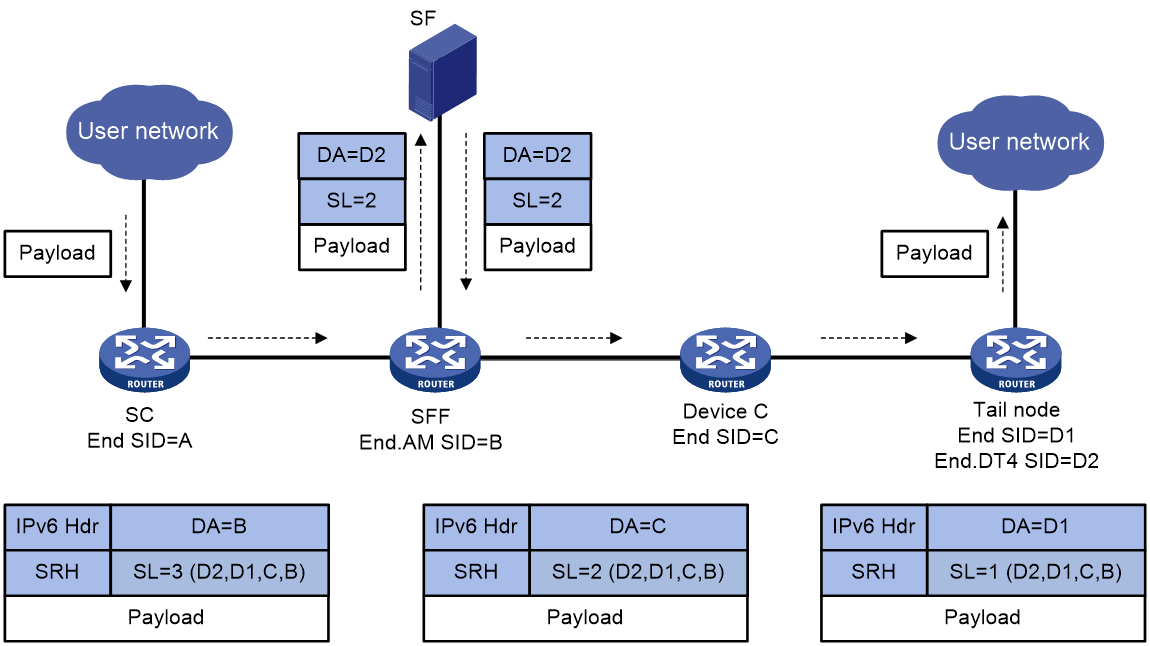

In masquerading mode
As shown in Figure 3, packets pass through an SRv6 service chain in masquerading mode as follows in an IPv4 L3VPN over SRv6-TE network:
1.     After the SC (source node) receives IPv4 packets from the user network, it steers the packets to an SRv6 TE policy. Then, the SC adds an SRH and outer IPv6 header to the packets according to the SRv6 TE policy. The destin ation address of the SRv6 packets is the End.AM SID of the SFF. The SRH includes path information in the SRv6 TE policy and the End.DT4 SID of the tail node.
2.     When the SFF receives the SRv6 packets, it looks up the local SID forwarding table and finds that the destination address of the packets is the local End.AM SID. Then, the SFF performs the following operations:
a.     Replaces the destination IP address of the SRv6 packets with the last SID in the SID list of the SRH. The last SID is the End.DT4 SID of the tail node.
c.     Forwards the packets from the output interface bound to the End.AM SID to the SF.
3.     The SF processes the packets without modifying the SRv6 packet headers and forwards the packets back to the SFF.
4.     The packets return back to the SFF. If an End.AM SID is bound to the input interface or both the input interface and VLAN of the packets, the SFF replaces the destination address of the SRv6 packets according to the SL value in the SRH. The SL value is 2, so the SFF replaces the destination address of the SRv6 packets with C (the next SID of the local End.AM SID, which is the End SID of Device C). The SFF looks up the IPv6 routing table to forward the packets according to the destination IPv6 address.
5.     When Device C receives the packets, it looks up the local SID forwarding table and finds that the packet destination address is the local End SID. Then, Device C forwards the packets according to the standard SRv6 traffic forwarding process as follows:
a.     Replaces the packet destination address with D1 (the End SID of the tail node).
6.     When the tail node receives the packets, it looks up the local SID forwarding table and finds that packet destination address D1 is the local End SID. Then, the tail node replaces the destination address with D2 (the End.DT4 SID of the tail node) and decreases the SL value by 1. The SL value changes to 0. Finally, the tail node executes the function of the End.DT4 SID as follows:
a.     Decapsulates the SRv6 packets.
b.     Forwards the original packets to the matching VPN instance or to the public network.
Figure 3 SRv6 service chain traffic forwarding in masquerading mode

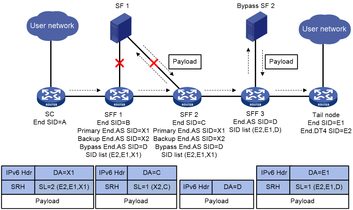

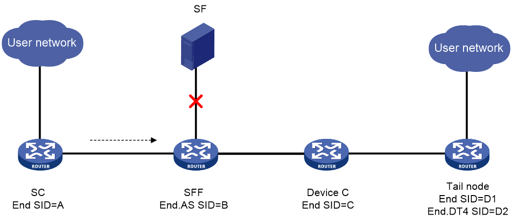

As shown in Figure 4, when the SF is unreachable, the SFF discards the packets that should be forwarded to the SF. These packets cannot bypass the SF to reach Device C.
For high availability, the SFF supports dualhoming protection and bypass protection.
·     Dualhoming protection—An SF is dualhomed to two SFFs, one SFF is the primary SFF and the other is the backup SFF. When the primary SFF cannot reach the SF, it forwards service traffic to the backup SFF.
·     Bypass protection—When an SF fails, packets can bypass the SF to reach the next hop.
SRv6 service chains in masquerading mode do not provide any high availability protection mechanisms.
Figure 4 Packet forwarding failure caused by unreachable SF

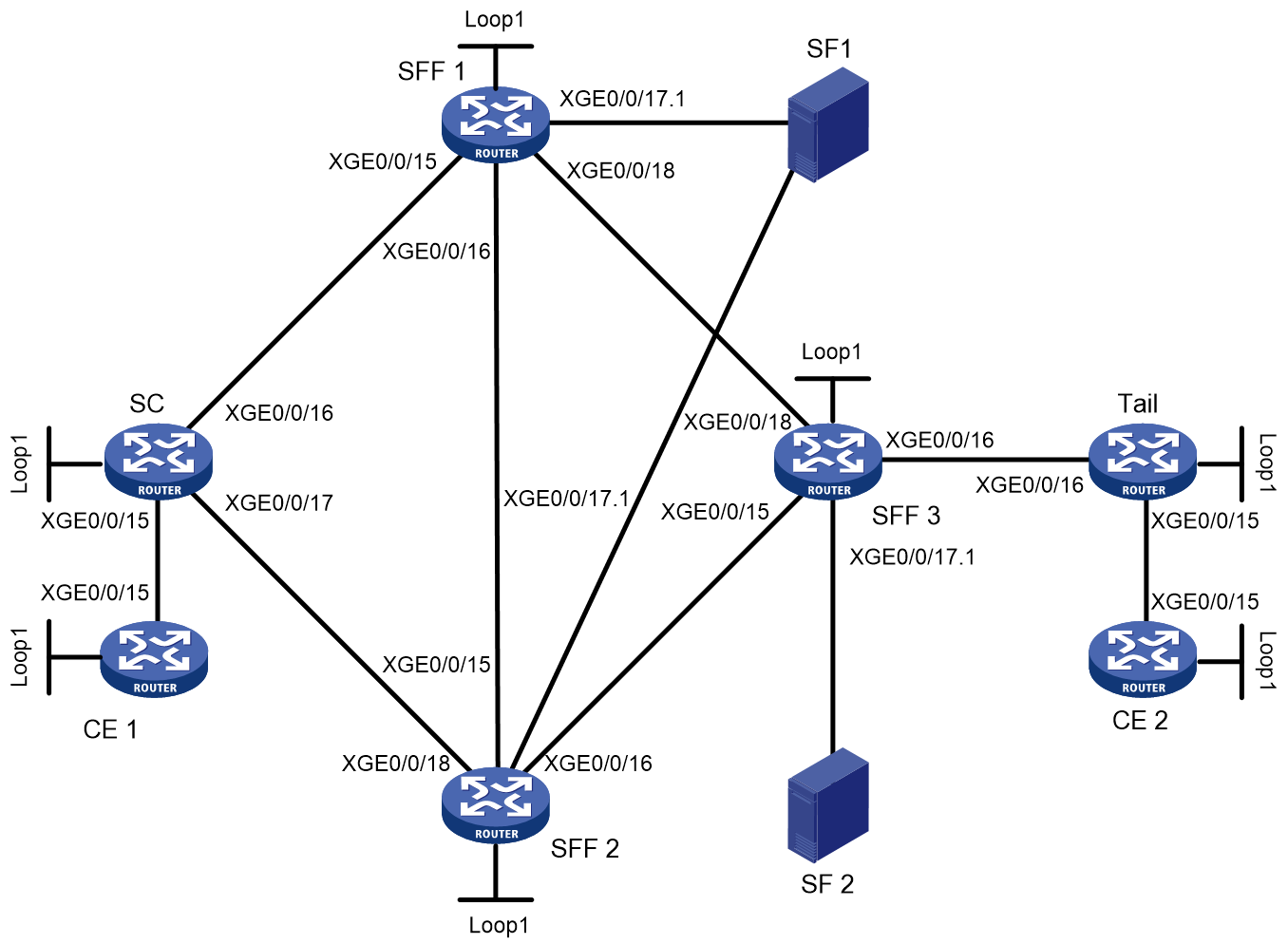

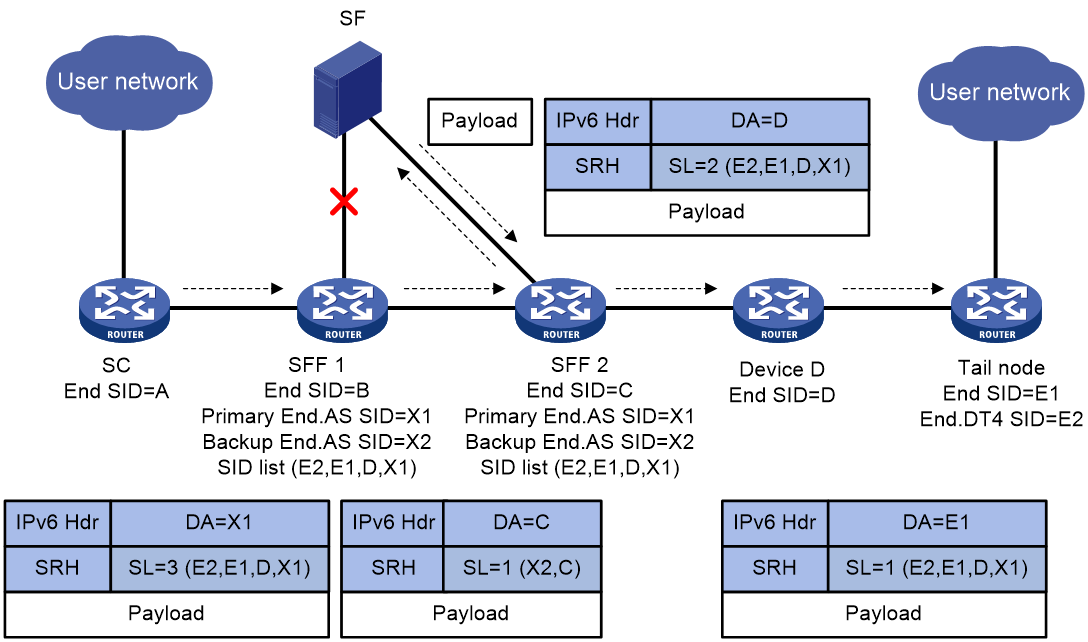

SRv6 service chain traffic forwarding with dualhoming protection
As shown in Figure 5, the SF is dualhomed to SFF 1 and SFF 2. Bypass protection is not configured.
For high availability, perform the following tasks on both SFF 1 and SFF 2:
·     Specify the End SID of one SFF as the backup peer SID of the other SFF.
·     Use the same locator to allocate the primary and backup End.AS SIDs.
·     Configure the same primary and backup End.AS SIDs.
As shown in Figure 5, dualhoming protection acts as follows in packet forwarding:
1.     When SFF 1 detects that it cannot reach the SF, it removes the outer IPv6 header and SRH from packets.
2.     SFF 1 searches the local configuration and reencapsulates an SRH and IPv6 header to the packets. In the SRH, the SID list includes the backup End.AS SID (X2) and the End SID of SFF 2 (C). In the IPv6 header, the destination address is C.
3.     SFF 1 looks up the routing table to forward the packets to the backup SFF SFF 2.
4.     When the packets reach SFF 2, SFF 2 detects whether it can reach the SF.
¡     If SFF 2 can reach the SF, it forwards the packets to the SF as in a standard SRv6 service chain traffic forwarding process in static proxy mode.
¡     If SFF 2 cannot reach the SF, it discards the packets.
Figure 5 SRv6 service chain traffic forwarding with dualhoming protection in static proxy mode

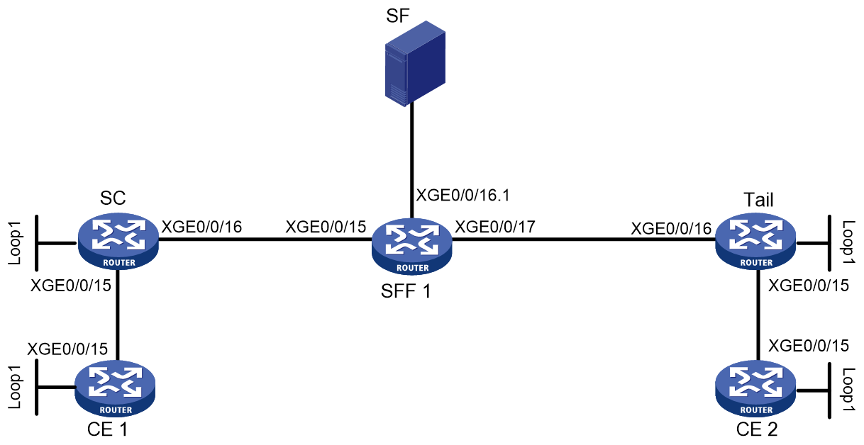

SRv6 service chain traffic forwarding with bypass protection
As shown in Figure 6, in the SRv6 service chain network, SF 1 has a bypass protection node, which is SF 2. SF 1 is single-homed to SFF 1 and the bypass protection node SF 2 is single-homed to SFF 2.
To implement bypass protection, enable bypass protection and specify a bypass End.AS SID on SFF 1.
With a bypass End.AS SID specified, bypass protection acts as follows in packet forwarding:
1.     When SFF 1 detects that it cannot reach SF 1, it removes the outer IPv6 header and SRH from packets.
2.     SFF 1 searches the local configuration and reencapsulates an IPv6 header to the packets. In the IPv6 header, the destination address is C.
3.     SFF 1 looks up the routing table to forward the packets to SFF 2.
4.     After SFF 2 receives the packets, it forwards the packets as in a standard SRv6 service chain traffic forwarding process in static proxy mode.
Without a bypass End.AS SID specified, SFF 1 skips the End.AS SID of SF 1 when it cannot reach SF 1. The SFF uses the End SID of Device D as the next hop destination address. The packets are forwarded to the tail node according to the SRH.
Figure 6 SRv6 service chain traffic forwarding with bypass protection in static proxy mode

·     On SFF 1 and SFF 2, configure the same primary and backup End.AS SIDs.
·     On SFF 1 and SFF 2, enable bypass and specify a bypass End.AS SID.
As shown in Figure 7, dualhoming protection and bypass protection act as follows in packet forwarding:
1.     SFF 1 forwards packets according to whether it can reach SF 1.
¡     If SFF 1 can reach SF 1, it processes the packets as in a standard SRv6 service chain traffic forwarding process in static proxy mode.
¡     If SFF 1 cannot reach SF 1, it removes the outer IPv6 header and SRH from the packets. Then, SFF 1 reencapsulates an SRH and IPv6 header to the packets according to the local configuration. In the SRH, the SID list contains the backup End.AS SID (X2) and the End SID of SFF 2 (C). In the IPv6 header, the destination address is C. Finally, SFF 1 looks up the routing table to forward the packets to SFF 2.
2.     When SFF 2 receives the packets, it processes the packets according to whether it can reach SF 1.
¡     If SFF 2 can reach SF 1, it forwards the packets as in a standard SRv6 service chain traffic forwarding process in static proxy mode.
¡     If SFF 2 cannot reach SF 1, it starts the bypass protection forwarding process. SFF 2 removes the outer IPv6 header and SRH from the packets. According to the local configuration, SFF 2 reencapsulates an SRH and IPv6 header to the packets. In the SRH, the SID list only contains the bypass End.AS SID (D). In the IPv6 header, the destination address is D. Then, SFF 2 looks up the routing table to forward the packets to SFF 3.
3.     When SFF 3 receives the packets, it processes the packets according to whether it can reach the bypass protection node SF 2.
¡     If SFF 3 can reach SF 2, it processes the packets as in a standard SRv6 service chain traffic forwarding process in static proxy mode.
¡     If SFF 3 cannot reach SF 2, it discards the packets.
Figure 7 SRv6 service chain traffic forwarding with dualhoming and bypass protection in static proxy mode

Configuring bypass protection for an SRv6 service chain in static proxy mode
Dualhoming protection takes precedence over bypass protection. If dualhoming protection is not available or fails, bypass protection applies.
2.     Enter SRv6 view.
segment-routing ipv6
3.     Enter SRv6 locator view.
locator locator-name [ ipv6-prefix ipv6-address prefix-length [ args args-length | static static-length ] * ]
locator locator-name [ ipv6-prefix ipv6-address prefix-length common-prefix common-prefix-length coc32 [ args args-length | static static-length ] * ]
locator locator-name [ ipv6-prefix ipv6-address prefix-length common-prefix common-prefix-length coc-both [ non-compress-static non-compress-static-length ] [ args args-length | static static-length ] * ]
4.     Enter SRv6 service chain static proxy view.
opcode { opcode | hex hex-opcode } end-as
5.     Enable bypass and specify a bypass End.AS SID.
bypass [ sid ipv6-address ]
By default, bypass is disabled.
To ensure correct packet forwarding when the SF associated with the SFF is unreachable and the network does not have a bypass SF, enable bypass without specifying a bypass End.AS SID. In this case, the SFF skips the End.AS SID of the current SF and uses the next SID in the SRH as the next hop destination address. The data traffic is forwarded to the tail node according to the SRH.
Enabling the No-Bypass feature for an SRv6 service chain in static proxy mode
The No-Bypass feature of SRv6 service chain static proxy refers to the prohibition of traffic bypassing the End.AS SID on the SFF, so as to avoid application service node bypass. It is not related to the bypass protection feature of SRv6 service chain static proxy.
Two flags are defined in the Flags field of SRH: No-Bypass flag and No-FRR flag. When both flags are set simultaneously, it indicates that all SIDs in the SRH cannot be bypassed.
On an SRv6 service chain in static proxy mode, if the SFF node fails, by default, the traffic from the upstream node of the SFF will bypass the End.AS SID in the SRv6 TE policy through a local protection path (such as the SRv6 TE FRR path in the transit node protection function), causing the application service node represented by the End.AS SID unable to process the traffic. To prevent traffic from bypassing End.AS SID through a local protection path, enable the No-Bypass feature for an SRv6 TE policy on the source node of the SRv6 TE policy. The source node will then set both the No-Bypass and No-FRR flag bits when encapsulating SRH. At the same time, to avoid losing the No-Bypass flag and No-FRR flag information in the SRH re-encapsulated by SFF, you also need to enable the No-Bypass feature for the SRv6 service chain static proxy on the SFF, so that when data packets are encapsulated with an SRH, both the No-Bypass flag and the No-FRR flag are set (to 1).
For more information about the No-Bypass feature of SRv6 TE policies, see SRv6 TE policy configuration in Segment Routing Configuration Guide.
On the source node of an SRv6 TE policy, you need to execute the srv6-policy forward no-bypass or the forward no-bypass command to enable the No-Bypass feature for the SRv6 TE policy.
After executing the sr-te srh-flag-check enable command on the upstream node of SFF, the node will check whether the No-Bypass and No-FRR flag bits are set in the Flags field of the SRH in packets.
·     If both No-Bypass and No-FRR flags are set, packets are not allowed to be forwarded through local protection paths.
·     If the No-Bypass and No-FRR flags are both unset, packets are allowed to be forwarded through the local protection paths.

Example: Configuring an SRv6 service chain in static proxy mode with Layer 2 encapsulation
As shown in Figure 9, CE 1 and CE 2 belong to one VPN instance. In the network, deploy an SRv6 service chain in static proxy mode to orchestrate the service traffic from CE 1 to pass through SF 1 to reach CE 2. For high availability, SF 1 is dualhomed to SFF 1 and SFF 2 and SF 2 is the bypass protection node of SF 1.
The SFFs are connected to SFs through Layer 3 Ethernet subinterfaces. Layer 2 encapsulation is used for packets forwarded between a pair of SFF and SF.
To meet the requirements, perform the following tasks:
·     On the SC and tail node, configure the VPN instance settings and steer service traffic to an SRv6 TE policy. The forwarding path in the policy is SC—> SFF 1 —> SF 1 —> Tail.
·     On SFF 1, SFF 2, and SFF 3, configure an SRv6 service chain in static proxy mode with Layer 2 encapsulation.
·     On SFF 1 and SFF 2, configure dualhoming protection settings. Make sure service chain traffic can be forwarded to SFF 2 when SFF 1 cannot reach SF 1.
·     On SFF 1 and SFF 2, configure bypass protection settings. Make sure SF 2 can provide bypass protection when SF 1 is not reachable.
Figure 9 Network diagram
Device
Interface
IP address
Device
Interface
IP address
SC
Loop1
1::1/128
SFF 1
Loop1
2::2/128
XGE0/0/15
16.0.0.2/30
XGE0/0/15
100::2/96
XGE0/0/16
100::1/96
XGE0/0/16
300::1/96
XGE0/0/17
200::1/96
XGE0/0/18
400::1/96
SFF 2
Loop1
3::3/128
SFF 3
Loop1
4::4/128
XGE0/0/15
300::2/96
XGE0/0/15
500::2/96
XGE0/0/16
500::1/96
XGE0/0/16
600::1/96
XGE0/0/18
200::2/96
XGE0/0/18
400::2/96
Tail
Loop1
5::5/128
CE 1
Loop1
6.6.6.6/32
XGE0/0/15
57.0.0.1/30
XGE0/0/15
16.0.0.1/30
XGE0/0/16
600::2/96
CE 2
Loop1
7.7.7.7/32
XGE0/0/15
57.0.0.2/30
·     Plan SRv6 SIDs on each device.
¡     On the SC, the network of locator a is 1000::/64, the End SID is 1000::1, and the End.DT4 SID is 1000::2.
¡     On SFF 1, the network of locator b is 2000::/64, the End SID is 2000::1, the network of locator as1 is 2001::/64, and the End.AS SID is 2001::1.
¡     On SFF 2, the network of locator c is 3000::/64, the End SID is 3000::1, the network of locator as1 is 2001::/64, and the End.AS SID is 2001::1.
¡     On SFF 3, the network of locator d is 4000::/64, the End SID is 4000::1, the network of locator as2 is 4001::/64, and the End.AS SID is 4001::1.
¡     On the tail node, the network of locator e is 5000::/64, the End SID is 5000::1, and the End.DT4 SID is 5000::2.

Example: Configuring an SRv6 service chain in masquerading mode with Layer 3 forwarding
As shown in Figure 10, CE 1 and CE 2 belong to one VPN instance. In the network, deploy an SRv6 service chain in masquerading mode to orchestrate the service traffic from CE 1 to pass through the SF to reach CE 2.
SFF 1 is connected to the SF through a Layer 3 Ethernet interface. Layer 3 forwarding is used for packets between the SFF and SF.
·     On the SC and tail node, configure the VPN instance settings and steer service traffic to an SRv6 TE policy. The forwarding path in the policy is SC—> SFF 1 —> SF —> Tail.
·     On SFF 1, configure an SRv6 service chain in masquerading mode with Layer 3 forwarding.
Figure 10 Network diagram
Device
Interface
IP address
Device
Interface
IP address
SC
Loop1
1::1/128
SFF 1
Loop1
2::2/128
XGE0/0/15
16.0.0.2/30
XGE0/0/15
100::2/96
XGE0/0/16
100::1/96
XGE0/0/16
10::1/96
SF
10::2/96
XGE0/0/17
400::1/96
Tail
Loop1
5::5/128
CE 1
Loop1
6.6.6.6/32
XGE0/0/15
57.0.0.1/30
XGE0/0/15
16.0.0.1/30
XGE0/0/16
400::2/96
CE 2
Loop1
7.7.7.7/32
XGE0/0/15
57.0.0.2/30
¡     On SFF 1, the network of locator b is 2000::/64, the End SID is 2000::1, the network of locator am1 is 2001::/64, and the End.AM SID is 2001::1.
·     Plan the traffic forwarding tunnel and the explicit path of the tunnel. In this example, traffic on the SC is forwarded to the tail node through the explicit path of an SRv6 TE policy. In the forwarding path, SFF 1 forwards the traffic to the SF. The SF processes the traffic and forwards the traffic back to SFF 1. SFF 1 forwards the traffic to the tail node.

Example: Configuring an SRv6 service chain in masquerading mode with Layer 2 forwarding
As shown in Figure 11, CE 1 and CE 2 belong to one VPN instance. In the network, deploy an SRv6 service chain in masquerading mode to orchestrate the service traffic from CE 1 to pass through the SF to reach CE 2.
SFF 1 is connected to the SF through a Layer 3 Ethernet subinterface. Layer 2 forwarding is used for packets between the SFF and SF.
·     On SFF 1, configure an SRv6 service chain in masquerading mode with Layer 2 forwarding.
Figure 11 Network diagram
