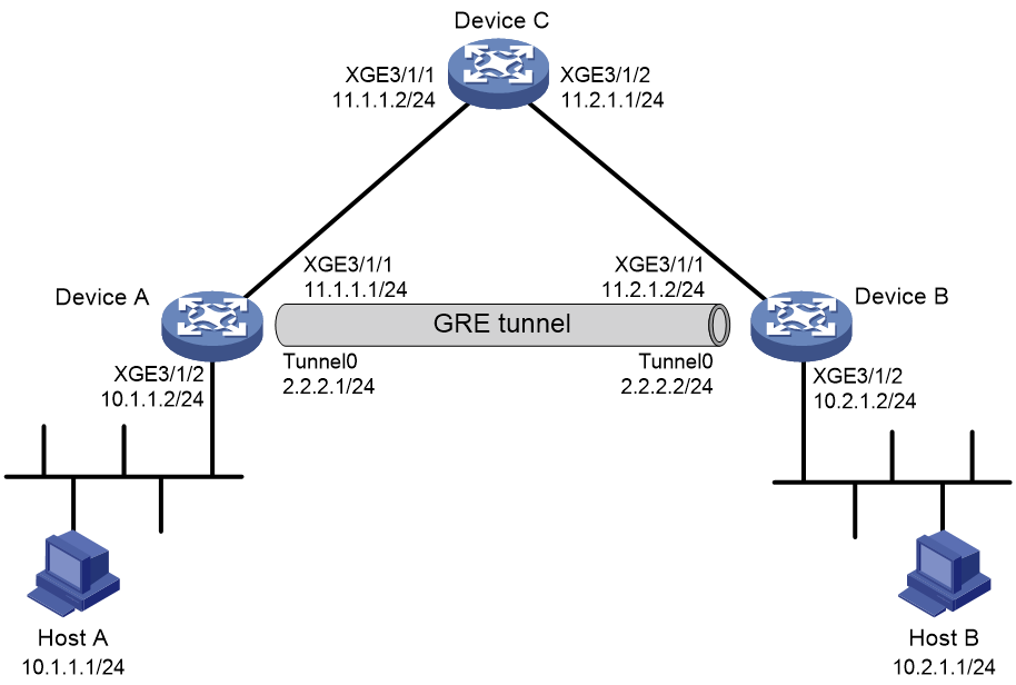

As shown in Figure 1, Device A, Device B, and Device C run OSPF. Establish a directly connected link between Device A and Device B so that Host A and Host B can communicate with each other. The specific requirements are as follows:
·     Configure Device A as the default gateway for Host A, and Device B as the default gateway for Host B.
·     Establish a directly connected link between Device A and Device B. Use static routes to specify forwarding of packets to the peer ends through the corresponding tunnel interfaces.
Figure 1 Network diagram

To meet the network requirements, perform the following tasks:
·     To establish a GRE tunnel between Device A and Device B, complete GRE-related configurations.
·     To transmit packets between Host A and Host B through the GRE tunnel, configure a directly connected route to Host B on Device A and a directly connected route to Host A on Device B.

56 bytes from 10.2.1.1: icmp_seq=2 ttl=253 time=2.000 ms
56 bytes from 10.2.1.1: icmp_seq=3 ttl=253 time=2.000 ms
56 bytes from 10.2.1.1: icmp_seq=4 ttl=253 time=2.000 ms
--- Ping statistics for 10.2.1.1 ---
round-trip min/avg/max/std-dev = 1.000/2.000/3.000/0.632 ms
Configuration files
·     Device A:
ospf 1
 area 0.0.0.0
  network 11.1.1.0 0.0.0.255
  network 11.2.1.0 0.0.0.255
interface Ten-GigabitEthernet3/1/1
 port link-mode route
 ip address 11.1.1.1 255.255.255.0
interface Ten-GigabitEthernet3/1/2
 ip address 10.1.1.2 255.255.255.0
interface Tunnel0 mode gre
 ip address 2.2.2.1 255.255.255.0
 source 11.1.1.1
 destination 11.2.1.2
 ip route-static 10.2.1.0 24 Tunnel0
return
·     Device B:
ospf 1
 area 0.0.0.0
 ip address 11.2.1.2 255.255.255.0
 ip address 10.2.1.2 255.255.255.0
 ip address 2.2.2.2 255.255.255.0
 source 11.2.1.2
 destination 11.1.1.1
 ip route-static 10.1.1.0 24 Tunnel0
return
·     Device C:
ospf 1
 area 0.0.0.0
 ip address 11.1.1.2 255.255.255.0
 ip address 11.2.1.1 255.255.255.0
return
Related documentation
·     Layer 3—IP Services Configuration Guide
·     Layer 3—IP Routing Configuration Guide
·     Layer 3—IP Services Command Reference
·     Layer 3—IP Routing Command Reference
