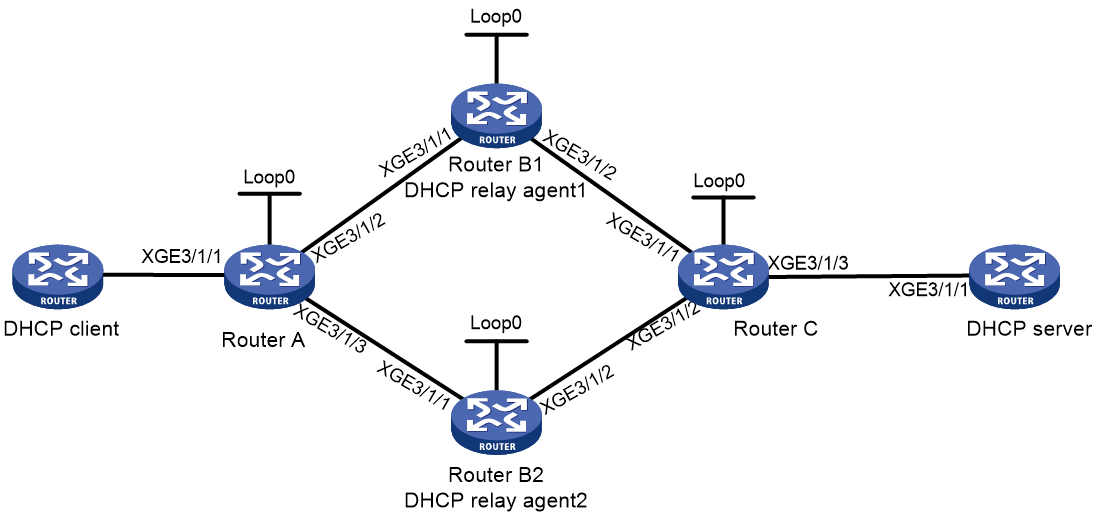

Router A and Router B communicate with each other through L2VPN. Router B1 and Router B2 act as DHCP relay agents and communicate with Router C through L3VPN. The DHCP server is deployed on the public network.
Figure 1 Network diagram
Device
Interface
IP address
Device
Interface
IP address
Router A
XGE3/1/1
2.1.1.1/24|10::1/64
Router C
XGE3/1/1
10.1.1.1/24|22::1/64
XGE3/1/2
2.1.1.2/24|11::1/64
XGE3/1/2
20.1.1.3/24|23::1/64
XGE3/1/3
3.1.1.3/24|12::1/64
XGE3/1/3
30.1.1.1/24|33::1/64
Loop0
1.1.1.1/32|1::1/128
Loop0
4.4.4.4/32|5::55/128
Router B1
XGE3/1/1
2.1.1.10/24|11::2/64
DHCP server
XGE3/1/1
30.1.1.2/24|33::2/64
XGE3/1/2
10.1.1.10/24|22::2/64
Loop0
2.2.2.2/32|44::1/128
Router B2
XGE3/1/1
3.1.1.20/24|12::2/64
XGE3/1/2
20.1.1.20/24|23::2/64
Loop0
3.3.3.3/32|66::1/128

Router B1
 dhcp enable
interface Ten-GigabitEthernet3/1/1
 port link-mode route
 ip address 2.1.1.10 255.255.255.0
 ospf 1 area 0.0.0.0
 ospfv3 1 area 0.0.0.0
 mpls enable
 mpls ldp enable
 ipv6 address 11::2/64
interface Ten-GigabitEthernet3/1/2
 ip address 10.1.1.10 255.255.255.0
 isis enable 1
 isis ipv6 enable 1
 isis circuit-level level-2
 mpls enable
 mpls ldp enable
 ipv6 address 22::2/64
interface LoopBack0
 ip address 2.2.2.2 255.255.255.255
 ospf 1 area 0.0.0.0
 isis enable 1
 isis ipv6 enable 1
 ipv6 address 44::1/128
interface VE-L3VPN7
 ip binding vpn-instance ipran
 ip address 25.2.0.1 255.255.255.0
 ip address 44.4.0.1 255.255.255.0 sub
 mac-address 586a-b100-0001
 dhcp relay source-address 44.4.0.1
 dhcp select relay
 dhcp relay information enable
 dhcp relay server-address 30.1.1.2
 ipv6 dhcp select relay
 ipv6 dhcp relay source-address 44::1
 ipv6 dhcp relay server-address 33::2
 ipv6 address 6::1/64
 ipv6 nd autoconfig managed-address-flag
 ipv6 nd autoconfig other-flag
 undo ipv6 nd ra halt
interface LoopBack7
interface VE-L2VPN7.1
 qos trust exp
 vlan-type dot1q vid 1
xconnect-group ipran
 connection 1
  ac interface VE-L2VPN7.1
  peer 1.1.1.1 pw-id 4396
ospf 1 router-id 2.2.2.2
 area 0.0.0.0
ospfv3 1
 router-id 2.2.2.2
 area 0.0.0.0
isis 1
 is-level level-2
 network-entity 10.0000.0000.0002.00
 address-family ipv4 unicast
 address-family ipv6 unicast
bgp 100
 peer 4.4.4.4 as-number 100
 peer 4.4.4.4 connect-interface LoopBack0
 address-family vpnv4
  peer 4.4.4.4 enable
 address-family vpnv6
  peer 4.4.4.4 enable
 ip vpn-instance ipran
   import-route direct
   import-route direct
Router B2
 dhcp enable
 ip address 3.1.1.20 255.255.255.0
 ospf 1 area 0.0.0.0
 mpls enable
 mpls ldp enable
 ipv6 address 12::2/64
 ip address 20.1.1.20 255.255.255.0
 isis enable 1
 isis ipv6 enable 1
 mpls enable
 mpls ldp enable
 ipv6 address 23::2/64
interface LoopBack0
 ip address 3.3.3.3 255.255.255.255
 ospf 1 area 0.0.0.0
 isis enable 1
 isis ipv6 enable 1
 ipv6 address 66::1/128
interface VE-L3VPN7
 shutdown
 ip address 25.2.0.1 255.255.0.0
 ip address 45.4.0.1 255.255.255.0 sub
 dhcp relay source-address 45.4.0.1
 dhcp select relay
 ipv6 dhcp relay source-address 45::1
interface LoopBack7
 ipv6 address 45::1/128
 qos trust exp
 connection 1
ospf 1
 non-stop-routing
 area 0.0.0.0
ospfv3 1
 router-id 3.3.3.3
 non-stop-routing
 import-route static
 area 0.0.0.0
isis 1
 is-level level-2
 network-entity 10.0000.0000.0012.00
bgp 100
  import-route direct
  peer 4.4.4.4 enable
  import-route direct
  peer 4.4.4.4 enable
   import-route direct
   import-route direct
Router C
 ip address 20.1.1.3 255.255.255.0
 isis enable 1
 isis ipv6 enable 1
 mpls enable
 mpls ldp enable
 ipv6 address 23::1/64
 isis enable 1
 isis ipv6 enable 1
 mpls enable
 mpls ldp enable
 ipv6 address 22::1/64
interface Ten-GigabitEthernet3/1/3
 ip address 30.1.1.1 255.255.255.0
 ipv6 address 33::1/64
interface LoopBack0
 ip address 4.4.4.4 255.255.255.255
 isis enable 1
 isis ipv6 enable 1
 ipv6 address 5::55/128
bgp 100
 peer 3.3.3.3 as-number 100
 peer 3.3.3.3 connect-interface LoopBack0
peer 2.2.2.2 as-number 100
 peer 2.2.2.2 connect-interface LoopBack0
  peer 3.3.3.3 enable
  peer 2.2.2.2 enable
  peer 3.3.3.3 enable
  peer 2.2.2.2 enable
   import-route direct
   import-route direct
Server
 dhcp enable
ip pool pool3
 gateway-list 25.2.0.1
 network 25.2.0.0 mask 255.255.0.0
 forbidden-ip 25.2.0.1
ipv6 pool poolv6
 network 6::/64
 gateway-list 6::1
 ip address 30.1.1.2 255.255.255.0
 ipv6 dhcp select server
 ipv6 address 33::2/64
