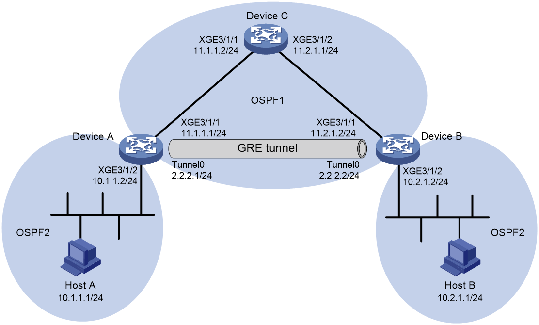

As shown in Figure 1, Device A, Device B, and Device C on a backbone network are running OSPF. Establish a directly connected link between Device A and Device B so that Host A and Host B can communicate with each other. The specific requirements are as follows:
·     Configure Device A as the default gateway for Host A, and Device B as the default gateway for Host B.
·     Establish a directly connected link between Device A and Device B. Enable OSPF on the tunnel interfaces.
·     Use OSPF process 1 on the backbone network, and OSPF process 2 in the user access areas.
Figure 1 Network diagram
