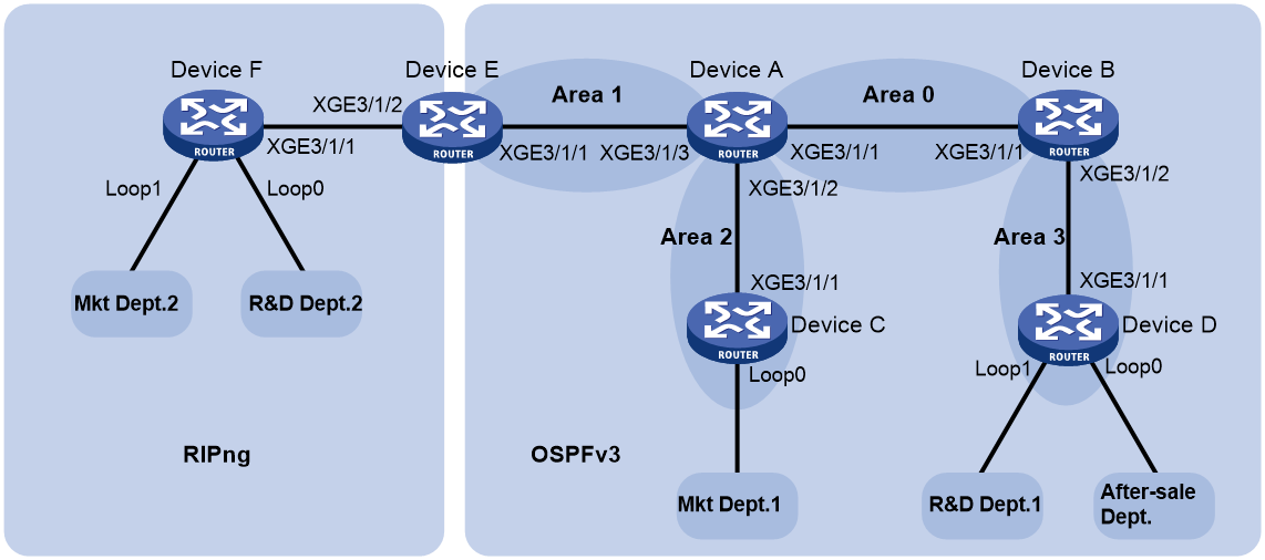

As shown in Figure 1, the devices of an enterprise reside in OSPFv3 and RIPng domains.
Configure route redistribution between OSPFv3 and RIPng to interconnect the devices.
Configure route filtering on Device E, Device C, and Device D to meet the following requirements:
·     The route destined for R&D department 2 is not redistributed to OSPFv3.
·     Marketing department 1 cannot reach R&D department 1.
·     R&D department 1 and the After-sale service department cannot reach Marketing department 2.
Figure 1 Network diagram

When you configure OSPFv3 route filtering, follow these restrictions and guidelines:
·     The filter-policy export command that filters redistributed routes takes effect only on an ASBR.
·     OSPFv3 filters routes calculated using received LSAs. It does not filter LSAs.
·     IP communication is bidirectional. If a router filters a route destined for Network A, the subnets attached to the router cannot reach Network A, and Network A cannot reach the subnets.
·     When you configure route filtering by referencing an ACL, configure the rule permit source any item following multiple rule deny source items to allow unmatched routes to pass.
·     Specify a Router ID when you configure OSPFv3.

# Verify that Marketing department 1 cannot reach R&D department 1.
[DeviceC] ping ipv6 -a 13::1 12::1
Ping6(56 data bytes) 13::1 --> 12::1, press CTRL_C to break
Request time out
Request time out
Request time out
Request time out
Request time out
--- Ping6 statistics for 12::1 ---
5 packet(s) transmitted, 0 packet(s) received, 100.0% packet loss
# Verify that Device D does not have a route to 15::/64.
[DeviceD]display ipv6 routing-table
Destinations : 14        Routes : 14
Destination: ::1/128                                     Protocol  : Direct
NextHop    : ::1                                         Preference: 0
Interface  : InLoop0                                     Cost      : 0
Destination: 1::/64                                      Protocol  : O_INTER
NextHop    : FE80::2A0:FCFF:FE00:5815                    Preference: 10
Interface  : XGE3/1/1                                    Cost      : 2
Destination: 2::/64                                      Protocol  : O_INTER
Interface  : XGE3/1/1                                    Cost      : 3
Destination: 3::/64                                      Protocol  : Direct
NextHop    : ::                                          Preference: 0
Interface  : XGE3/1/1                                    Cost      : 0
Destination: 3::2/128                                    Protocol  : Direct
Destination: 4::/64                                      Protocol  : O_INTER
Destination: 5::/64                                      Protocol  : O_ASE2
NextHop    : FE80::2A0:FCFF:FE00:5815                    Preference: 150
Interface  : XGE3/1/1                                    Cost      : 1
Destination: 11::/64                                     Protocol  : Direct
Interface  : Loop0                                       Cost      : 0
Destination: 11::1/128                                   Protocol  : Direct
Destination: 12::/64                                     Protocol  : Direct
Interface  : Loop1                                       Cost      : 0
Destination: 12::1/128                                   Protocol  : Direct
Destination: 13::1/128                                   Protocol  : O_INTER
Destination: FE80::/10                                   Protocol  : Direct
Interface  : NULL0                                       Cost      : 0
Destination: FF00::/8                                    Protocol  : Direct
Interface  : NULL0
# Verify that the After-sale service department cannot reach Marketing department 2.
[DeviceD] ping ipv6 -a 11::1 15::1
Ping6(56 data bytes) 11::1 --> 15::1, press CTRL_C to break
Request time out
Request time out
Request time out
Request time out
Request time out
--- Ping6 statistics for 15::1 ---
# Verify that R&D department 1 cannot reach Marketing department 2.
[DeviceD] ping ipv6 -a 12::1 15::1
Ping6(56 data bytes) 12::1 --> 15::1, press CTRL_C to break
Request time out
Request time out
Request time out
Request time out
Request time out
