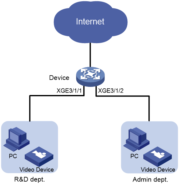

Example: Filtering packets by MAC address
As shown in Figure 1, the R&D department and the Administration department have video devices deployed. The video devices use MAC addresses prefixed with 000f-e2. Configure packet filtering on the device to allow outgoing video data to pass through only from 8:30 to 18:00 every day.
Figure 1 Network diagram
Analysis
Because the MAC addresses of the video devices are fixed, you can use an Ethernet frame header ACL to filter packets by MAC address. In the ACL, specify a MAC address and a mask to match the MAC addresses that have the same prefix.
Procedures
# Create a time range time1 for the time range from 8:30 to 18:00 every day.
<Device> system-view
[Device] time-range time1 8:30 to 18:00 daily
# Configure Ethernet frame header ACL 4000 to allow packets with source MAC addresses prefixed with 000f-e2 to pass through only during time1.
[Device] acl mac 4000
[Device-acl-mac-4000] rule permit source-mac 000f-e200-0000 ffff-ff00-0000 time-range time1
[Device-acl-mac-4000] rule deny source-mac 000f-e200-0000 ffff-ff00-0000
[Device-acl-mac-4000] quit
# Apply ACL 4000 to filter incoming packets on Ten-GigabitEthernet 3/1/1 and Ten-GigabitEthernet 3/1/2.
[Device] interface ten-gigabitethernet 3/1/1
[Device-Ten-GigabitEthernet3/1/1] packet-filter mac 4000 inbound
[Device-Ten-GigabitEthernet3/1/1] quit
[Device] interface ten-gigabitethernet 3/1/2
[Device-Ten-GigabitEthernet3/1/2] packet-filter mac 4000 inbound
[Device-Ten-GigabitEthernet3/1/2] quit
# Verify that the ACL is successfully applied for packet filtering.
[Device] display packet-filter interface inbound
Interface: Ten-GigabitEthernet3/1/1
 Inbound policy:
  MAC ACL 4000
Interface: Ten-GigabitEthernet3/1/2
 Inbound policy:
  MAC ACL 4000
# Verify that the video devices can communicate with the external network during the time range time1. (Details not shown.)
# Verify that the video devices cannot communicate with the external network beyond the time range time1. (Details not shown.)
Configuration files
interface Ten-GigabitEthernet3/1/1
 port link-mode route
interface Ten-GigabitEthernet3/1/2
 time-range time1 08:30 to 18:00 daily
acl mac 4000
 rule 0 permit source-mac 000f-e200-0000 ffff-ff00-0000 time-range time1
 rule 5 deny source-mac 000f-e200-0000 ffff-ff00-0000

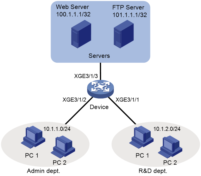

Example: Filtering TCP packets
As shown in Figure 3, the R&D department, Administration department, and servers are on different networks, and they are connected through the device.
Configure packet filtering to meet the following requirements:
·     The Web server provides HTTP services to only the Administration department.
·     The FTP server provides FTP services to only the R&D department.
·     The TCP connections between hosts and the Web server can only be initiated by the hosts. The TCP connections between hosts and the FTP server can be initiated by either the hosts or the FTP server.
Figure 3 Network diagram
Analysis
To meet the network requirements, you must perform the following tasks:
·     To allow TCP connections initiated by the hosts to the Web server, perform the following tasks:
¡     Configure an advanced ACL rule as follows to allow packets sent by the Web server through established TCP connections to pass through:
-     Specify the established keyword (the ACK or RST flag bit set) in the rule to match established TCP connections.
-     Because a TCP initiator typically uses a TCP port number higher than 1023, specify a port number range higher than 1023 to match established TCP connections.
¡     Configure an advanced ACL rule to deny packets sent from the subnet where the Web server resides to the subnet where the hosts reside.
·     FTP uses TCP port 20 for data transfer and port 21 for FTP control. To identify FTP traffic, you must specify TCP ports 20 and 21 in ACL rules.
·     To identify HTTP packets, specify TCP port 80 in ACL rules.
Procedures
Configuring access control for the Administration department
# Create IPv4 advanced ACL 3000.
[Device] acl advanced 3000
# Configure a rule to allow TCP packets from the Web server to the hosts on subnet 10.1.1.0/24, with TCP port number higher than 1023 and the ACK or RST flag set.
[Device-acl-ipv4-adv-3000] rule permit tcp established source 100.1.1.1 0 destination 10.1.1.0 0.0.0.255 destination-port gt 1023
# Configure a rule to deny TCP packets from subnet 100.1.1.1/32 to subnet 10.1.1.0/24 to pass through.
[Device-acl-ipv4-adv-3000] rule deny tcp source 100.1.1.1 0 destination 10.1.1.0 0.0.0.255
# Configure a rule to deny FTP packets sourced from 101.1.1.1/32 to pass through.
[Device-acl-ipv4-adv-3000] rule deny tcp source 101.1.1.1 0 source-port range 20 21
[Device-acl-ipv4-adv-3000] quit
# Apply ACL 3000 to filter outgoing packets on Ten-GigabitEthernet 3/1/2.
[Device-Ten-GigabitEthernet3/1/2] packet-filter 3000 outbound
Configuring access control for the R&D department
# Create IPv4 advanced ACL 3001.
[Device] acl advanced 3001
# Configure a rule to deny HTTP packets sourced from 100.1.1.1/32 to pass through.
[Device-acl-ipv4-adv-3001] rule deny tcp source 100.1.1.1 0 source-port eq 80
[Device-acl-ipv4-adv-3001] quit
# Apply ACL 3001 to filter outgoing packets on Ten-GigabitEthernet 3/1/1.
[Device-Ten-GigabitEthernet3/1/1] packet-filter 3001 outbound
1.     Verify that the ACLs are successfully applied for packet filtering.
[Device] display packet-filter interface outbound
 Out-bound policy:
  IPv4 ACL 3001
 Out-bound policy:
  IPv4 ACL 3000
2.     Verify that you cannot Telnet to the FTP server from the Administration department.
C:\>telnet 101.1.1.1 21
Connecting To 101.1.1.1...Could not open connection to the host, on port 21:

3.     Verify that from the Web server, you can ping a host in the Administration department, but cannot access a shared folder on the host:
# Set a shared folder on a host in the Administration department. (Details not shown.)
# Ping the host from the Web server. The ping operation succeeds.
C:\>ping 10.1.1.110
Pinging 10.1.1.110 with 32 bytes of data:
Reply from 10.1.1.110: bytes=32 time=2ms TTL=128
Reply from 10.1.1.110: bytes=32 time=14ms TTL=128
Reply from 10.1.1.110: bytes=32 time=1ms TTL=128
Ping statistics for 10.1.1.110:
    Minimum = 1ms, Maximum = 14ms, Average = 4ms
C:\>
# Verify that you cannot access the share folder from the Web server. (Details not shown.)
4.     Verify that you cannot Telnet to the Web server from the R&D department.
C:\>telnet 100.1.1.1 80
Connecting To 100.1.1.1...Could not open connection to the host, on port 80:
 Connect failed
C:\>
Configuration files
acl advanced 3000
 rule 0 permit tcp source 100.1.1.1 0 destination 10.1.1.0 0.0.0.255 destination
-port gt 1023 established
 rule 5 deny tcp source 100.1.1.1 0 destination 10.1.1.0 0.0.0.255
 rule 10 deny tcp source 101.1.1.1 0 source-port range ftp-data ftp
acl advanced 3001
 rule 0 deny tcp source 100.1.1.1 0 source-port eq www
Related documentation
·     H3C SR8800-X Routers ACL and QoS Configuration Guide-R8380
·     H3C SR8800-X Routers ACL and QoS S Command Reference-R8380
