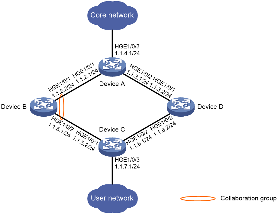

Typical application
As shown in Figure 1, Device C accesses the core network through Device B. When Interface B1 goes down, the switchover of traffic from Device C to Device D is slow because Interface B2 is still up.
If Interface B1 and Interface B2 belong to one collaboration group, Device B brings down Interface B2 when Interface B1 goes down to achieve fast traffic switchover. Similarly, the device brings down Interface B1 when Interface B2 goes down.
Figure 1 Interface collaboration application scenario

As shown in Figure 2, configure interface collaboration on Device B. When HundredGigE 1/0/1 on Device B goes down, Device B brings down HundredGigE 1/0/2. When HundredGigE 1/0/2 on Device B goes down, Device B brings down HundredGigE 1/0/1.
