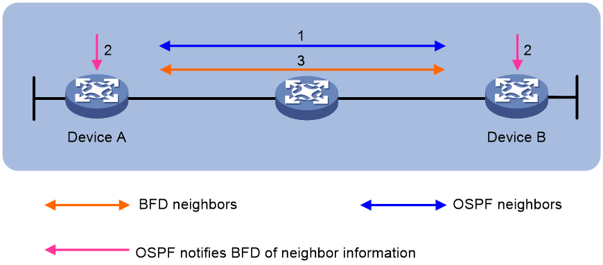

BFD establishes a session between two network devices to detect failures on the bidirectional forwarding paths between the devices and provide services for upper-layer protocols. BFD provides no neighbor discovery mechanism. Protocols that BFD services notify BFD of devices to which it needs to establish sessions. After a session is established, if no BFD control packet is received from the peer within the negotiated BFD interval, BFD notifies a failure to the protocol, which then takes appropriate measures.
Figure 1 describes the operation of BFD for OSPF.
1. OSPF discovers neighbors by sending Hello packets and establishes neighbor relationships.
2. After establishing neighbor relationships, OSPF notifies BFD of the neighbor information, including destination and source addresses.
3. BFD uses the information to establish BFD sessions.

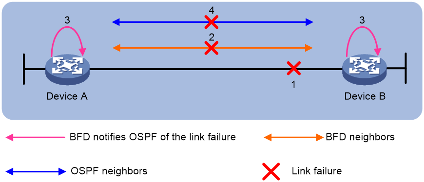

Figure 2 describes the BFD fault detection process.
1. BFD detects a link failure and tears down the session.
2. BFD notifies the neighbor unreachability to OSPF.
3. OSPF terminates the neighbor relationship on the link.

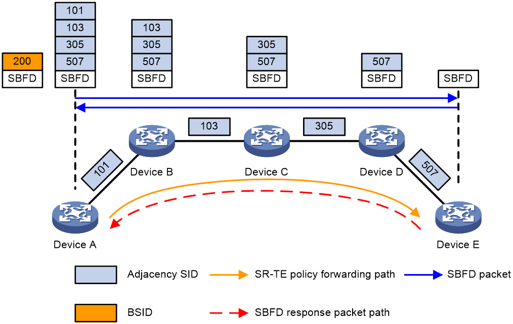

SBFD can detect the connectivity of an SR-MPLS TE policy and provides millisecond-level fault detection and fast fault switchover. By default, SBFD detects the SID lists for only the candidate path of the highest preference in an SR-MPLS TE policy. If all the SID lists for the candidate path are invalid, another candidate path takes over.
Figure 5 SR-MPLS TE policy association with SBFD
As shown in Figure 5, the SR-MPLS TE policy uses control-packet-mode SBFD to detect the forwarding paths as follows:
1. The source node (Device A) sends an SBFD control packet that encapsulates the candidate path of the highest preference of the SR-MPLS TE policy. If the candidate path of the highest preference in the SR-MPLS TE policy has multiple SID lists, multiple SBFD sessions are established to detect the forwarding path for each SID list.
2. Upon receiving the SBFD packet, the destination node (Device E, the reflector) checks whether the remote discriminator carried the packet is the same as the local discriminator. If they are the same, the reflector sends the response SBFD control packet to the initiator according to the IPv6 routing table. If they are different, the reflector drops the SBFD control packet.
3. Upon receiving the SBFD response, Device A determines that the forwarding path for the SID list is available. If no response is received, Device A determines that the forwarding path is faulty. If all SID lists for the current candidate path are faulty, another candidate path takes over.
The SR-MPLS TE policy uses echo-packet-mode SBFD to detect the forwarding paths as follows:
1. The source node (Device A) sends an SBFD echo packet that encapsulates the candidate path of the highest preference of the SR-MPLS TE policy. If the candidate path of the highest preference in the SR-MPLS TE policy has multiple SID lists, multiple SBFD sessions are established to detect the forwarding path for each SID list.
2. Upon receiving the SBFD echo packet, the destination node (Device E) sends the packet back along the shortest path obtained through routing table lookup.
3. Upon receiving the SBFD echo packet from Device E before the detection timer expires, Device A determines that the forwarding path for the SID list is available. If no response is received, Device A determines that the forwarding path is faulty. If all SID lists for the current candidate path are faulty, another candidate path takes over.

Configuring control-packet-mode SBFD to detect SR-MPLS TE policies (with IPv4 endpoints)
1. Enter system view.
2. (Optional.) Associate the destination IPv4 address of the detected path with the remote discriminator of the SBFD session for the initiator.
sbfd destination ipv4 destination-ipv4-address remote-discriminator { ipv4-address | integer-value }
By default, the destination IPv4 address of the detected path is not associated with the remote discriminator of the SBFD session for the initiator.
Configure this command if you want to specify the remote discriminator for establishing SBFD sessions.
3. Enter segment routing view.
segment-routing
4. Enter SR TE view.
traffic-engineering
5. Enable SBFD for all SR-MPLS TE policies.
sr-policy sbfd enable [ proxy-reflector ] [ remote remote-id ] [ template template-name ] [ backup-template backup-template-name ]
By default, SBFD is disabled for all SR-MPLS TE policies.
6. (Optional.) Configure SBFD detection timer parameters.
sr-policy sbfd timer { detect-multiplier multiplier-value | min-tx-interval transmit-interval }
By default, no SBFD detection timer parameters are configured.
7. Enter SR-MPLS TE policy view.
policy policy-name
8. (Optional.) Configure the source IP address for SBFD packets to detect the SR-MPLS TE policy.
source-address ipv4 ipv4-address
By default, no source IP address is configured for SBFD packets to detect an SR-MPLS TE policy.
If you do not configure this command, SBFD uses the IP address specified by the mpls lsr-id command as the source IP address for SBFD packets to detect the SR-MPLS TE policy.
9. Configure SBFD for the SR-MPLS TE policy.
sbfd { disable | enable [ proxy-reflector [ disable ] ] [ remote remote-id ] [ template template-name ] [ backup-template backup-template-name ] }
By default, SBFD is not configured for an SR-MPLS TE policy, and the configuration in SR TE view takes effect.
Configuring control-packet-mode SBFD to detect SR-MPLS TE policies (with IPv6 endpoints and IPv4 encapsulation for SBFD packets)

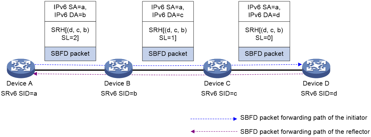

Configuring the initiator for SRv6 TE policy detection
SBFD can detect the connectivity of an SRv6 TE policy and provide millisecond-level fault detection and fast fault switchover. In an SRv6 TE policy, the candidate path with the greatest preference value acts as the primary path and that with the second greatest preference value acts as the backup path. SBFD detects both primary and backup paths and all SID lists of each path. If all the SID lists for the primary path are faulty, SBFD triggers a primary-to-back path switchover.
As shown in Figure 6, configure an SRv6 TE policy on Device A and use SBFD to detect the SRv6 TE policy. The detection process is as follows:
1. The source node (Device A, the initiator) sends SBFD control packets that encapsulate the SID lists of the primary and backup candidate paths of the SRv6 TE policy.
2. After the destination node (Device D, the reflector) receives an SBFD control packet, it checks whether the remote discriminator carried the packet is the same as the local discriminator. If they are the same, the reflector sends the response SBFD control packet to the initiator according to the IPv6 routing table. If they are different, the reflector drops the SBFD control packet.
3. If the source node receives the response SBFD control packet before the detection time expires, it considers the corresponding SID list (forwarding path) of the SRv6 TE policy available. Otherwise, the device considers the SID list faulty. If all the SID lists for the primary path are faulty, SBFD triggers a primary-to-back path switchover.
Figure 6 SRv6 TE policy association with SBFD
You can enable SBFD for all SRv6 TE policies globally in SRv6 TE view or for a specific SRv6 TE policy in SRv6 TE policy view. The policy-specific configuration takes precedence over the global configuration. An SRv6 TE policy uses the global configuration only when it has no policy-specific configuration.
When informing SBFD to establish an SBFD session, the SRv6 TE policy sends the source and destination IP addresses of the packet to SBFD. The SRv6 TE policy selects the source IP address as follows:
1. The source IP address specified by the source-address command.
2. The source IP address specified by the sbfd source-ipv6 or sbfd source-ipv4 command.
To configure SRv6 TE policy detection, make sure the reflector has a route to the source IP address of the SBFD packets sent by the initiator.
For more information about the commands configured in SRv6 view, see SRv6 TE policy commands in Segment Routing Command Reference.
